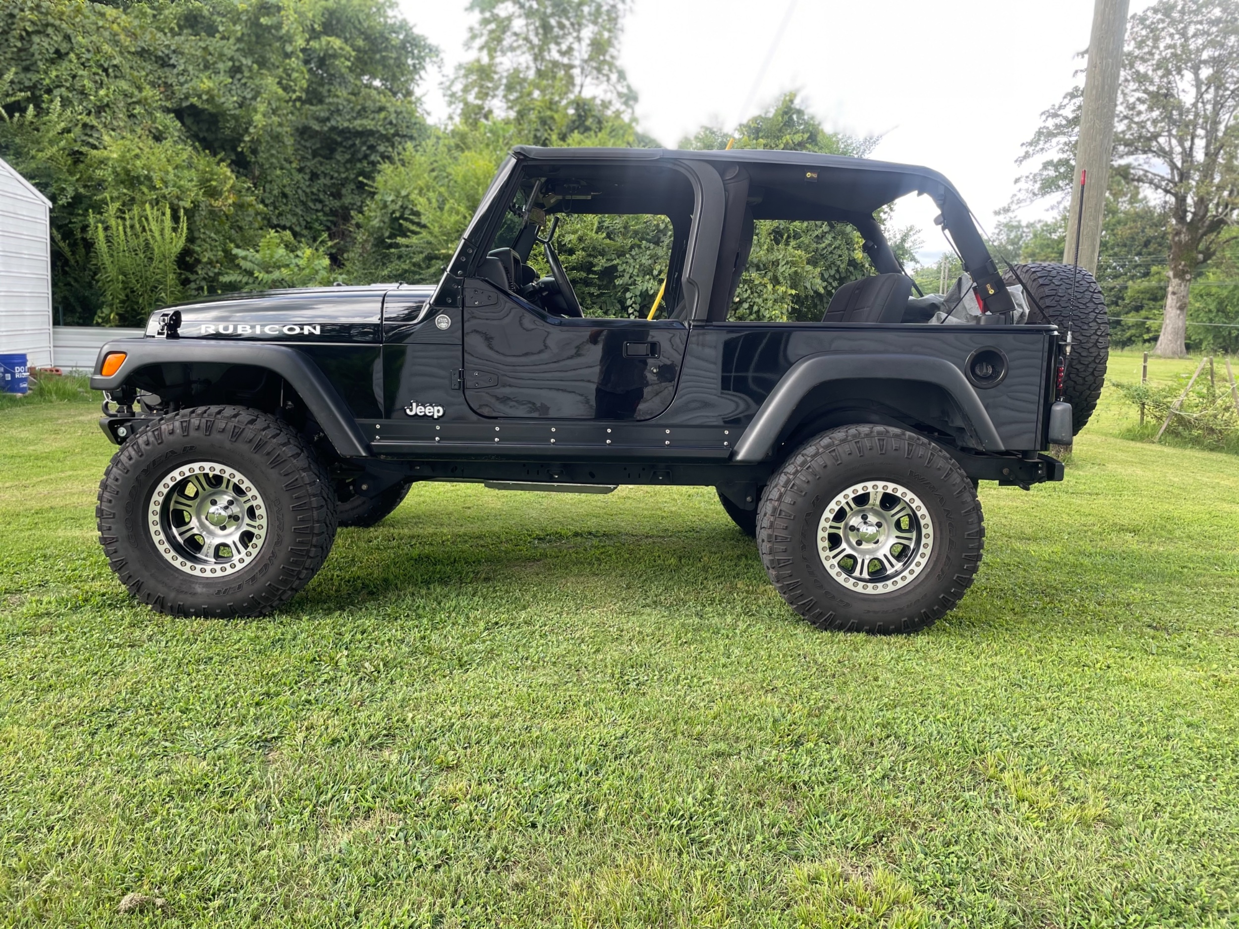

I’m showing off but this rig has 35’s ,is lifted 4” and 1.5” of body lift and can be driven 80 with one hand.
Don’t accept poor handling.

Jeep looks good. Just remember if you use boards longer than the tires diameter to set toe it decreases the longer the boards extend in from on the wheels. But you are on track with the concept.
Jeep looks good. Wish I’d got back into jeeps at 40, my children would have loved it at their ages then.
