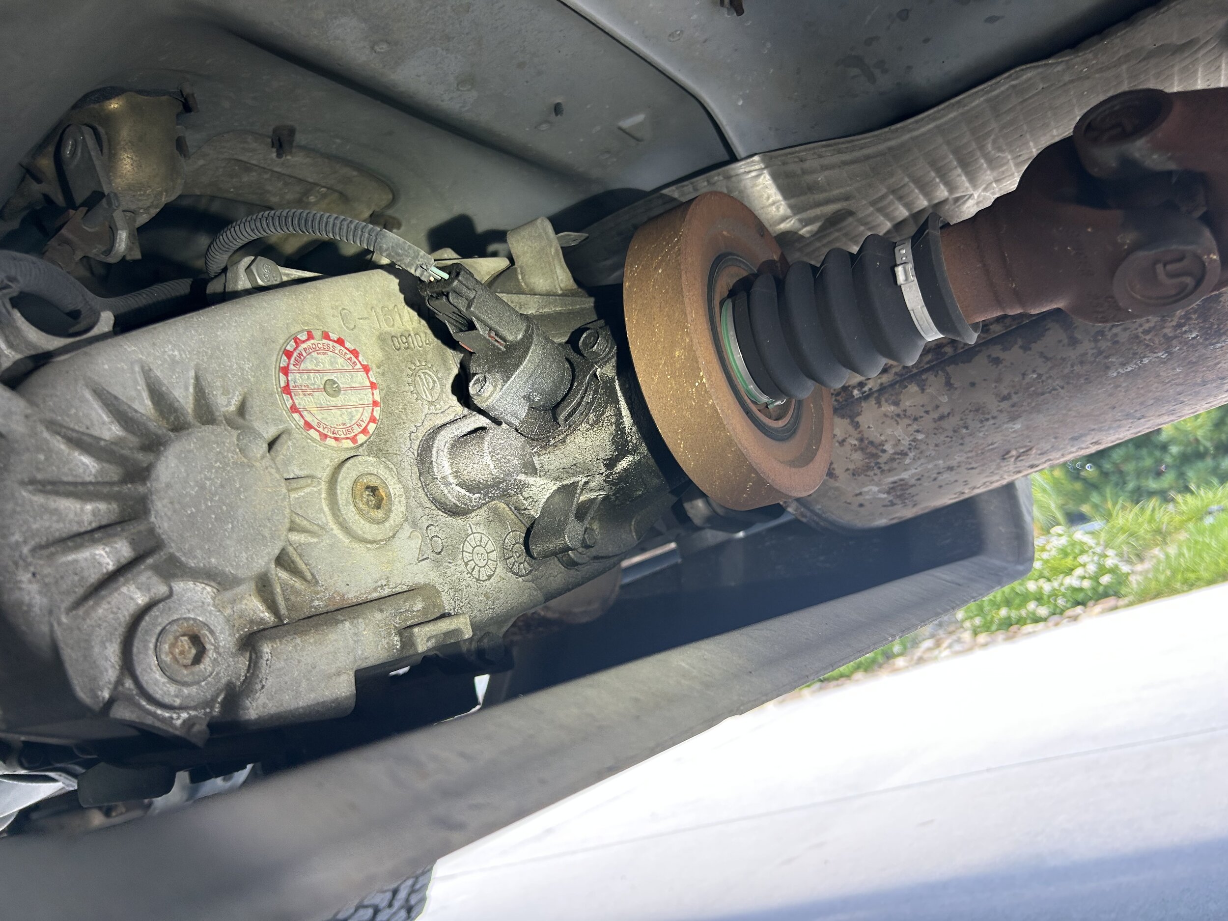

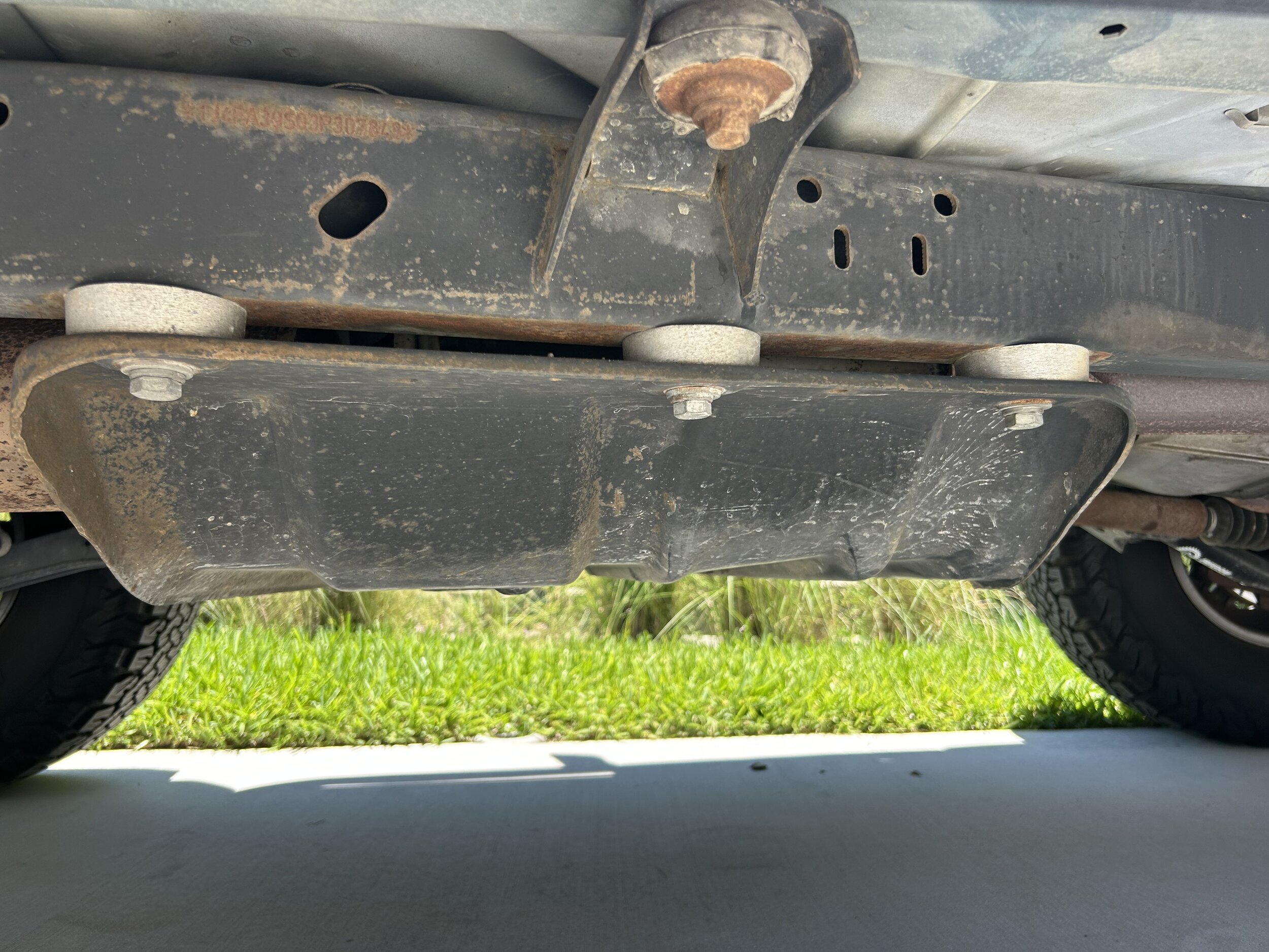

You are correct, my TC is a 231J. As the seller did not have a lot of documentation when I bought this ~6yrs ago, I am not 100% sure of the type of lift. I believe it is Old Man EMU 2.5-3.5 lift. It does have 6 disc spacers to lower the skid plate. As a novice still on Jeep, I am not sure the purpose of a slip yoke eliminator. Just looking at images of what's included, would that require replacing drive shaft(s) as well. How would I determine is this is needed... or if I already have one?? ;)
View attachment 626714View attachment 626715
Bascially it allows you to not have to drop the skid, by using a different style driveshaft & changing the pinion angle. If you don't care about clearance, I don't know that I would worry too much about it.
See that accordion boot on your driveshaft? If you had an SYE that would be a double cardan style u-joint.
