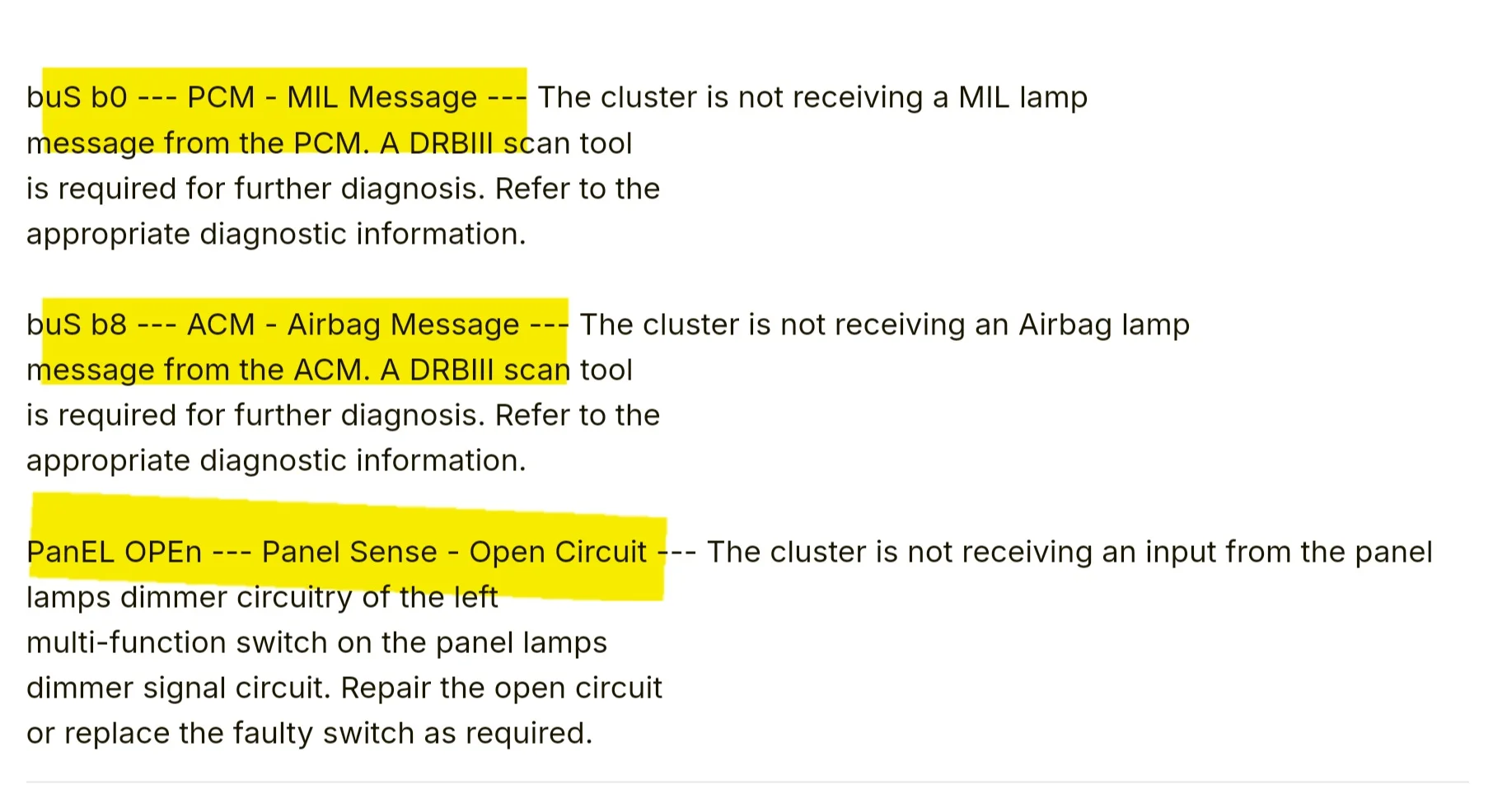

It sounds like the multifunction switch could indeed be the culprit, especially since your dimmer isn’t responding. Just to recap, if the turn signals and headlights are functioning properly, it suggests that some circuits in the switch are working, but the dimmer function may be faulty.
Here are a few steps you could take before deciding to replace the switch:
- If you haven’t already, use a multimeter to test the dimmer switch’s output when you turn it. It should provide varying voltage levels that correspond with the dim setting. If it’s not producing any voltage or consistent readings, that’s a strong indicator the switch may need replacing.
- Inspect the wiring leading to the switch for any signs of damage or wear. Sometimes, wires can short out or break internally, causing erratic behavior.
- Ensure that there aren’t any other underlying issues, such as a malfunctioning relay or a bad ground specifically for the dash lights.
- If testing confirms that the dimmer function is faulty, and there are no additional issues found, replacing the multifunction switch would be a good next step. These switches can wear out over time, and intermittent failure of certain functions is a common issue.
After replacing the switch, run the test again to see if that resolves the issue with the dash lights. Good luck, and keep us updated on what you find!
