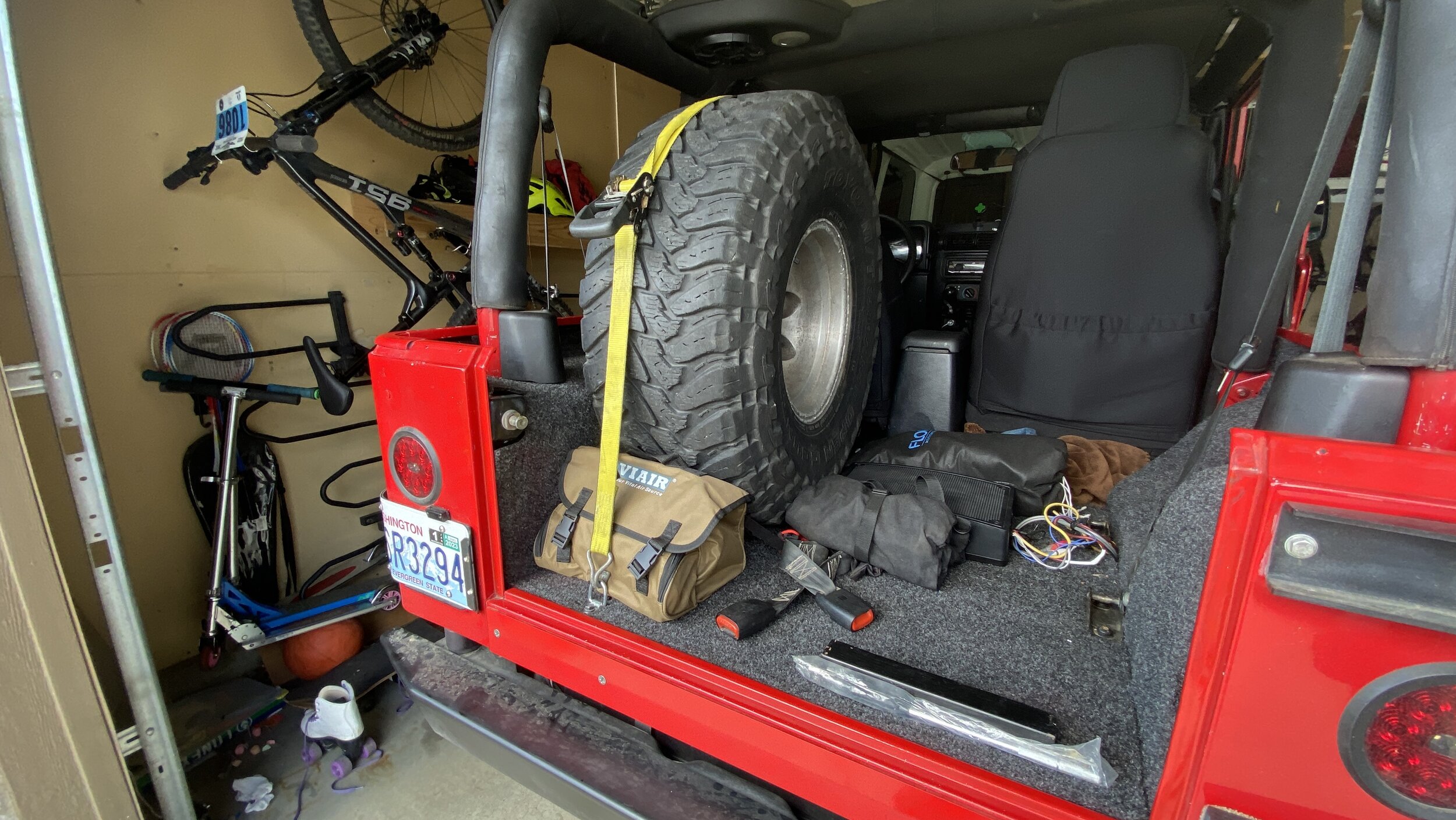

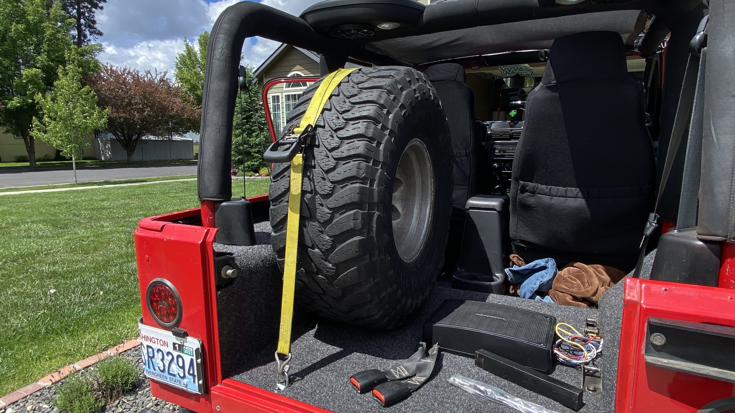

I'm relocating my spare off the tailgate to the inside of the tub. Securing it face-down onto the tub floor is simple enough with a few straps, but I want to explore some options. I like the idea of standing the tire up directly behind the driver's seat. That would be out of the way, easily accessed, and leave a lot of floor space for other cargo. I'm not aware of any spare mount brackets sold that accomplish this, but I'm not desperate enough to seek to get what I'm picturing fabricated.
Any other ways you've seen a inside spare mount done well?

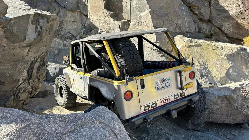

I met a gut about 3yrs ago that had his 37 spare inside behind drivers seat. The bracket tied into roll cage and also had a leg that went thru the wheel well and tied into the frame..

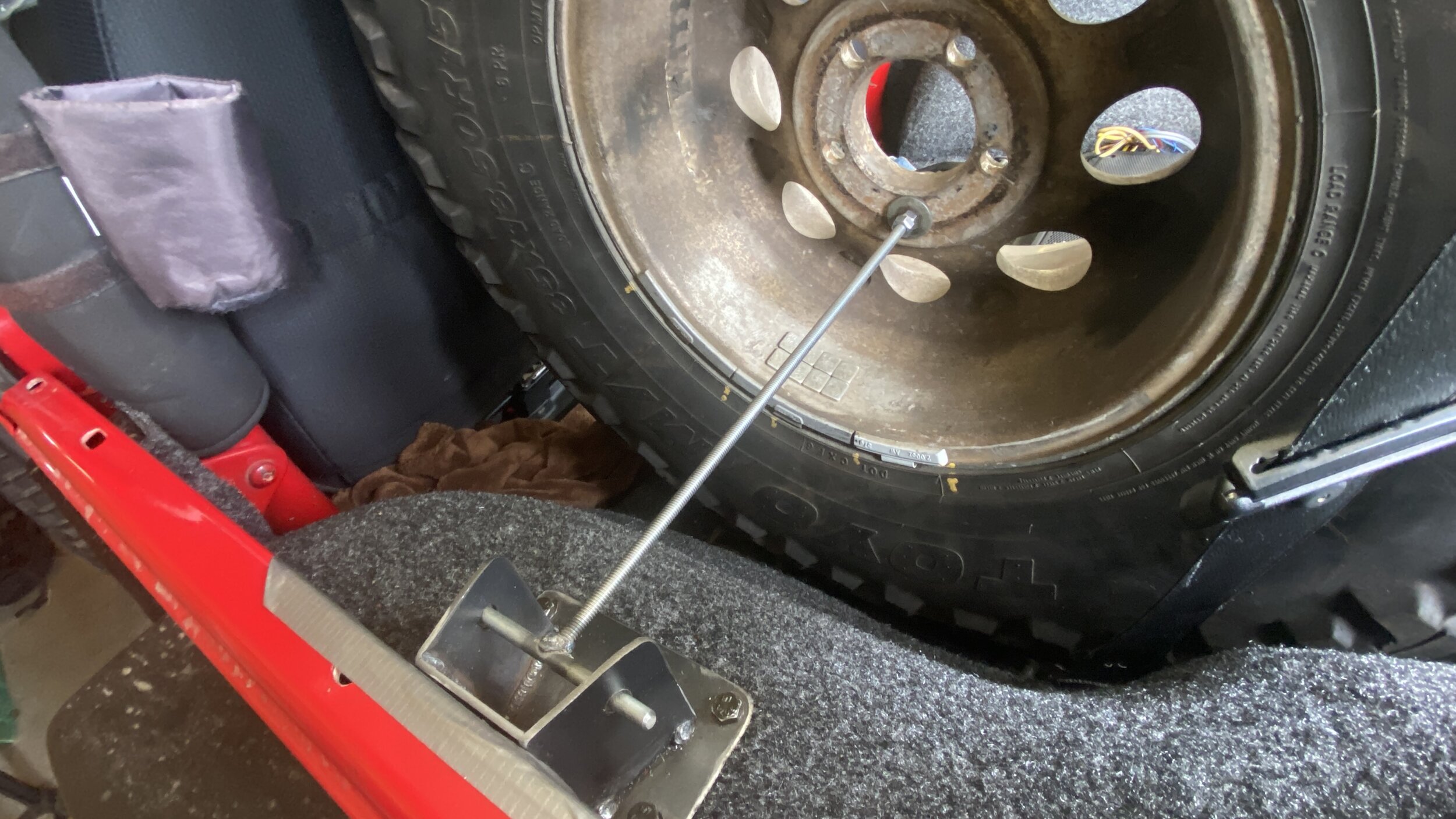

I fabbed a bracket that bolts to the fender wheel well and supports a lateral threaded rod that uses a nut through the wheel lug hole to hold it from moving left/right, and a strap over the tire to hold it from moving forward/backward.
It held no problem for about 6 hrs of wheeling, then worked its way loose. I tightened the strap and it was good to go again. I suspect a 3” strap with cletes would hold it better.
Was mounted behind drivers seat and so it did not impede visibility and still had floor space for storage.
It took 39sec to remove the tire.
