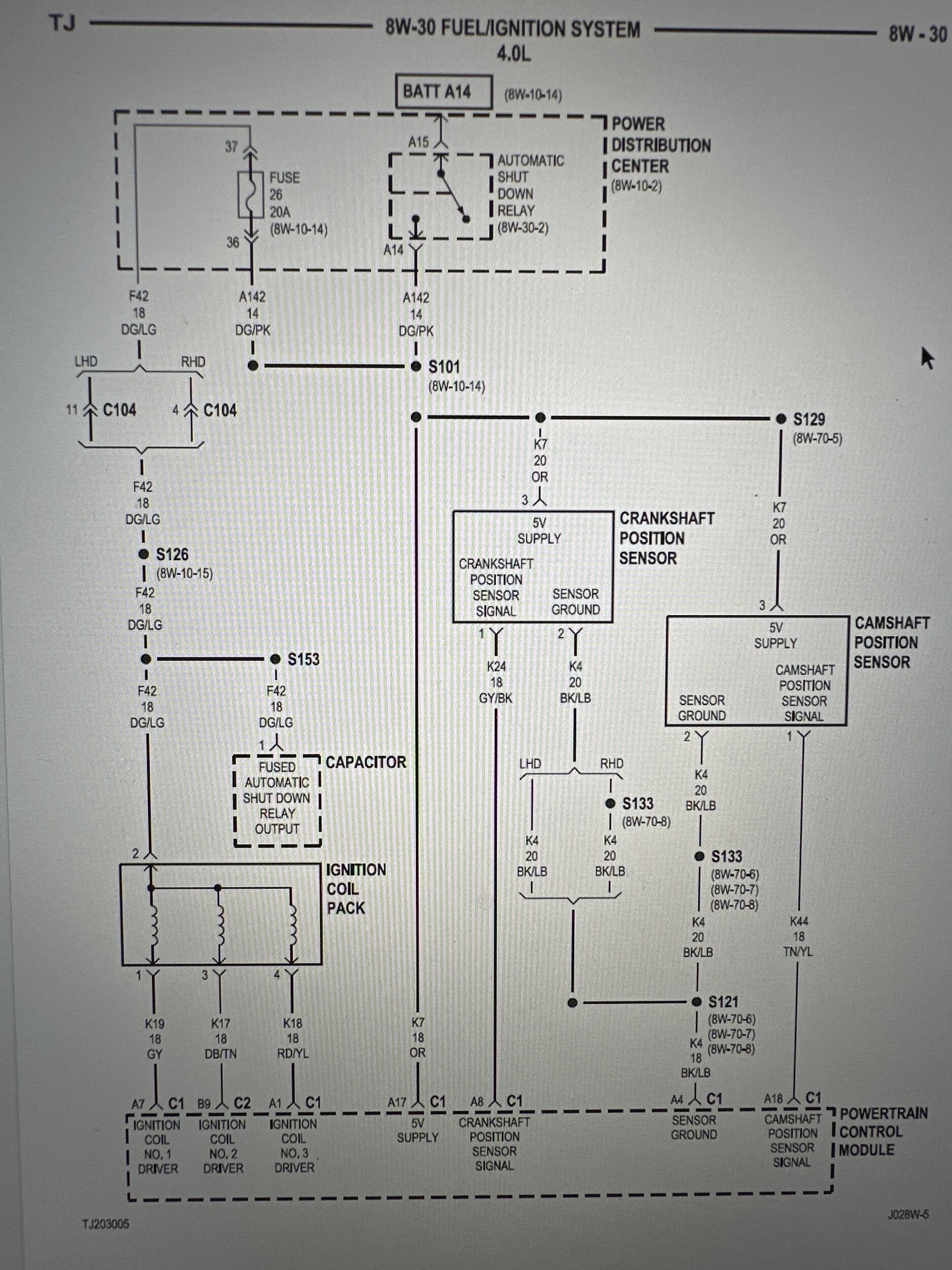

Well, for spark you need the crank sensor, the PCM and the coil.
And I always forget, I think the older TJs need the cam sensor input or no spark or possibly they don't fire the injectors.
You need to test the coil driver or drivers (based on year) for control with an incandescent test light.
Give me the details of your jeep.
Edit: found it in your profile.
With key in run position, connect incandescent test light to battery negative. Back probe coil pack pin 2 DG/LG wire with t pin. Touch t pin, test light should illuminate. Crank engine and be sure test light stays illuminated.
Switch test light to battery positive. Back probe coil driver 1 wire, pin 1 GY. Touch test light to t pin and crank. Test light should flash. Repeat test on 2 remaining coil driver wires.
