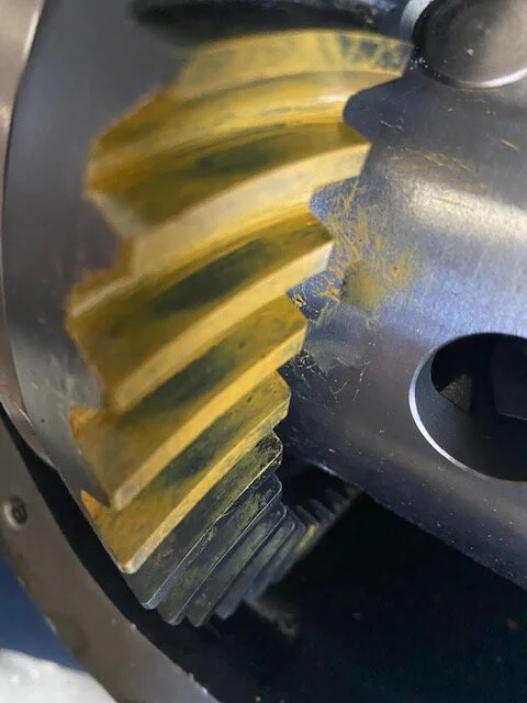

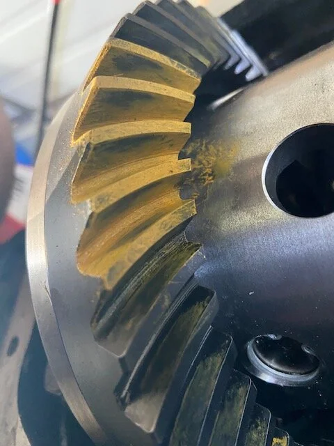

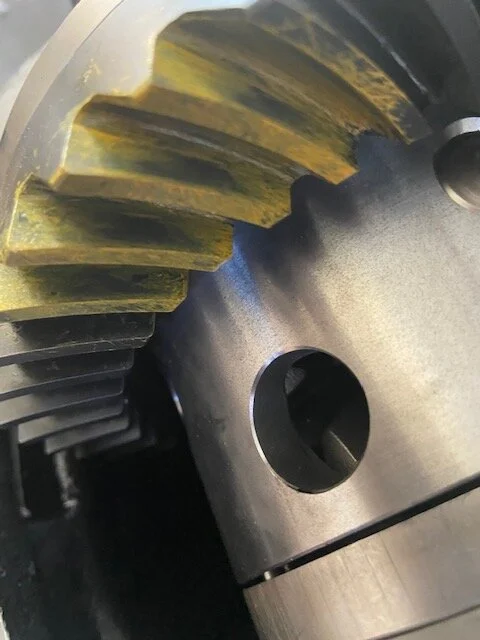

I have pinion installed and correct preload (25 in lbs).
Backlash is currently at .004".
Need some other eyes on my gear teeth pattern

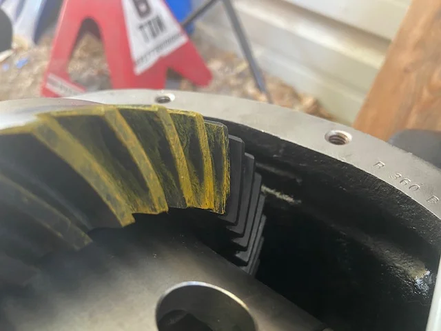

OK, I made some tweaks and have the backlash at .006"
Here is the updated tooth pattern
