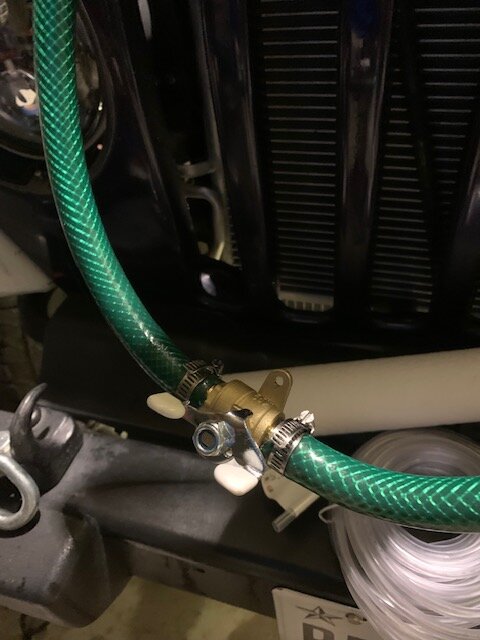

How my infusion can looks :
I took these:
- a gas can ( https://www.amazon.com/dp/B087RSN3Q4/?tag=wranglerorg-20). I bought these for 20 bucks once for hurricane Harvey, so I had spares in my garage.
- 2 pieces of 5/8 inch garden hose from the junk that i had in my garage (i think it originally was https://www.homedepot.com/p/Teknor-...ERCH=REC-_-pipsem-_-100134485-_-100661317-_-N). Had it as junk in my garage.
- 3/4 inch bard ball valve (https://www.homedepot.com/p/Apollo-...-Ball-Valve-with-Tee-Handle-EPXV34T/305469340). 12 bucks, bought from home depot.
- 1/2 in. x 2 ft. White PEX Pipe - https://www.homedepot.com/p/Apollo-1-2-in-x-2-ft-White-PEX-Pipe-APPW212/301541216. (2 bucks).
- ATF+4 from Mopar, like https://www.amazon.com/dp/B07VFJYQJ3/?tag=wranglerorg-20 and https://www.amazon.com/gp/product/B00BV4D182/?tag=wranglerorg-20
The can itself - I have a cut a hole in it's bottom, so can fill it and the air can enter when the fluid is draining. Then I removed the flow limiter (the one that needs pressure to let gas to flow out). Basically fluid can flow through the yellow pipe freely. I have added a screw in it's bottom so that i can hang it easily from the top of the trunk.
The valve enables me to control when i want the fluid to flow out of the can.
The white PEX pipe allows sticking this thing into deepstick, and sitting it inside and not moving around.
