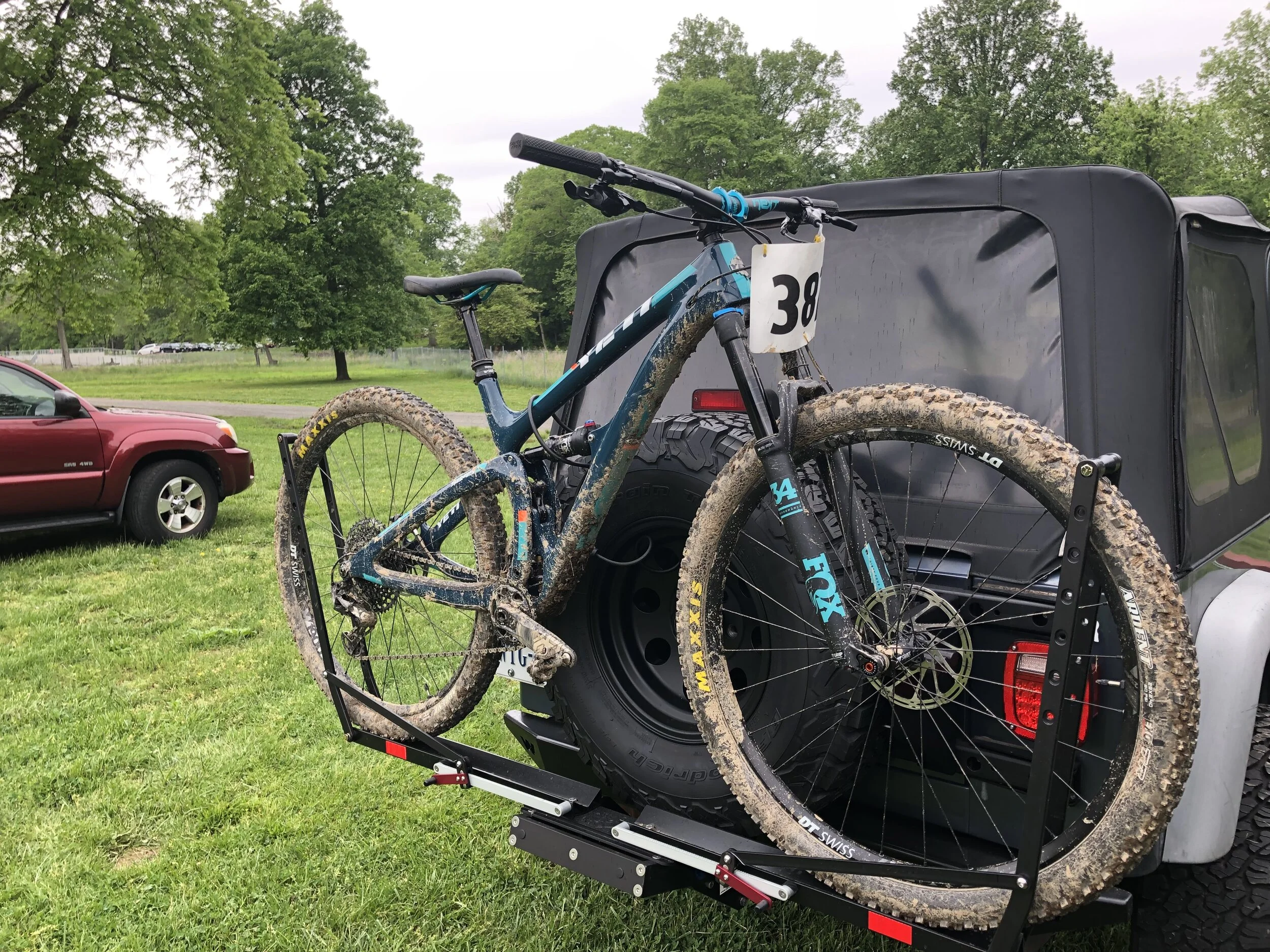

Looking for recommendations on a hitch-mounted bike rack. Should hold 1-2 bikes, preferably with some security.
The Thule T2 is a tank and folds up when not in use, but they are expensive.
The have a locking option, or you can just use a cable through the bikes.

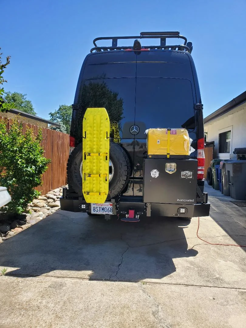

I have two 1 Up bike trays that came with my Sprinter. I removed them because they mounted to outriggers almost 5' from the ground and I knew at my age that I would never be lifting mountain bikes or an E-bike over my head.

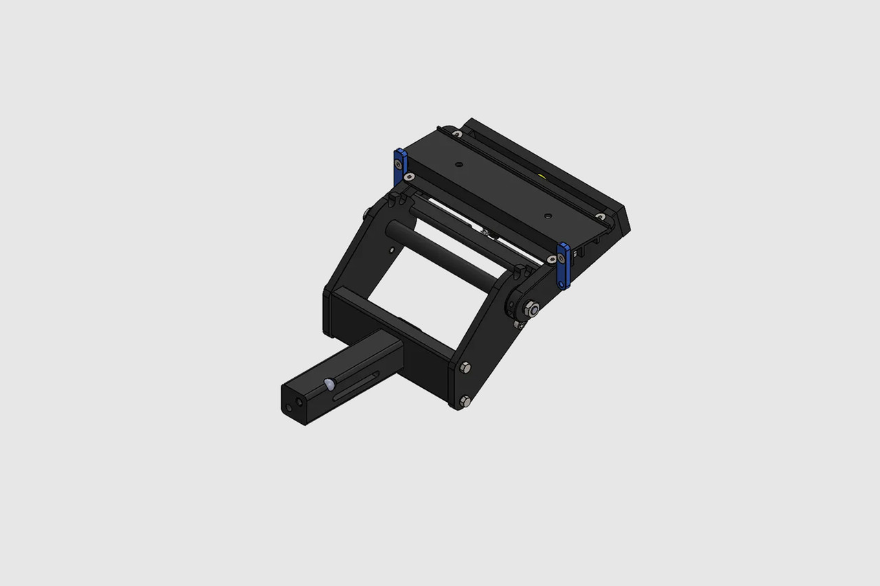

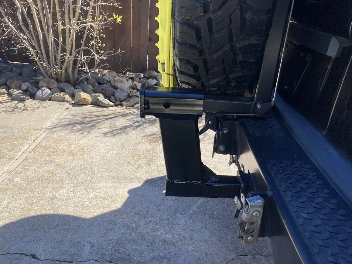

Now I am trying to figure out how to use at least one of my 1 Up trays by using a 10" hitch riser/extender with the 1 Up "2" Single Hitch Assembly (pictured below) so that the rack will clear my rear boxes.
However, 1 Up recommends against using a hitch riser/extender due to stress on the anti wobble device . Since the 1 Up representative sounded like he was reading a legal disclaimer rather than speaking from actual knowledge of what I am contemplating, I'd like to hear from those who might actually have tried it.
Before:
Now:
Roadmaster 048-10 10" hitch riser/extender in place (solid shank, 10,000# capacity, 400# tongue weight - I currently use this for flat-towing my jeep):
1 Up 2" Single Hitch Assembly:

1up mount works great, it pushes a ball outward against the inner side of the receiver so it really gets tight with no twist or wobble at all. I wouldn't hesitate to use that extender.

Another vote for the 1Up. Having had experience with Thule, Yakima, Kuat, etc., nothing compares to the quality or stability of the 1Up. I've used mine for everything from a 12 lb micro mini BMX racing bike to a 38 lb downhill MTB, and it held them all rock solid stable.

Edit: I am using my One Up
with an extender to clear the rear tire and it is perfect. No issues whatsoever and I can’t imagine it being a problem. I bought my extender from One Up but it’s just a rebranded model from someone else.
