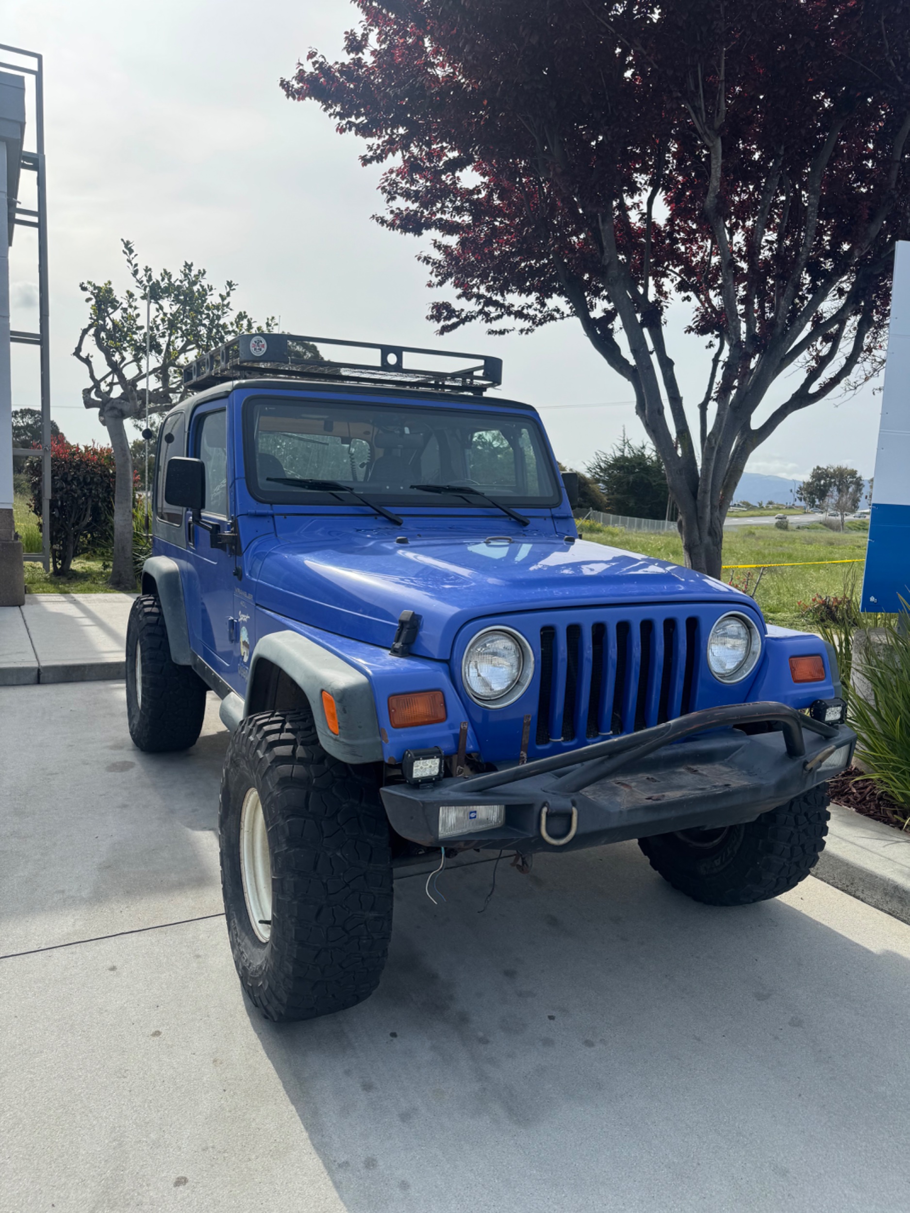

Just picked up my first Jeep—a 1997 TJ with the 4.0 and 5-speed in Lapis Blue—and I’m excited to be part of the Jeep community. I’ve got some maintenance items I want to knock out and wanted to get some input on the parts and quantities I’ll be using. I just want to cross my Ts and dot my i’s haha. Would love to hear any recommendations or experiences you guys have. Looking forward to learning and working on this TJ, and hitting some trails! Thanks to everyone!!
-oil change: 6 qts of conventional oil
-transmission fluid: 3.32 quarts(redline
mt-90 GL-4)
-f&r diffs(arb lockers) f(1.2qts) r(1.375qts): Valvoline 75w-140 syn
-tcase: 1.1qts(mopar atf +4)
-cooling system: 10.5qts(mopar 50/50)
-spark plugs: ngk 3459
-spark plug wire: standard motor products 10020
-distributor cap: mopar 56026876
-ignition coil: standard motor products UF97
