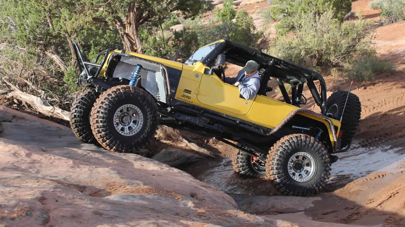

@NashvilleTJ has a built 5.7 (now 392) with a 545RFE and he's broken a Dynatrac HP60 in his rear so upgraded to a 14Bolt and broke a tooth on his pinion if I remember correctly. But he's got 40" tires & LOVES his skinny pedal....

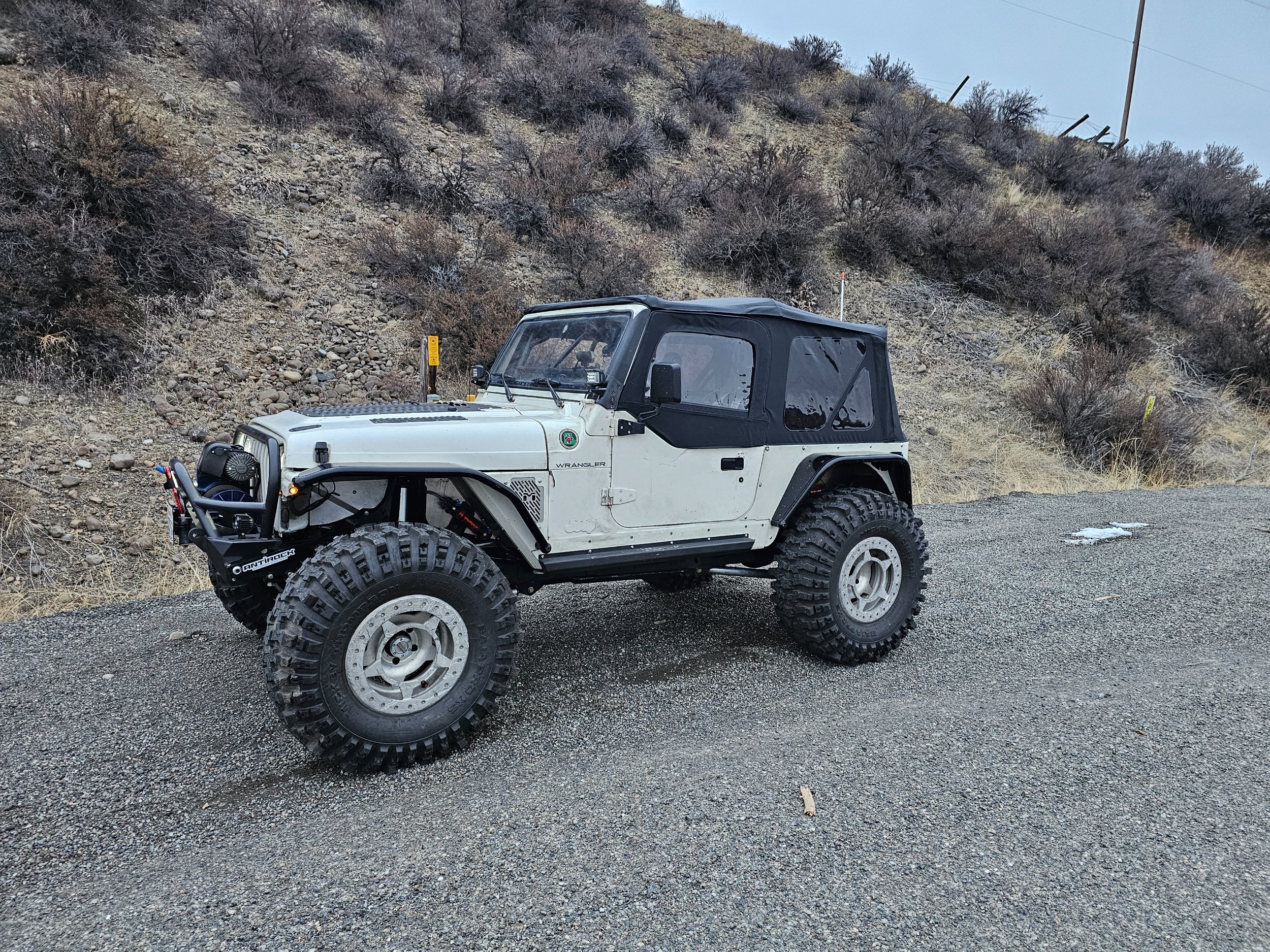

I've got a 5.7 Hemi & 545RFE & M/T Baja Pro XS 38" tires now but just got done with the build so can't say how my axles will fair yet.
As already stated your right foot & it's connection to your brain plays a part in which axles will survive.
