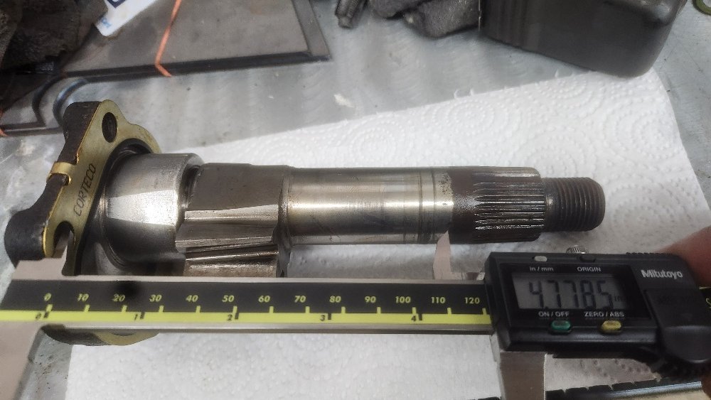

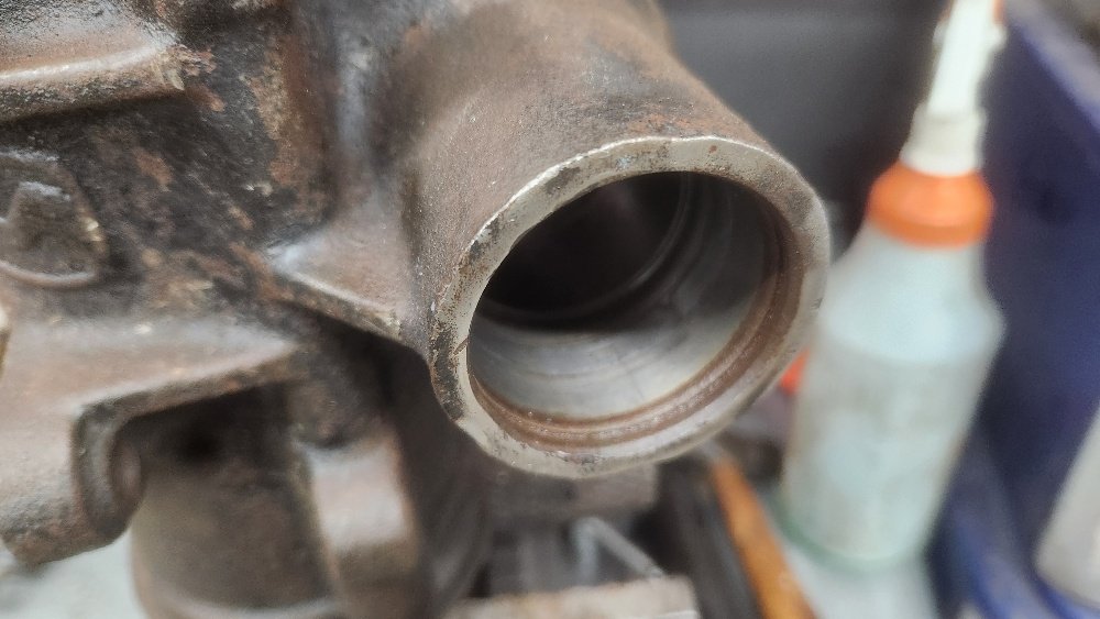

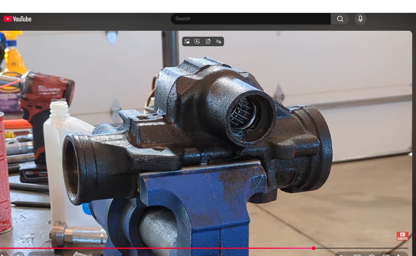

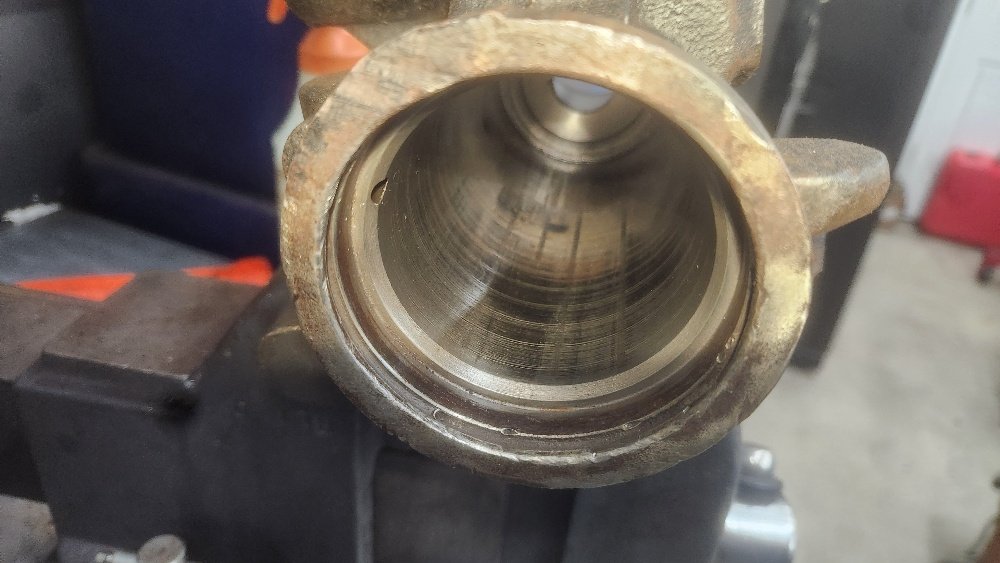

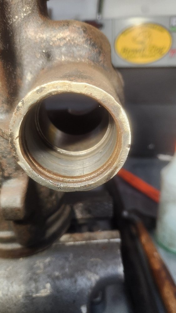

I recently tore into a Saginaw steering box pulled from a 1999. After carefully following @hosejockey61 's youtube video, it appears that my steering box has different sector shaft seals. Could anyone help identify correct seals? As you can see in the video screenshot, the snap ring is seated deeper in the sector shafts bore. With my steering box, the snap ring was very close to the end of the bore.

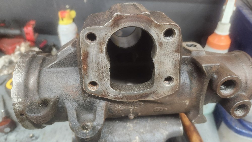

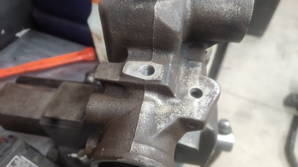

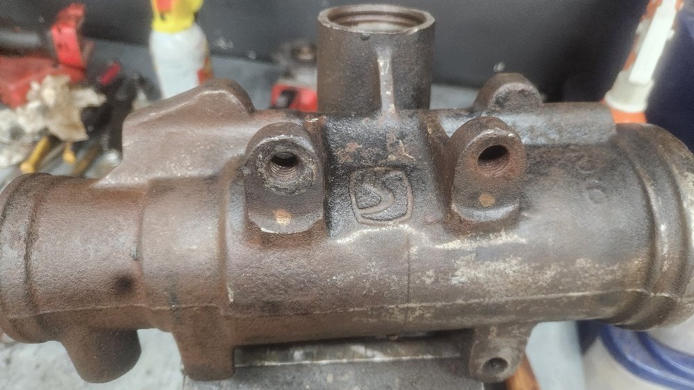

Can you take a better picture of your bore with some light on it? Take a few... One where the bearing seats and one from the backside as well. Take a pic of the entire casting as well.

I spent some time viewing other videos.. Mainly BleepinJeep's saqinaw rebuild. It seems as if the depth of the snap ring is the same.
If you speed up to 12:30, you'll see the depth.
I purchased the same kit in BleepinJeep's comments but the seals included seem to be the ones needed for a gearbox of your design.

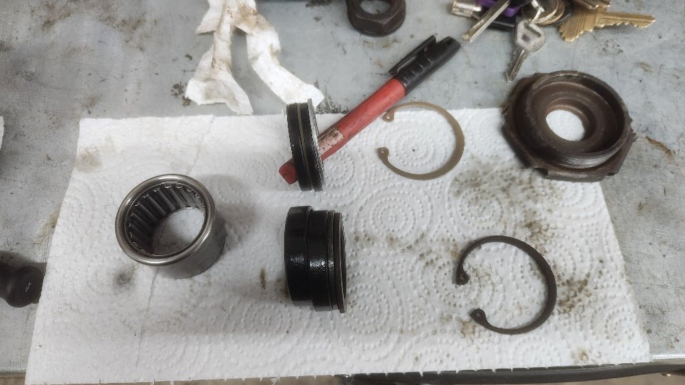

I also went back into the garage, cleaned up the two seals and low and behold, there were p/n's on them. However, both are GM p/n's and are discontinued.
5683373 (inner)
5684278 (outer)
The gearbox appears to have different castings than the one in your video, especially where the Saginaw symbol is. Visually, I cannot tell the difference with the ball bearings. I needed to use a caliper to find out that (12) are .255" and the other (12) are .260". I have suspicion that the at one point the gearbox was swapped by a previous owner.

This morning, I took a trip to my friends shop. He has a couple of XJ's in the yard. A 2000 Jeep XJ, I could tell that the Saginaw box was identical. Similar castings and I could visibily see the sector shaft snap ring close to the snout of the box. I proceeded to Autozone, O'Rielly's, and Advance Auto. Only Advance Auto was the most helpful. Using the original seal p/n's, there were some SKF cross-reference seals associated. They should be at the store tomorrow. The store manager even depicted a match with a 2000 XJ as "pitman arm kit's" so we shall see. Fingers crossed.

On a sidenote, Advance Auto Parts pulled through. National "PSK-1" is the kit needed.
