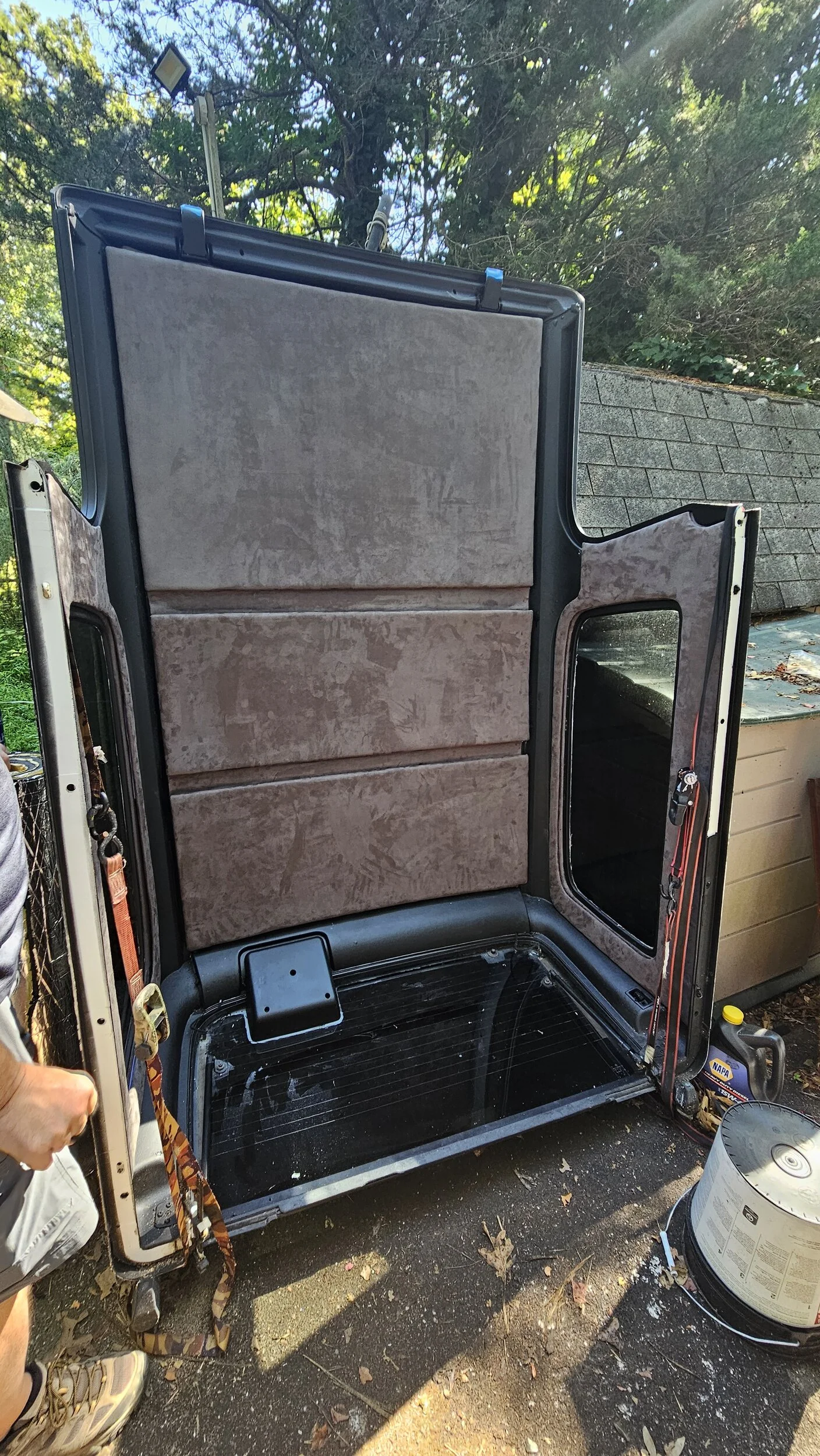

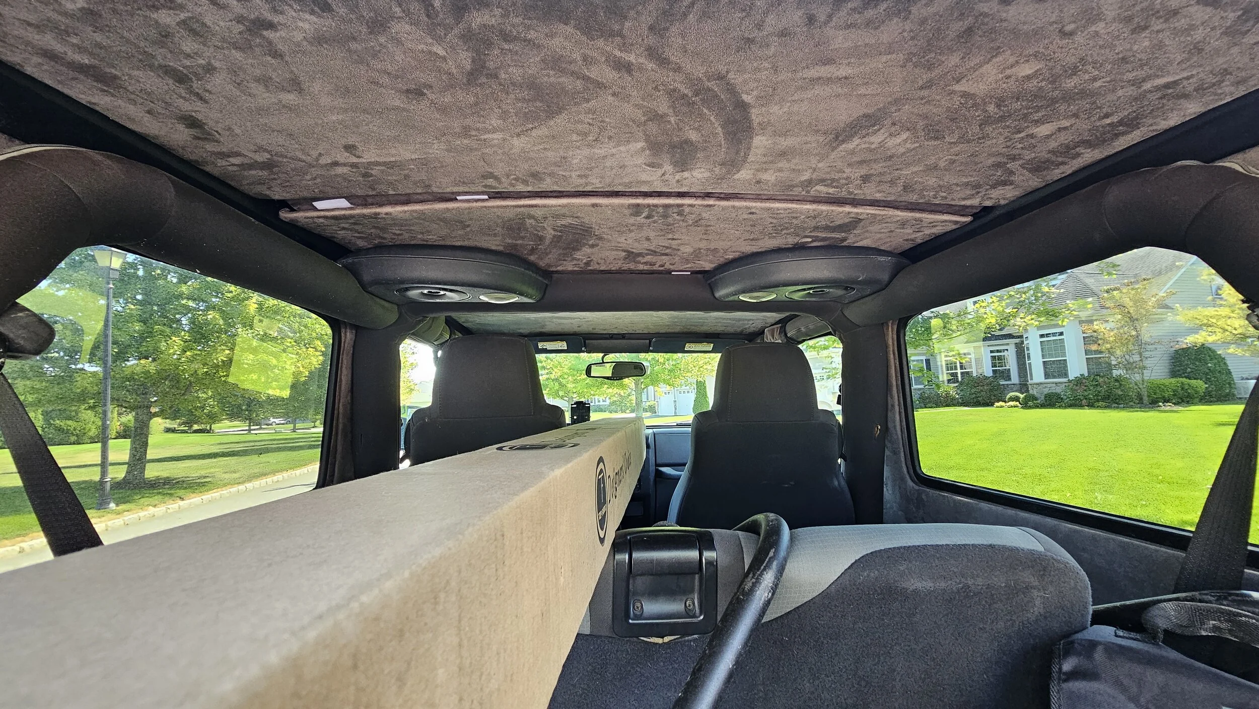

So my hardtop was the victim of a failed attempt at painting the inside, which then partially flaked off, which was then covered in a DIY upholstery attempt, which fell, almost immediately leaving glue behind, that I could not remove easily, which was then given to a backyard body guy with the instructions of: please unfuck this and paint it black. However due to a language barrier, he just scraped it down a bit and plainted it light gray, but generally speaking, it looked like shit, and it had started bubbling a bit. I then decided to cover most of that with a Hothead Headliner kit, which was quite nice. Kept temps in check, and went a long way to quieting the jeep and making it more comfortable for roadtrip use. But, the velcro didn't like sticking the shitty gray bubbling paint and I wasn't thrilled by the quality of the fabric.
So, this eventually reached a point where I decided to throw hand fulls of cash at it until it was better. What that translated to was reaching out to a guy I know who does private jet interiors and he said he'd take it on. Fixed some cracks, sanded everything down painted it all black, then he installed 3/4" closed cell foam insulation everywhere he could fit it, and reupholstered everything with a nice charcoal Alcantara. It came out incredible. I didn't think it could get much quieter than it was with the dynamat and Hothead Headliner, but it did. Ran out of velcro, so ordered more and that will be fixed next week or so.
Anyway, here it is, another stage of the interior is done. Next is the rollbar covers and the seats.
So the closed-cell foam was cut/shaped, and then covered in the charcoal Alcantara material? Or is the foam directly attached to the hard top, with this upholstery job added after that?
Closed cell foam was attached directly to the hardtop, and the headliner panels are attached to that.
As for the what is a hardtop, and why did I do this, the answer to both is pretty simple. As I have reached middle age, my tolerance for discomfort has decreased. My jeep used to rough and loud it was fun, but anytime I needed it to do real stuff it was annoying. I'd get to my destination and be tired and have a headache, so I decided a few years ago to increase comfort without decreasing capability. I put in new carpeting, but it's still removable, and there's plenty of sound insulation under there as well. And I still take it out with no roof and no doors. Just when they are on, I can hear myself think.
Thanks. What's the main material of the headliners, inside the Alcantara wrap?
It's my understanding that directly attached to the top itself is dynamat, glued to that is the foam, and then velcroed to that is the Hothead Headliner panels, which have been reupholstered in Alcantara. The velcro is failing at the moment visible in 1 of the pictures), but he had run out of time to keep it in his shop, so he will be redoing the velcro in my driveway next week.

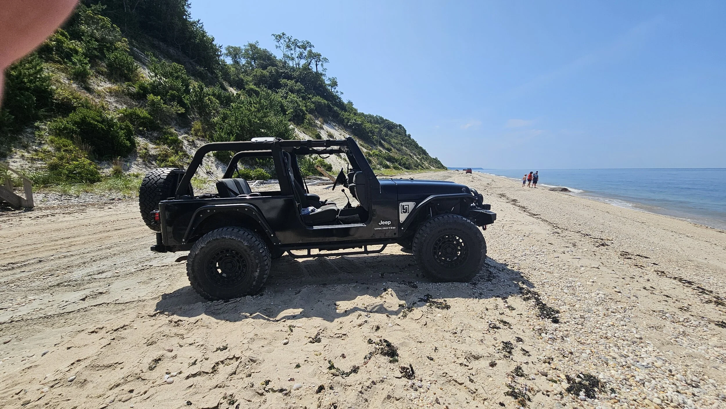

Looks nice, I installed Hotheads too and it was a big improvement both on noise level and acoustics. What beach is that?

It's beach on the North Fork of Long Island, NY.
