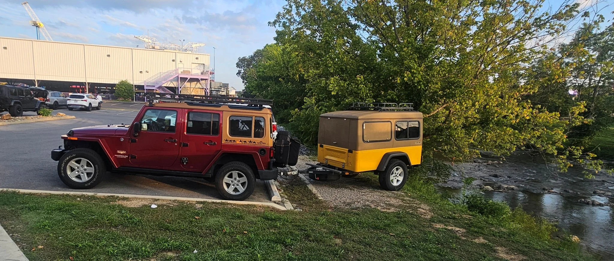

BTW I'm writing this from a hotel in Pigeon Forge, TN, I'm helping Overland Outfitters with the Smoky Mountain Jeep Invasion. Anyone here going? Their booth will be inside the convention center, stop by and say hi. You'll probably find me at their booth, which you can recognize because they'll be using my JKU and trailer in the booth.
The hotel I'm staying at doesn't like trailers, last year they told me I would have to find somewhere else to park for the night before load-in day at the show, so I promised them I would fit the Jeep and the trailer into one spot. I did the same this year, I backed the trailer over the barrier at the back of a spot and onto the river bank. One spot. Done. Parked in the same single spot last night :).
Hey, I designed it to be an offroad camp trailer, so why not take advantage of that.
