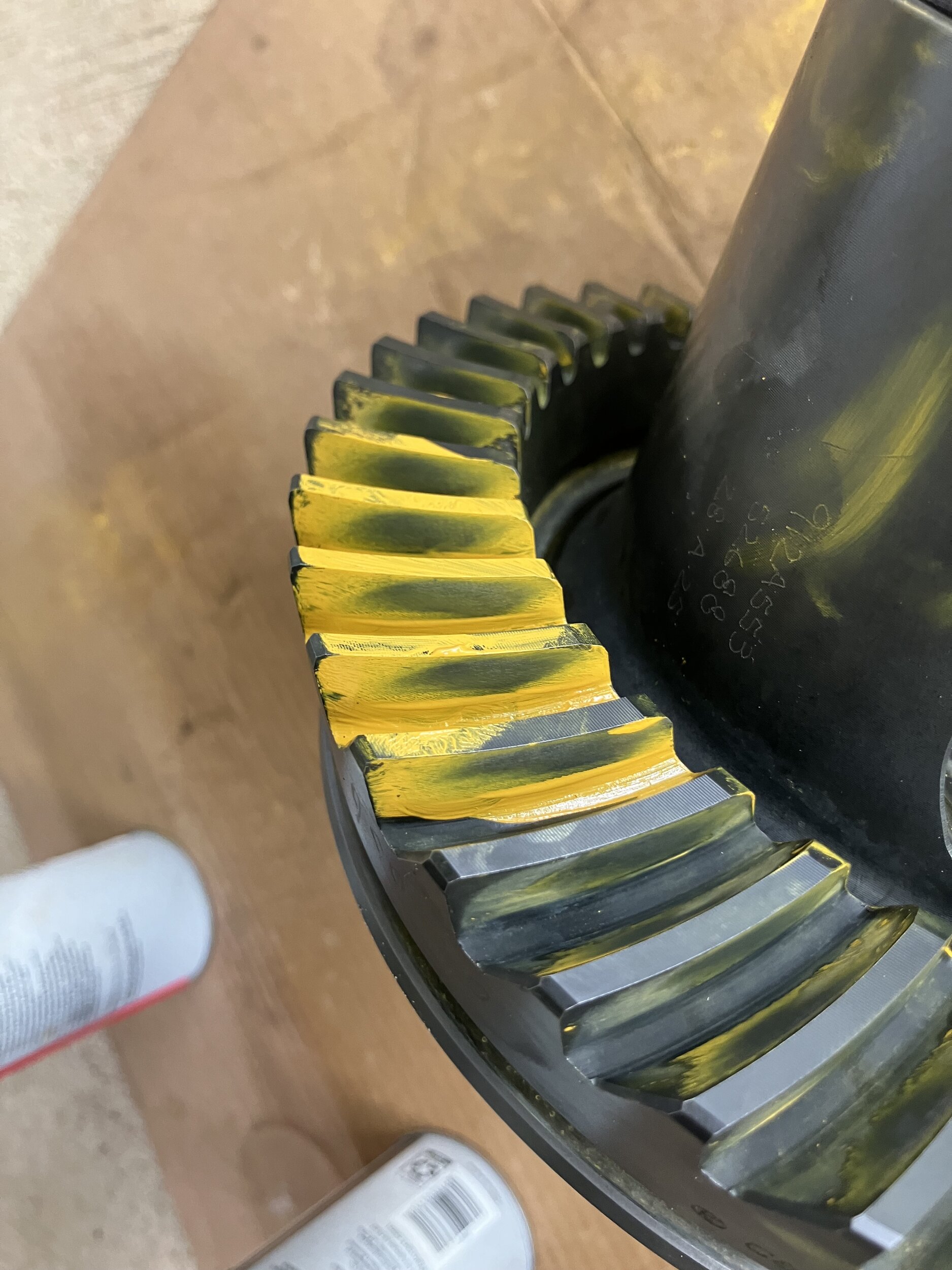

J Jzeus New Member Original poster Joined May 26, 2025 Messages 17 Location Arkansas Jun 9, 2025 #21 Called Eaton, they said just grind down the spacer .020 or so. Just to where it’ll drop in without forcing it.
M machoheadgames LED turn signal club Supporting Member Joined Jan 21, 2021 Messages 2,638 Location Dallas, TX Jun 9, 2025 #22 Jzeus said: Called Eaton, they said just grind down the spacer .020 or so. Just to where it’ll drop in without forcing it. Click to expand... What is the thickness of the spacer currently?
J Jzeus New Member Original poster Joined May 26, 2025 Messages 17 Location Arkansas Jun 10, 2025 #23 It was .810 . Took it down to .803. Just enough for it to fall into place without forcing it and fall out when I spin the carrier.
