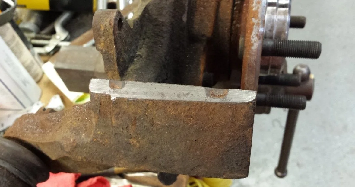

About the only thing left is something with the knuckle where the pads ride. The front brake calipers are fed from the same fluid circuit even though there are 2 lines. They are common to each other at the combination valve which is a T for the front lines. The only way to get one side to have a problem in this case since everything has been replaced is to isolate it below the frame which points to a problem with the knuckle.

How does or would that cause the intermittent nature of his issue? The only thing a different casting might do is cause a seal issue and a seal issue is not likely to be intermittent. I don't know how divots in the sliders can cause it but there isn't a lot left if all the brake parts have been replaced.
Stuck guide sleeves, but they'll do it all the time. Hydraulics don't stick one side so that rules out the booster, master, combo valve, hard lines and flex hoses.
Process of elimination points to other than brake system parts.

regarding the —--below the frame - knuckle area ——- what do i have to look for?
Not a TJ image, but something like this.
