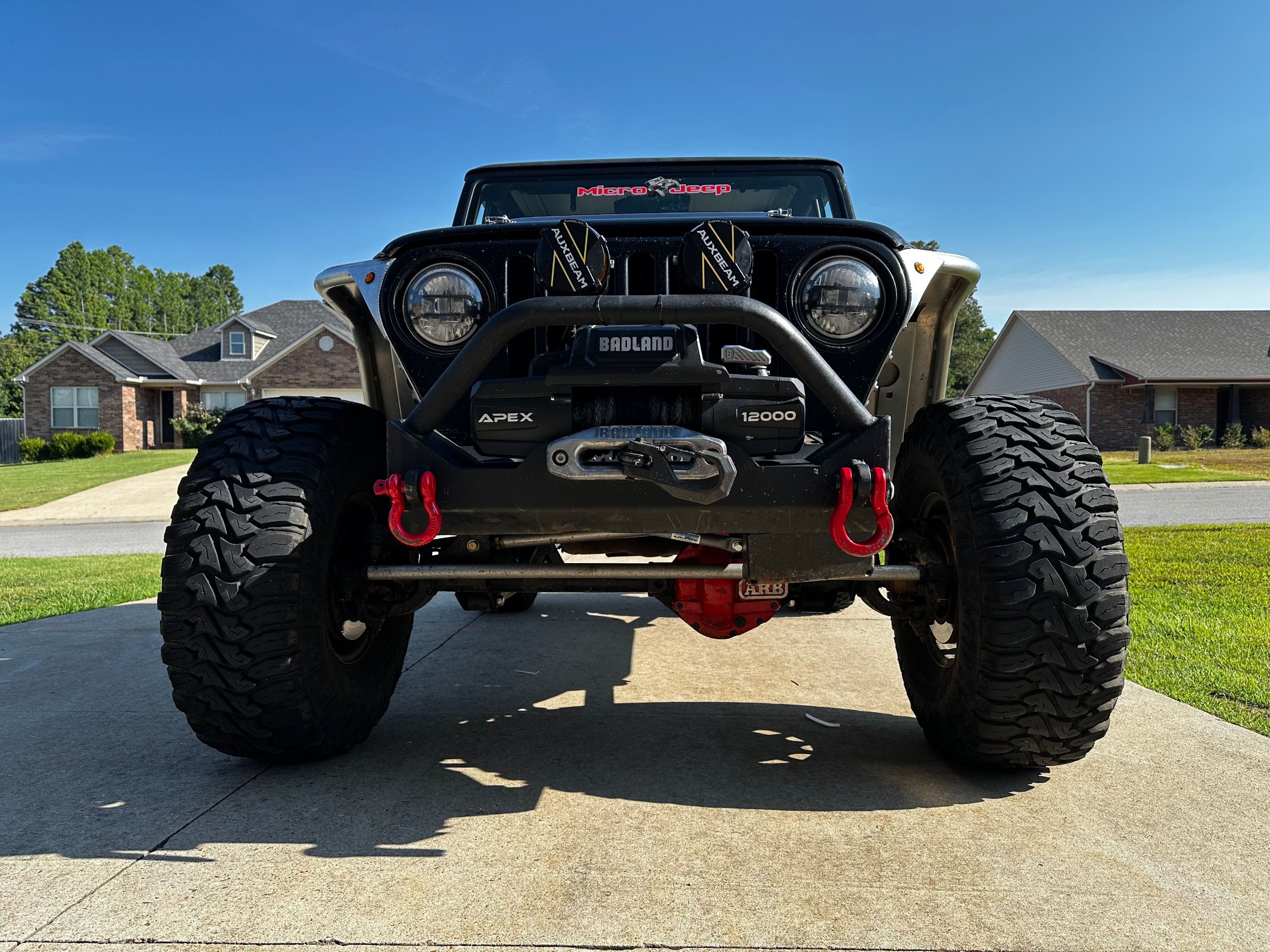

I've heard this is common... but not convinced. I have an Adams, I'm only on 2-1/2 inch OME coils, 1" motor and body lift, flat belly tummy tuck.
I have a very slight 3 second low to high to low drive line vibration... 3 seconds on... 3 seconds off... but just around 64 to 70 mph.
I drive my TJ across country to wheeling events and I'll even disconnect the front driveline due to the pulsing vibration.
Note: I'm in the beginning stage of a JL axle swap and have decided to keep the FAD due to the already less than desirable caster angles for the M210.
My point to this post is just wondering how common the front driveline vibration is for TJ's?
