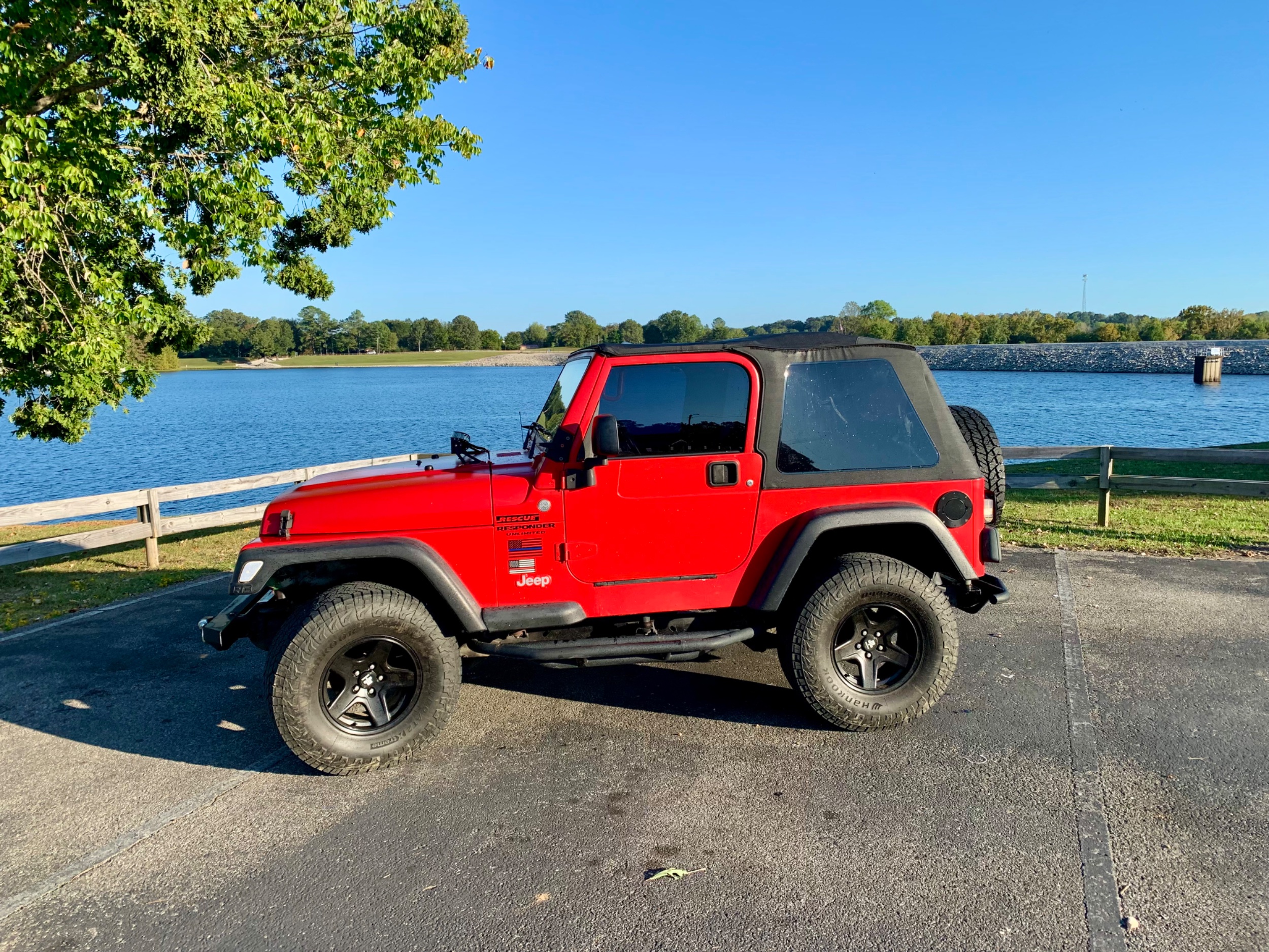

Installed a new hd bumper with winch and now the front bounces , steering wheel doesn’t shake , Luke it starts hopping after I get over 45-50 mph

It’s stock height with Monroe shocks

I run 30lbs psi on tires . Tires have less than 500 miles on them and rims are new also withbless than 500 miles
Shock is blown. Shocks control bounce. Springs are fine. That’s what they do: bounce.
