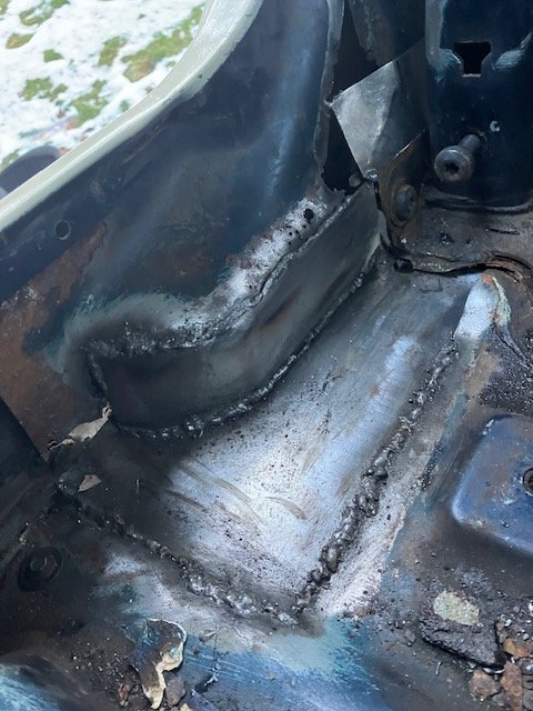

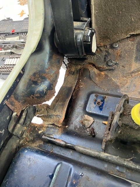

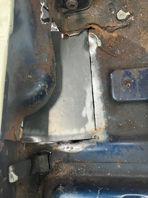

First, after I bought my first TJ I drove it home and parked it in order to get it ready to pass inspection. The biggest concern was the rot in the passenger corner of the cab. It was rusted through so I bought some 16ga steel and shaped it the best I could and welded in place.
I ended up just patching it the best I could to get it inspected and plan on replacing the floor pan down the road. Yes, I understand the roll cage is attached to rusty swiss cheese.

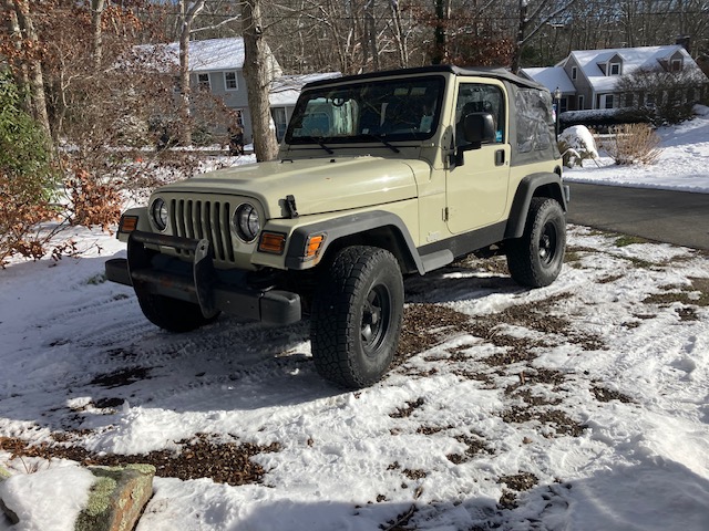

Here are some photos of the day I bought it. It was 17 degrees out so it was a good test of cold start up and heat function (more on that later)
