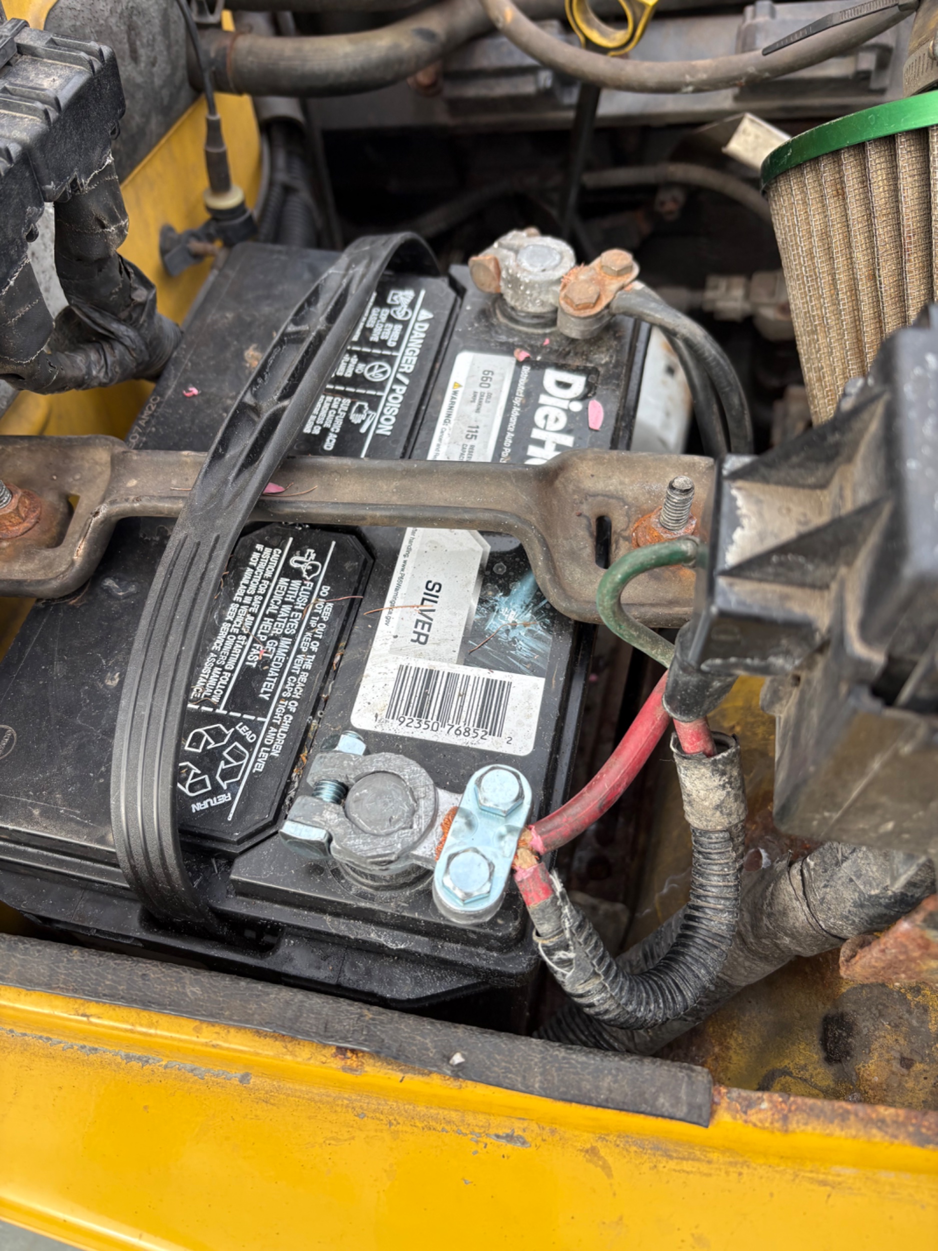

‘02 TJ. Cheap winter ride. Lots of rust. Was running great, new battery and starter. No issues since. Suddenly went to start and the gauges are jumping up and down but the dash is black and no response to the key but the gauges move differently when turning the key.
I didn’t do anything but hook up jumper cables it started right up.
Trouble idling like the battery was drained but after a minute it idled fine.
Shut it off to test and same result.
Jump it , move it in front of garage, shut off, same issue.

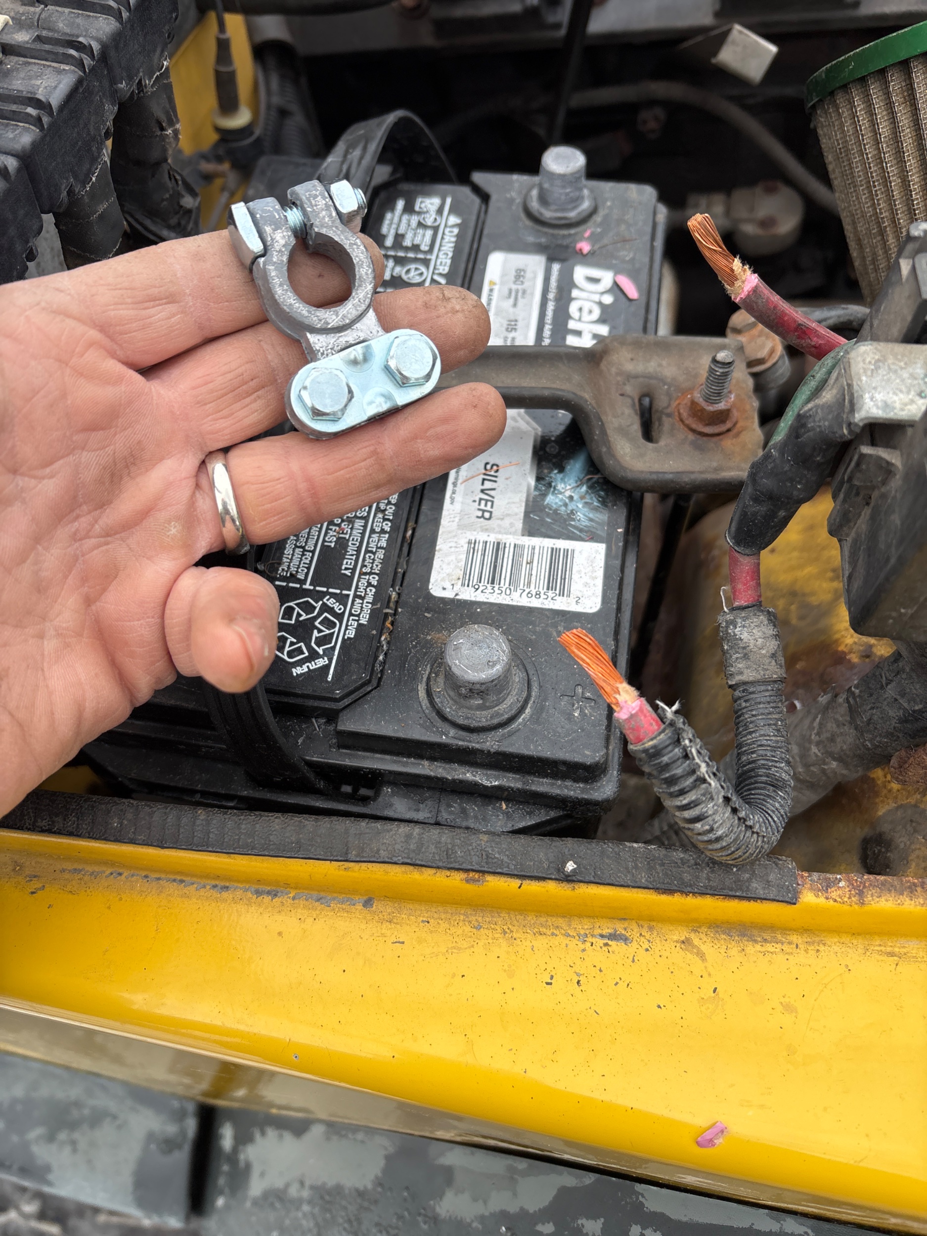

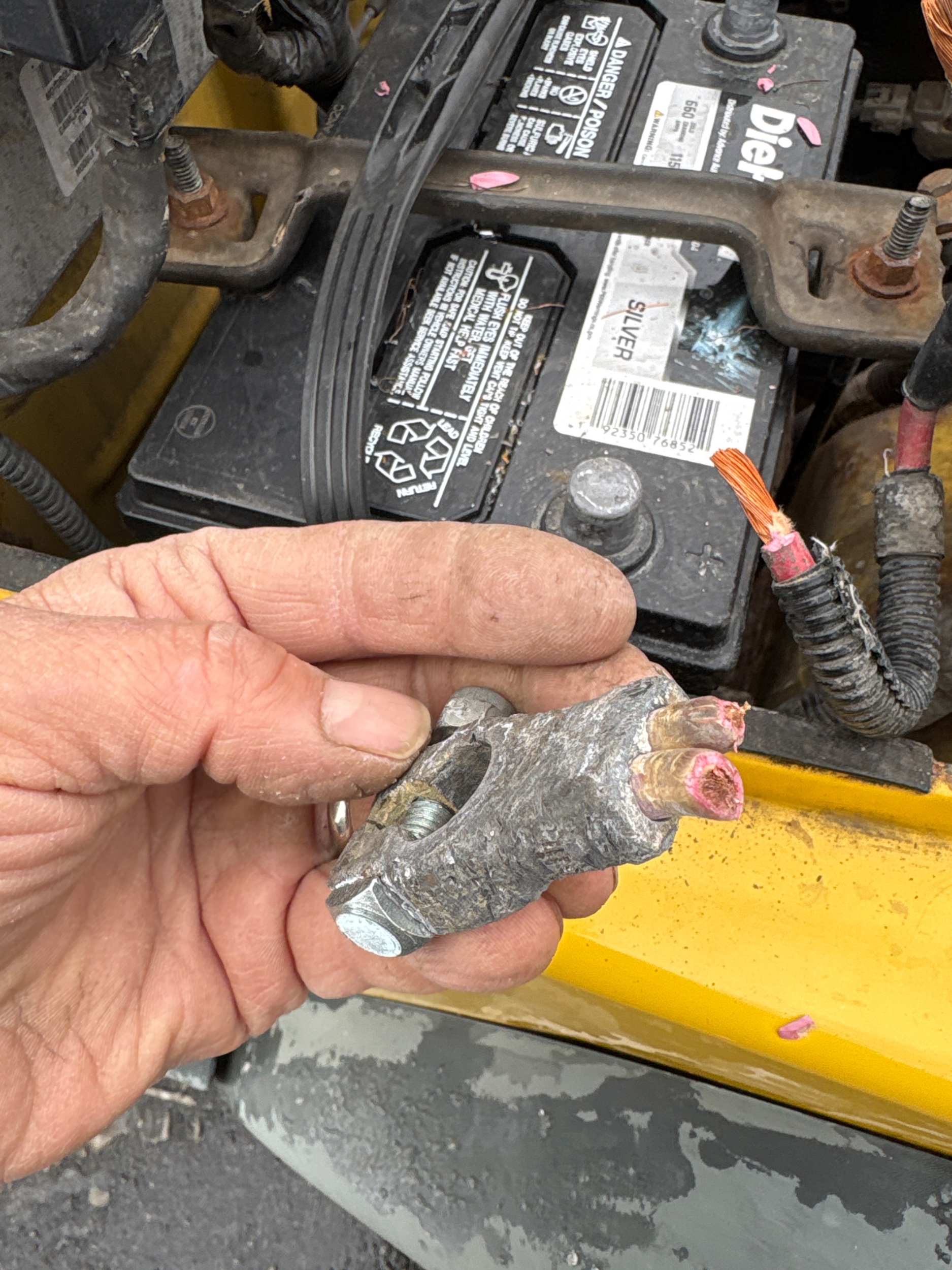

Cheap replacement battery terminal i cleaned up and reinstalled no fix.
Tippy tap on the positive battery terminal and she came back to life.
Test drive times two and all is good, for now.
Tomorrow morning I’ll try a cheap battery terminal on the positive side of the battery.

@macleanflood if I have a bad ground or positive connection why did it fire right up when jump started? Cheap terminal being installed.
This old one doesn’t look suspicious.
Just saying that might be the next problem and if you're in there doing terminals you might as well check grounds. That and gauge problems are usually ground issues.
-Mac

Makes sense. Certainly does. New battery terminals installed will order the military style ones and fix it up if the issue disappears. I’m hesitant to mess with the body ground it doesn’t wanna loosen feels it may break.
Tomorrow I’ll pick up new crimp on terminals and maybe build an additional body ground.
I’m gonna cross my fingers and see what happens.
