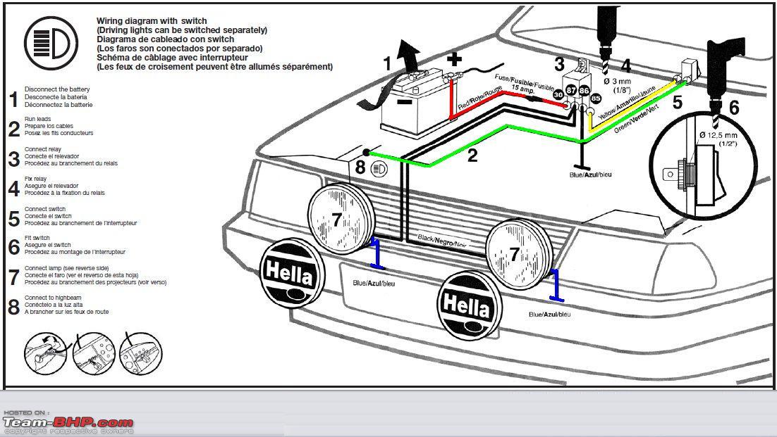

Shortly after purchasing my '01 TJ I did the same research you did.
For my installation; I wired the 12V positive wire to the battery terminal since I didn't have an after market fuse block installed.
I wired in the relay trigger wire to a factory fog light switch that I had left over from my XJ (Yes they fit in the 3 switch bezel).
Not knowing what wattage bulbs are in your fog lights; the battery would be the better source unless there is an after market fuse block installed in the engine compartment.
I plugged my Hella lights directly into the headlight bulb itself, instead of using a separate switch. Simple 10 minute job and you can choose for them to come on with high beams (illegal in Va) or low beams.

Oh I definitely want them to come on with high-beams :cool: ...

Simple 10 minute job and you can choose for them to come on with high beams (Illegal in Va) or low beams.
p.s. I chose the "illegal" version for my needs.
I did mine the same way... living out in the country I want them to come on with high beams to help spot deer or trees blown onto the road. it saved my ass once as I came flying around a corner at night and there was a tree lying across the road, would of never seen it in time if it wasn't for my LED lightbar !!!!
