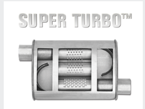

Went with the Dynomax part number 17749 with the full offset to take best advantage of the original flow director design. If you keeping the cat on - recommend you stay with the center inlet part number. What I like is that it does not neck down internally and runs two 180 degree turns to maximize its time in the muffler.

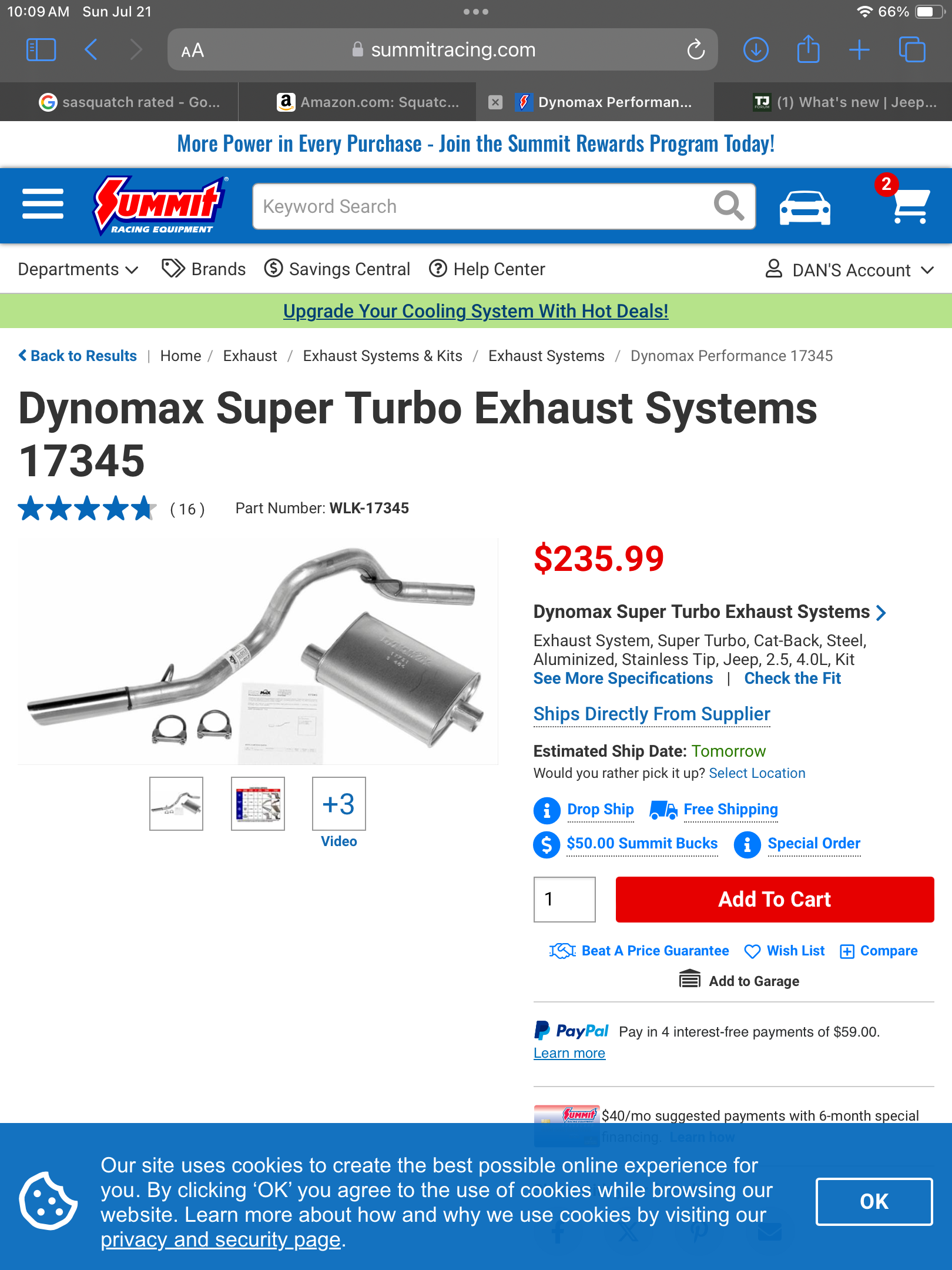

just adding this note- this 17345 kit uses a smaller case muffler so it will be little louder and I also retained the stock tailpipe for the moment since this was a garage hack.

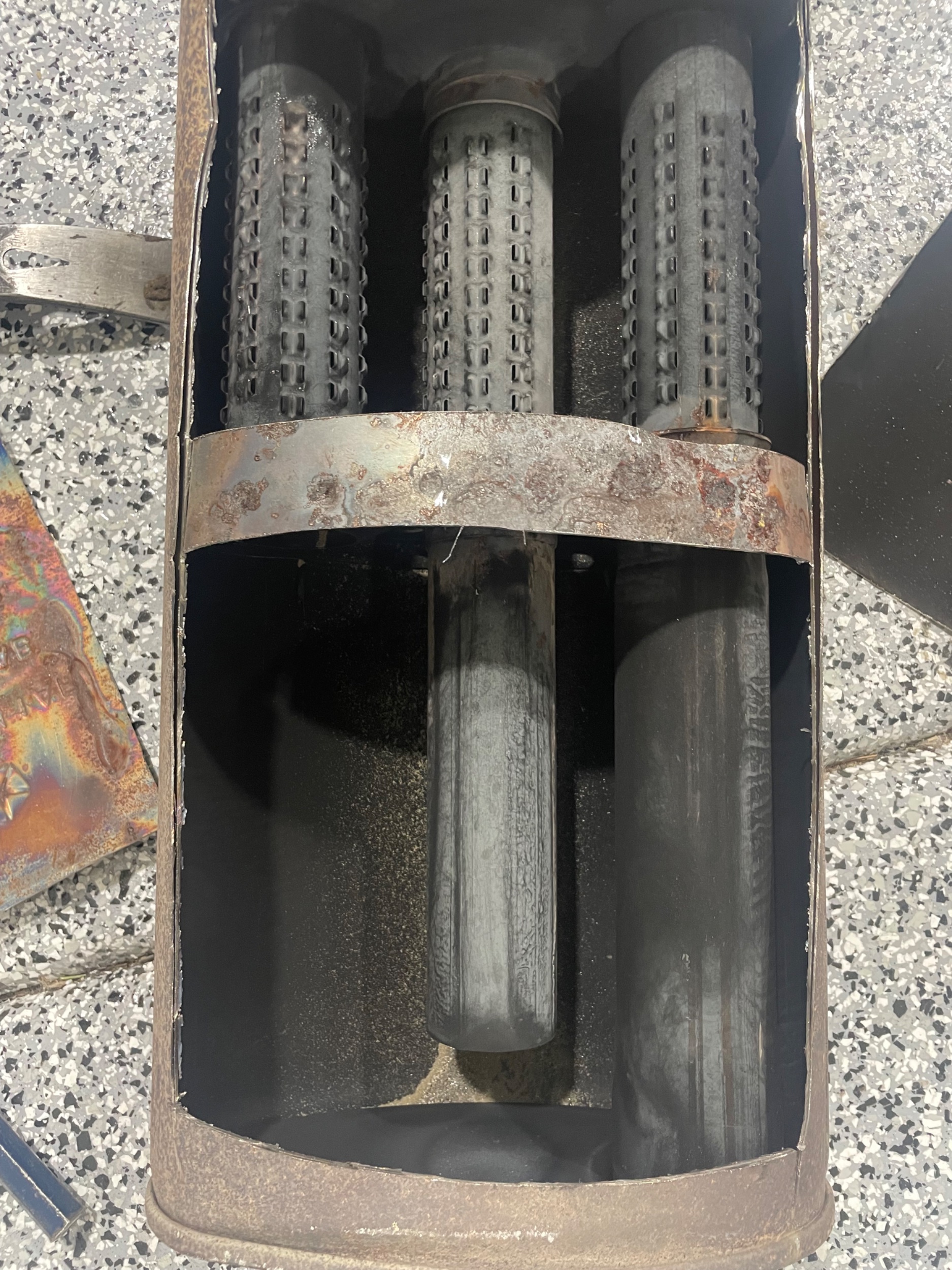

Here is what the OEM looks like inside for reference to the walker:
Great, thank you for your nice and helpful answers ... that's right, the OEM muffler from my Jeep looks exactly the same ... the Walker 21337 is really almost like the original compared to the Dynomax which has no separate chambers and an S-shaped pipe.
