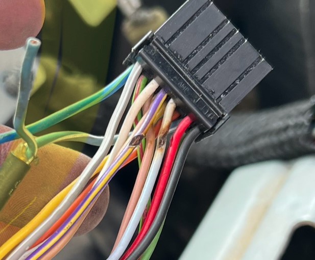

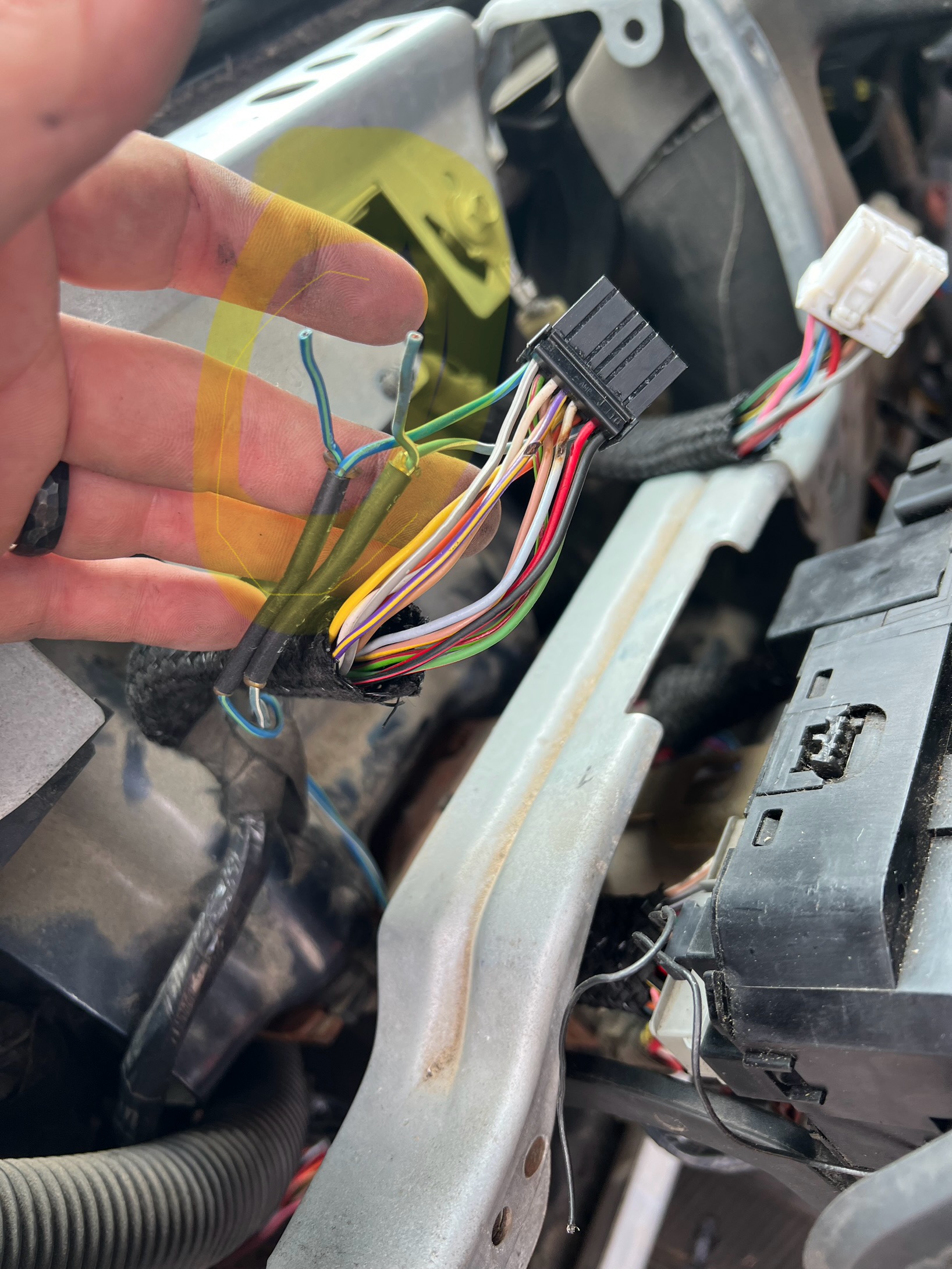

There’s lots of plugs inside the cab, and under the hood that are plugged into nothing. Someone cut out the air condition compressor and removed the a/c relay, the lightbulb at passenger feet is missing, and there’s a broken wire on the turn signal switch that controls the dimmer. I will replace this when the switch comes in. There also is a blue/white wire that I have traced from behind the cluster that leads to nowhere and I can’t figure out where it goes. (I can’t find a diagram of the wires. I’ll try to attach a photo of the wire. The blue white wire is paired with a blue/green that goes to the window defrost but do not see where the blue white goes.

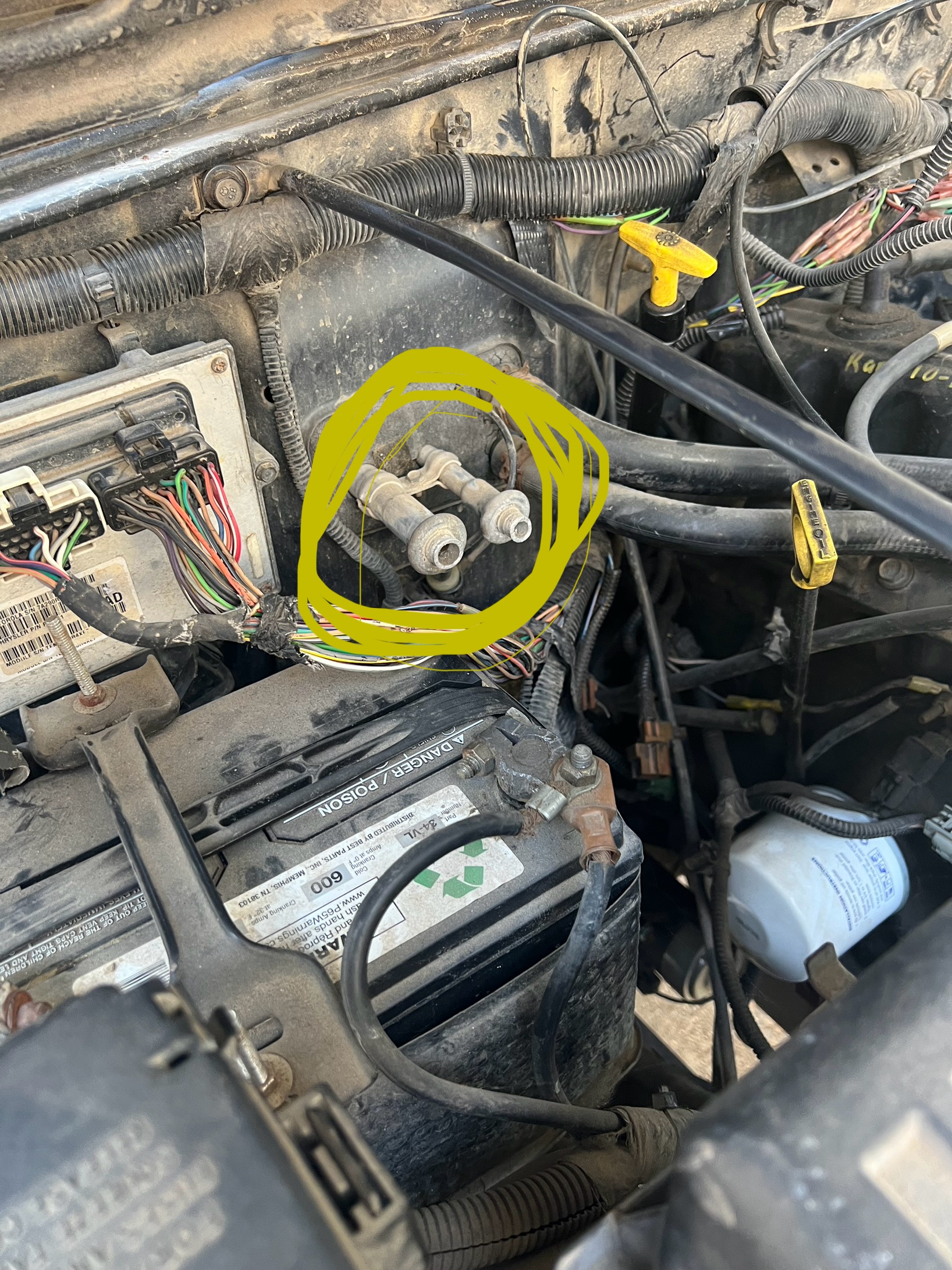

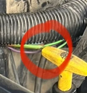

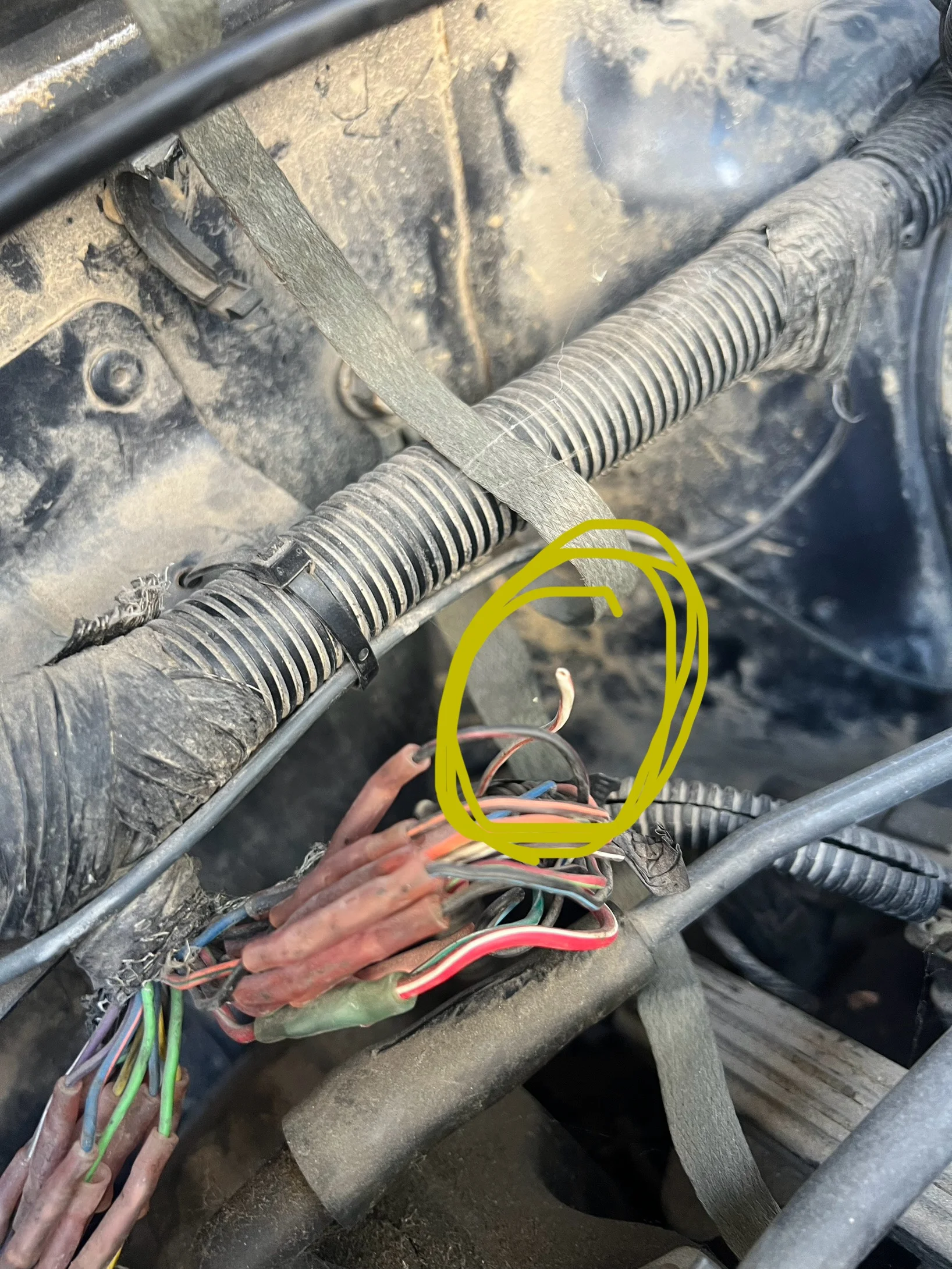

Under the hood there’s also a white/red or white/pink that is cut under the hood.

Is it possible for you to find a used '01 harness? there are a lot of burned/melted wires in those pictures you posted... not to mention a shit ton of spliced and butted wires... a new harness (or good used one) may be what you need to avoid a ton of hours diagnosing, chasing, and repairing each and every wire in there...
It looks like the engine was replaced at some point, and they just cut and spliced the new one in, instead of unplugging and reconnecting properly.

Man, I see so many things wrong from the PO, but I couldn't help but noticed the burned insulation from a wire that got a bit too toasty. You can see it was laying horizontally across what looks like four wires 🔥

I have been looking at getting a new wiring harness for the inside and under the hood. But I’m not sure that is even worth it. I also noticed today they removed the o2 sensors completely and the holes are plugged. I’m now wondering if 02 sensors can affect the no bus.
I actually removed this entire wire harness today and checked continuity for each wire. Everything on this harness checked out, but somehow still getting a no bus. The connection must travel somewhere under the hood. Or a bad computer.
Yeah that's got all the tell tale signs of a desperate engine swap and a frantic, desperate and uninformed hack job of wiring.

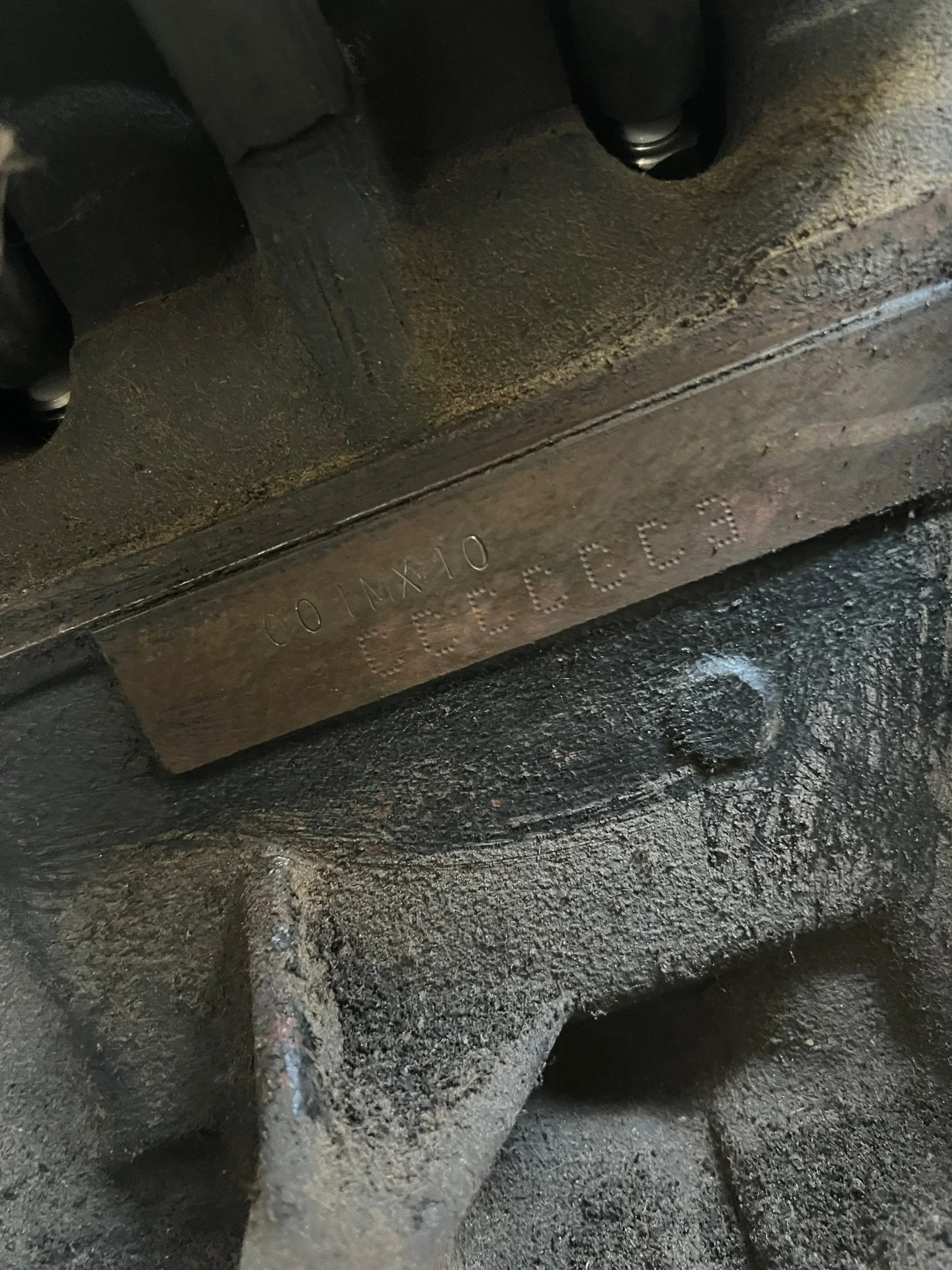

I think we need to start unraveling the mess...and I think I would try and identify what engine you have...
you may want to re-crimp all those connectors and see if that fixes the no bus... one of them could have a bad crimp causing a short. I'd start with the cluster closest to/going to the PCM...
Mac, Does this even make sense for an engine code?
The 1st digit is the year (7 = 1997)
The 2nd digit is the month (01-12)
The 4th and 5th digits are the engine (MX = 4.0 Liter)
The 6th and 7th digits are the day the engine was built (01 - 31)
So it is a 4.0l built on Jan 10 2000...
Next have to figure out what vehicle it's from... TJ, XJ, GC...
edit: that leading 0 could also be 2010, but that is unlikely...
