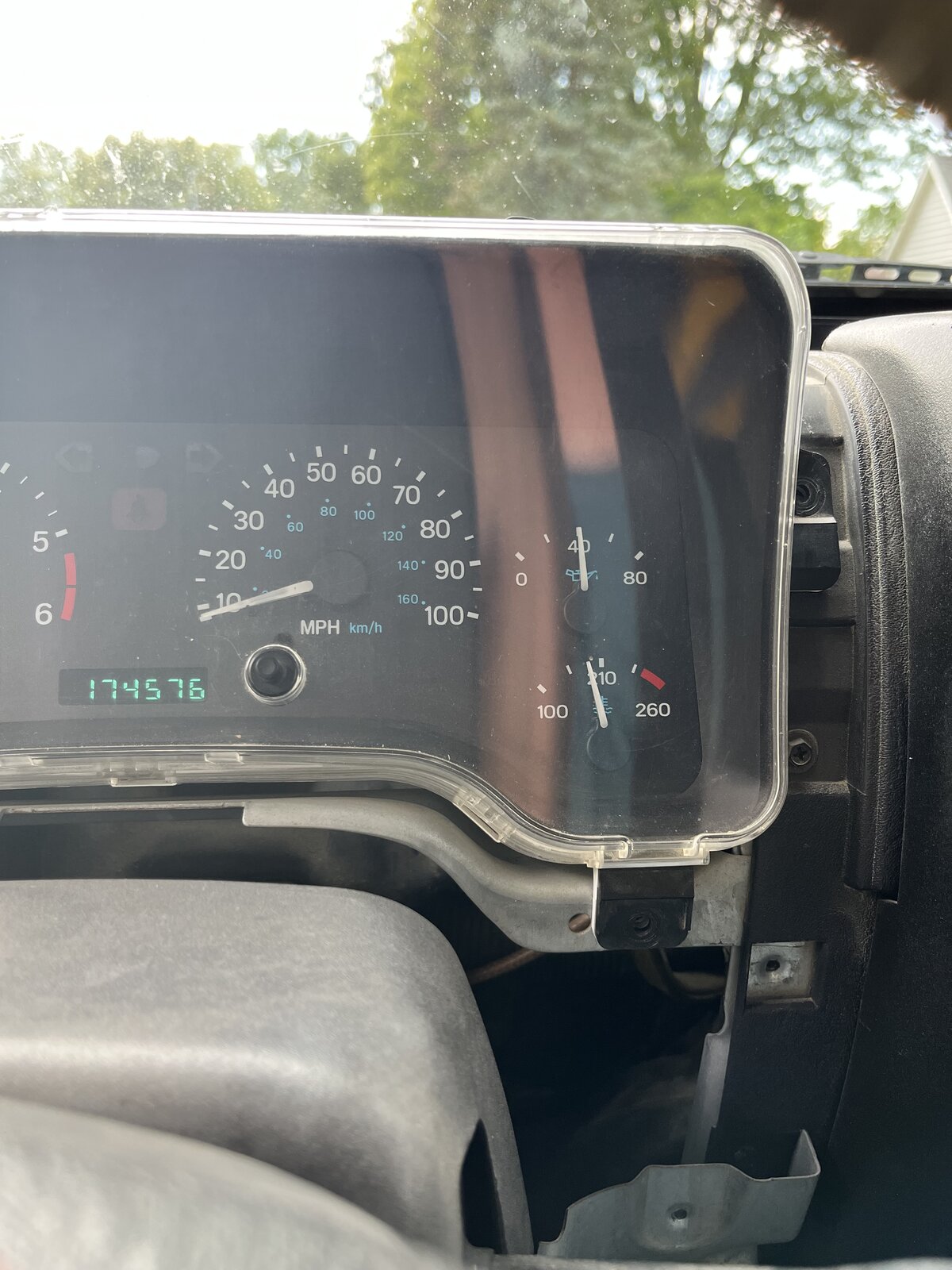

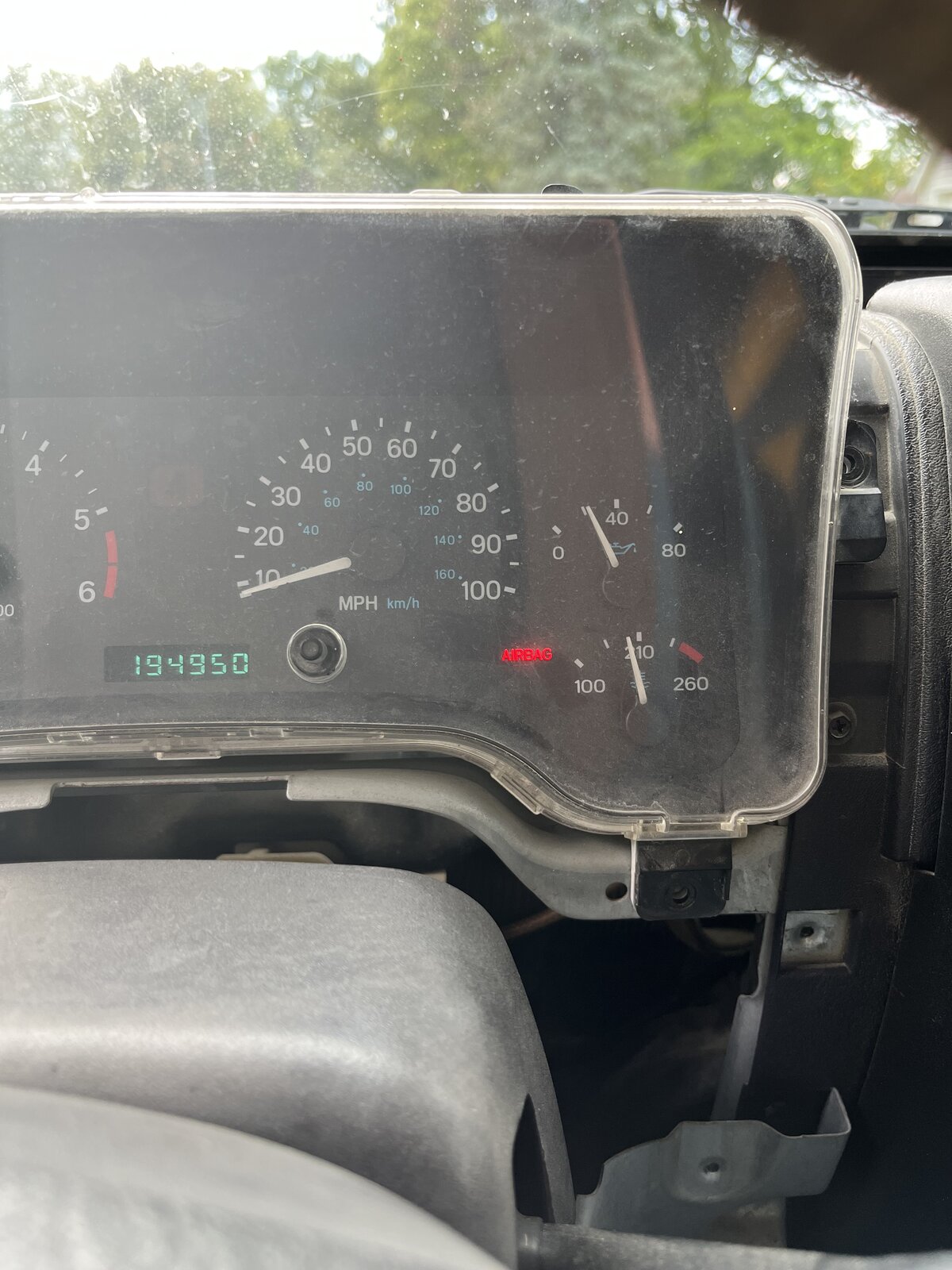

I picked up a used gauge cluster for $20 today at a Jeep show. I wanted to see how it would act in my Jeep. Swapped it in. Now my speed reads correctly, and my oil pressure reads what I would think is more accurate (closer to 20 psi at idle).
See these pictures that were taken less than 30 seconds apart with the different gauge clusters.
**Ignore the airbag light, it’s removed in the cluster original to the Jeep as the airbags are disconnected.
