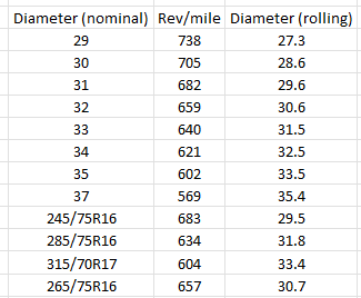

part of the issue may be that charts are probably designed using "nominal" size (the number on the sidewall), instead of actual size. A typical 31 is more like 30.5, and has an actual rolling diameter of 29.6" (nobody publishes this, but some publish revolutions per mile and you can back into it from that). If your tire manufacturer says the actual diameter is 31.1 you might need to be looking at the column for 32s.
The rev/mile has almost always been useful for me, when it's listed of course which it isn't always. Except for Falkens, theirs have been a bit off, but all other tires it has been useful. It has always seemed to me to be a logical number to use, because the distance around the tire doesn't change and that's precisely what that is measuring. The 2x to the hub also works, but I find I'm eyeballing it to get that measurement, so I prefer to just do the math off the rev number.

I don't remember what specific tire I based this on but I remember checking a couple manufacturers (of those that actually publish rev/mile) and found it close enough not to worry about brand and model differences.
Reactions: machoheadgames
rev/mile is all I use when it comes to gearing and rpm vs speed stuff. In addition to the measurement issue, the hub height is tied to tire pressure, but the rolling diameter isn't, or at least not in a magnitude that matters.
Yeah, I use the rev one when it's available and it is pretty close across all brands. The biggest difference I've seen between two brands on one size is Continental 255/75R17 at 647 and Duratracs at 653. Still close enough to be very accurate.
Helps that Grimmjeeper has a spot for that number so you don't even have to do the math for that if you don't want to. I have a similar list of rev numbers for all the common sizes in my phone notes app.
