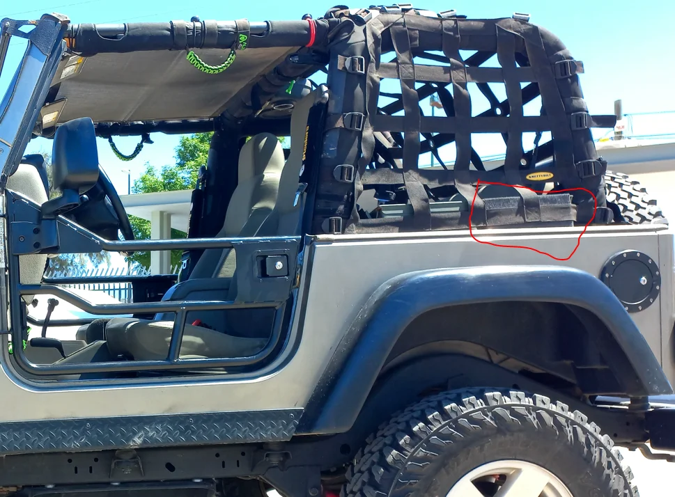

I was imagining something like just the part that's circled in the pic here. Just some easy way to make the speaker tilt back a bit. But I would also need to check to see how much room there is behind for the whole pod to lead back at all. If I remember correctly, the select increment pods fill up most of the room back there.

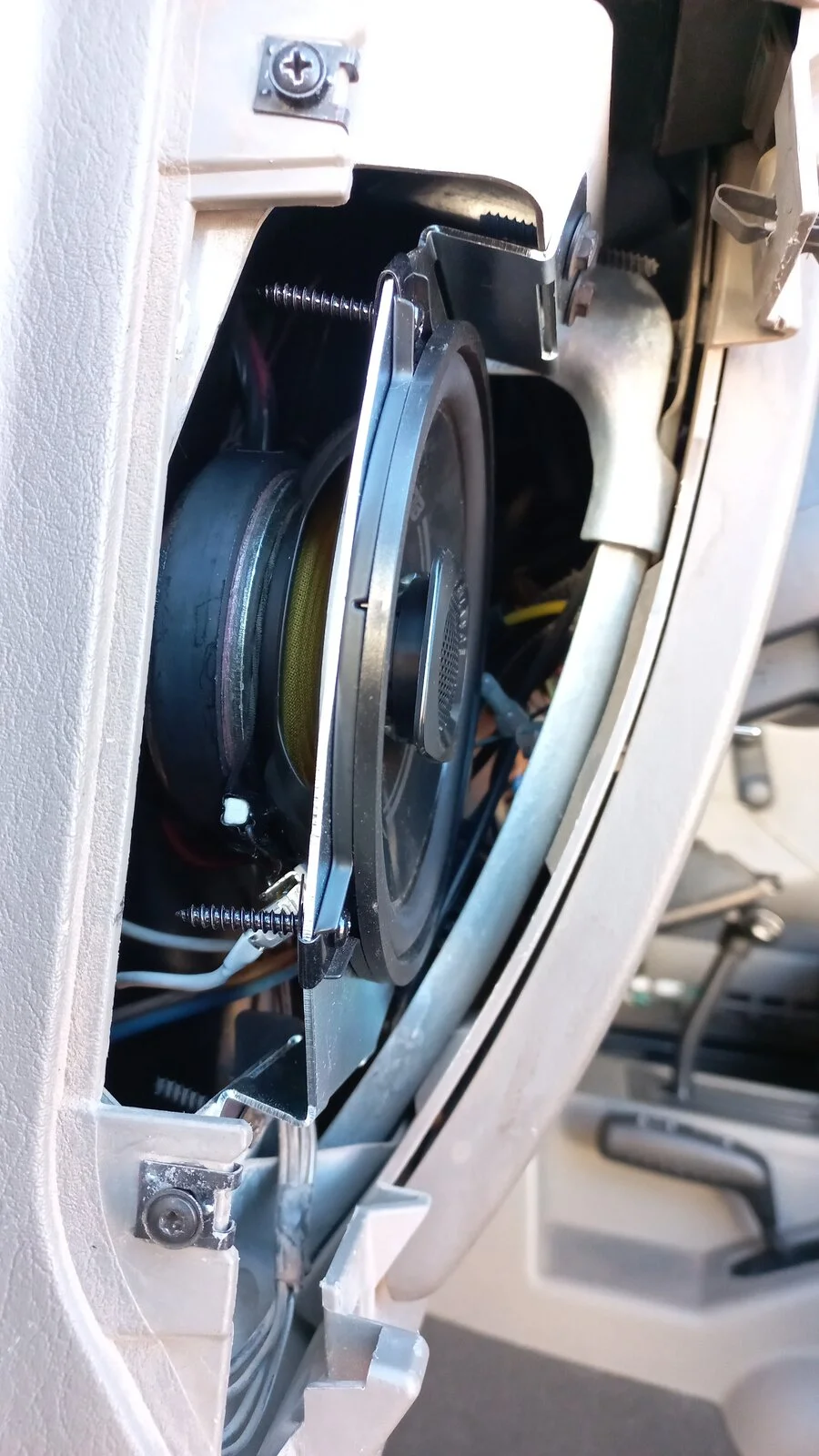

Just remembered this thread.
I tried, and no, there is not enough room behind these brackets for the pods—at least not for my Select Increments pods.
So it seems that the only way to improve the angle of my dash speakers would either be to remove the pod and try this bracket, or else to do some serious hacking to the dash frame.

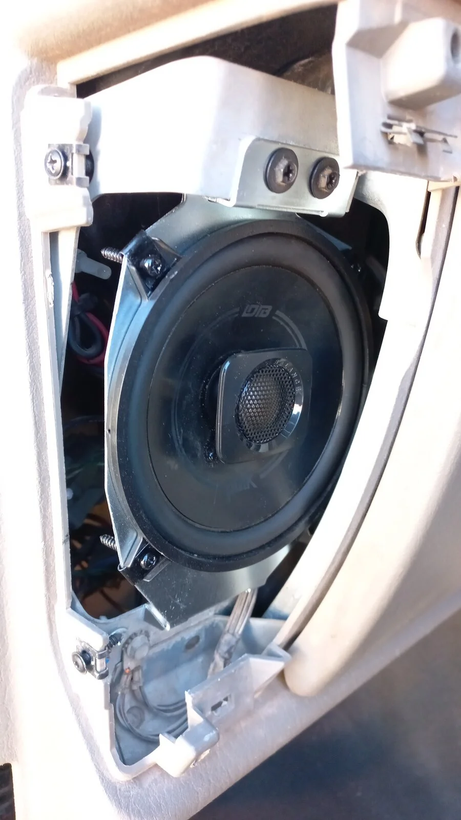

I just finished putting the 5 1/4 Polks in the pods and dash today. They are on sale at Crutchfield for 60 bucks a pair. Just used the plates on the front ones, may get the pods for them later.
