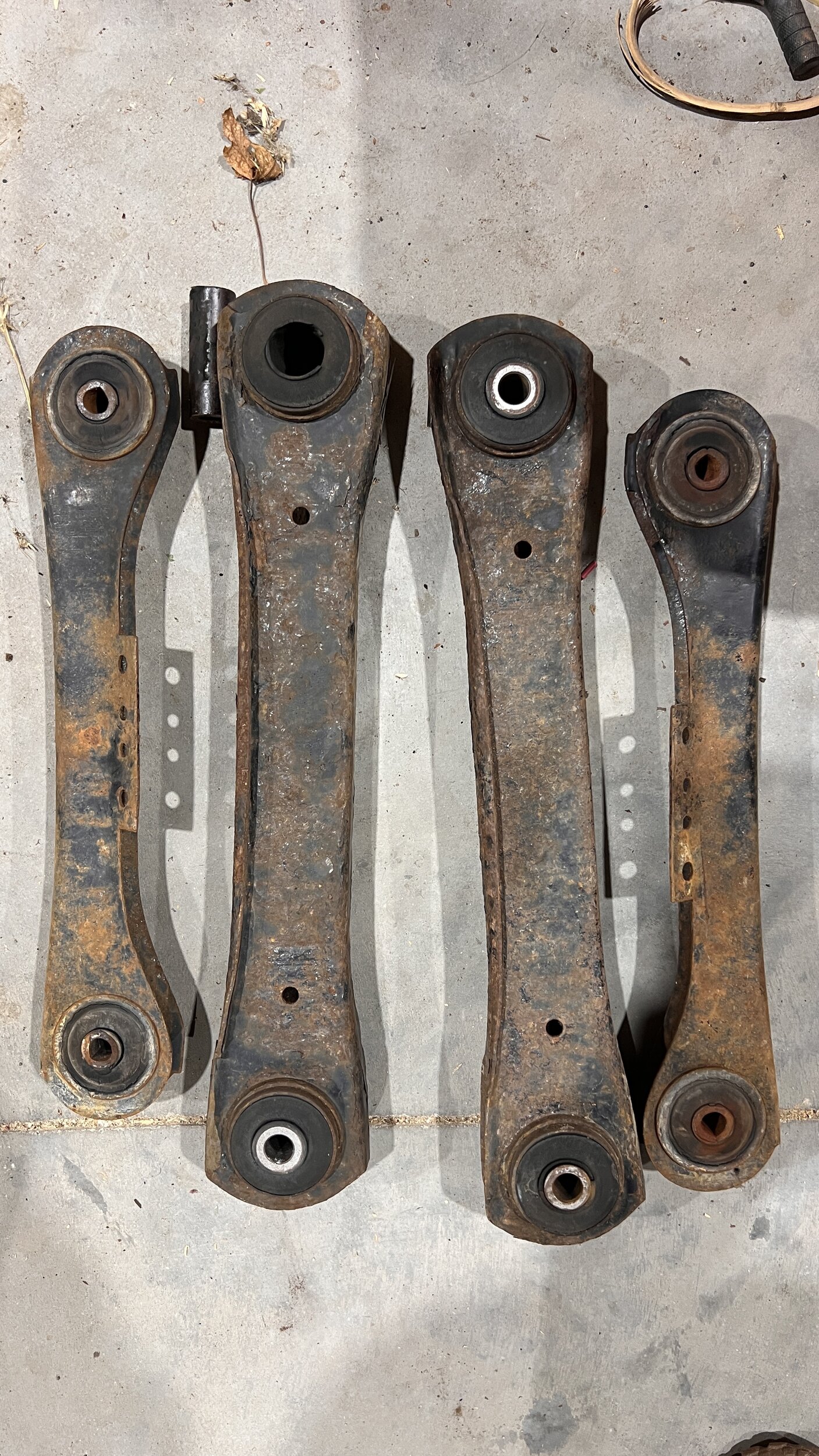

Got my rear control arms replaced, it did fix the rocking of the rear end, thanks all! You can see the bushings were in pretty rough shape.
