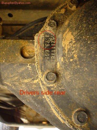

Also, what size tires are you running and what gear ratio is inside your axles?
There's a steel tag bolted onto the differential covers at their 9 o'clock position that has the axle ratio embossed into them. Depending on which axle you look at it'll say either 3.07 or 3.08, or 3.73 or 3.74.
This one is indicating the gearing inside is 3.73.

Thank you sir and first a "duh on my part" on 5th gear--silly me, my old jeeps were 4 speed and without the overdrive. That makes sense. My tires are 32 X11.50R15 and I'll take a look at gear ratio and post soon.
