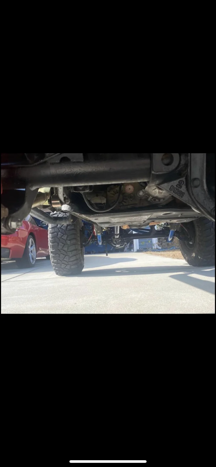

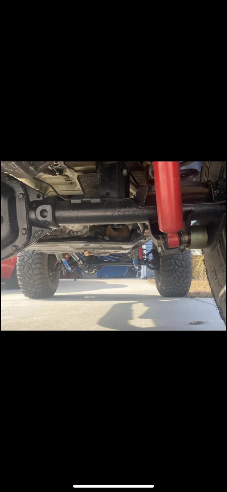

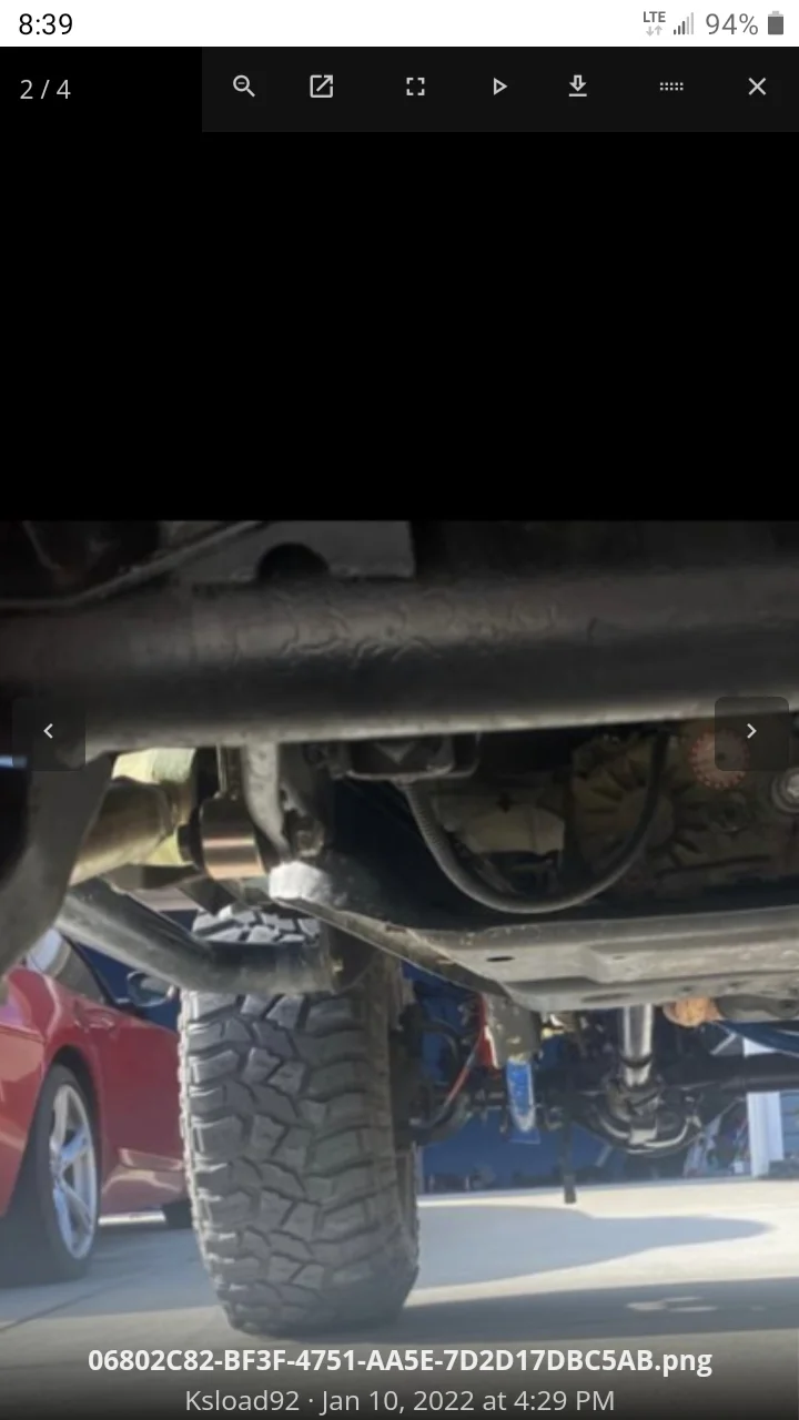

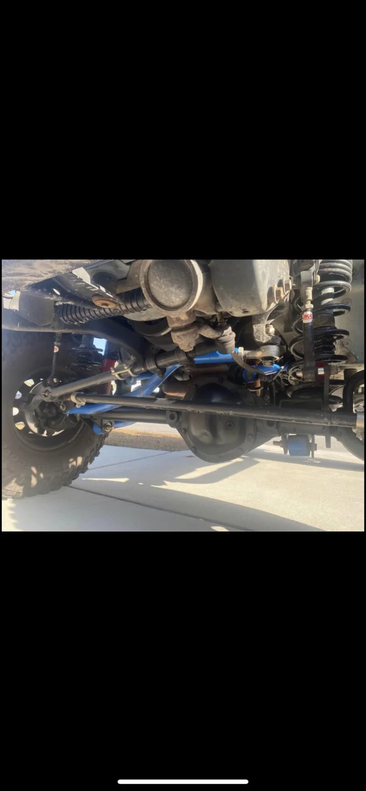

If you could post of pics where the front and rear control arms mount to the frame and where the TCase skid attaches to the frame it will help. From here it looks fine...I don't think GA is a rust state, but that's the biggest concern.
Reactions: CharlesHS
Appears to have transfercase drop spacers (picture 2) for driveline vibrations; do a thorough inspection of the frame rails for rust in the area of the skid plate mounting surface and the other areas recommended by JMT.
Reactions: P man
