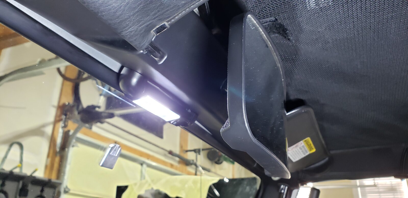

For those of you wanting more light in the cabin, I've now installed two of these and it's a perfect fit for the TJ/LJ. It looks like it belongs, is inexpensive, and is easy to install. All you have to do is tap into the passenger foot well light and run a positive and negative wire. For those with an '03 - '06 you can install it on the plastic center trim that the visors clip into. For '97 - '02, you'd need to drill into the windshield frame. The light is 6" long and pivots 120°.

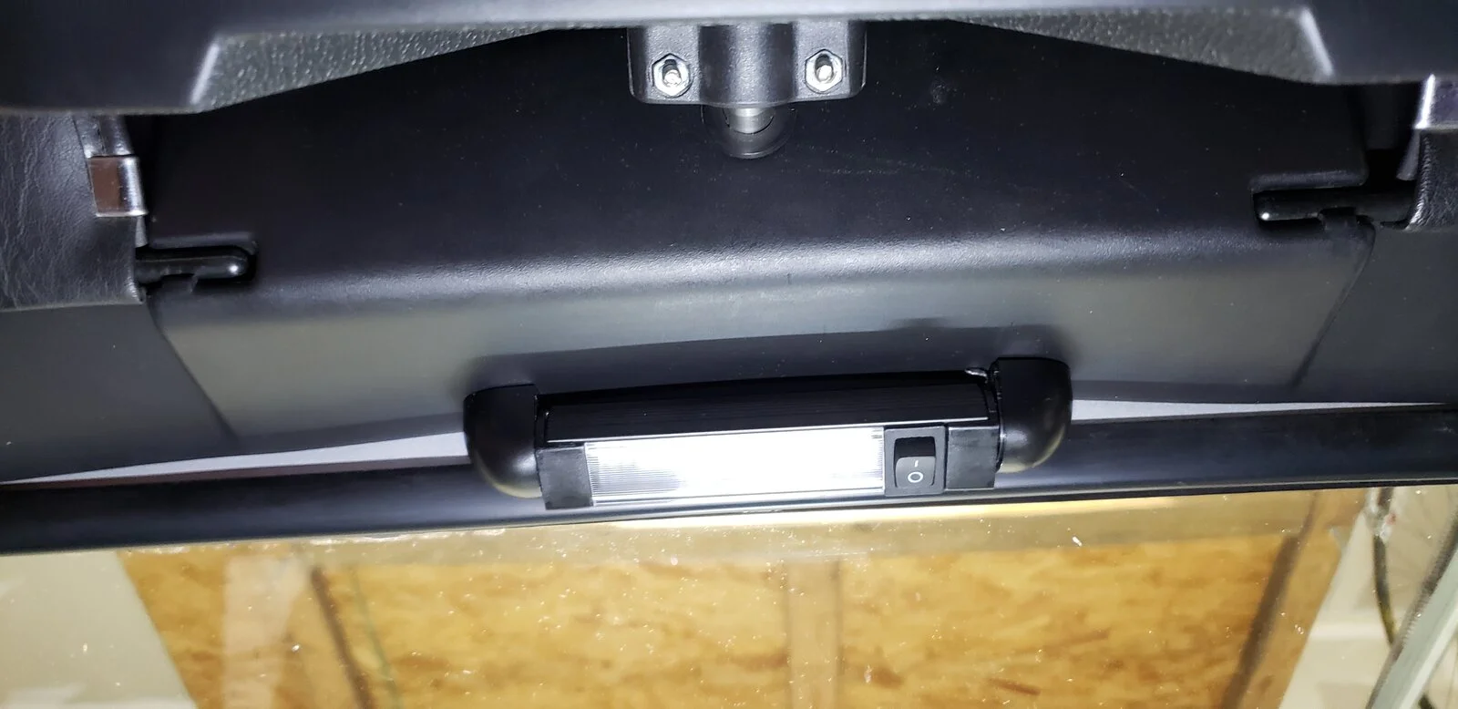

A second one went into my TJ, but was installed on the bottom of the plastic trim.

Love this. Just looking at that spot last week and shaking my head wondering why Chrysler didn’t put a light there!
