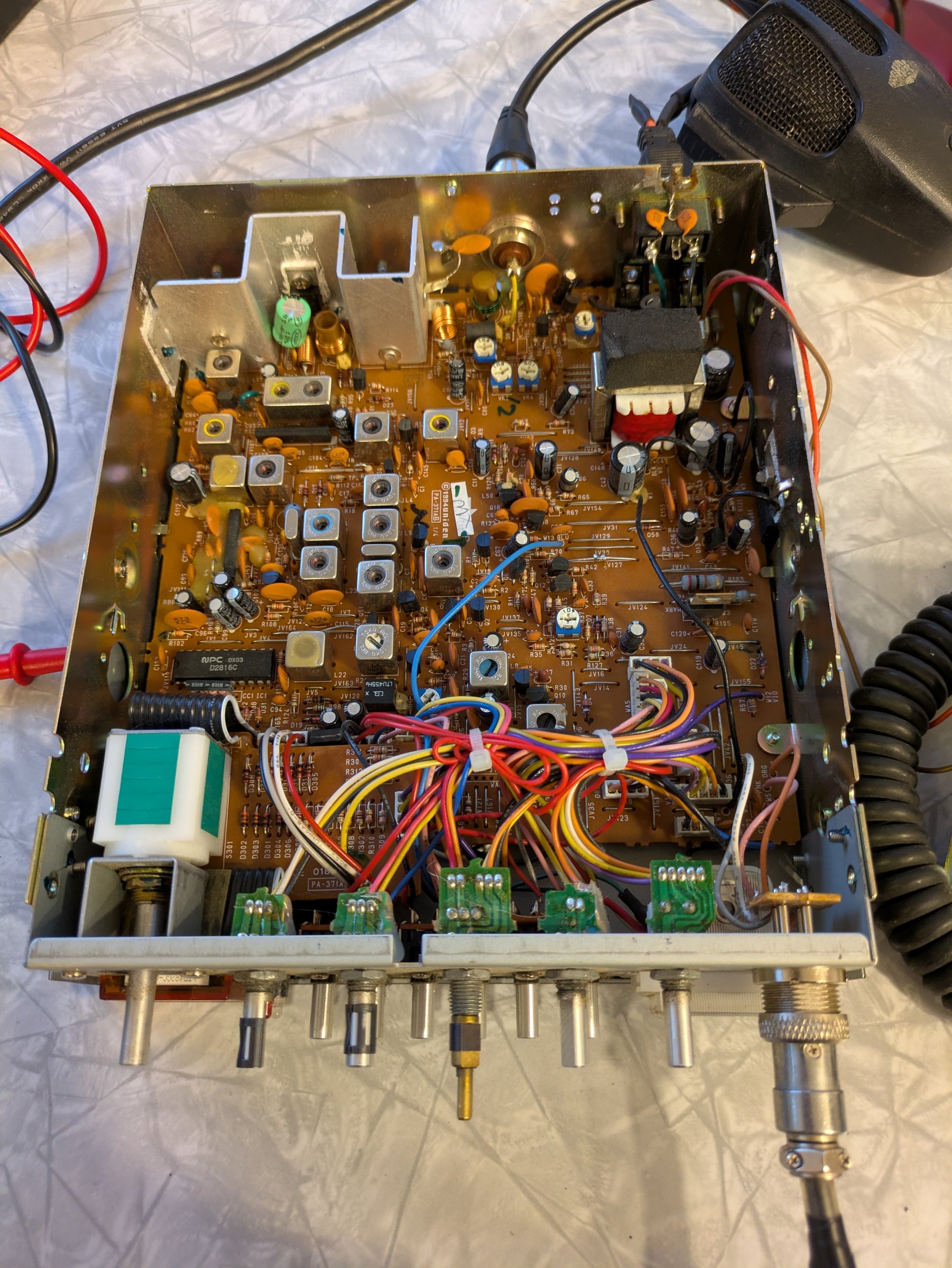

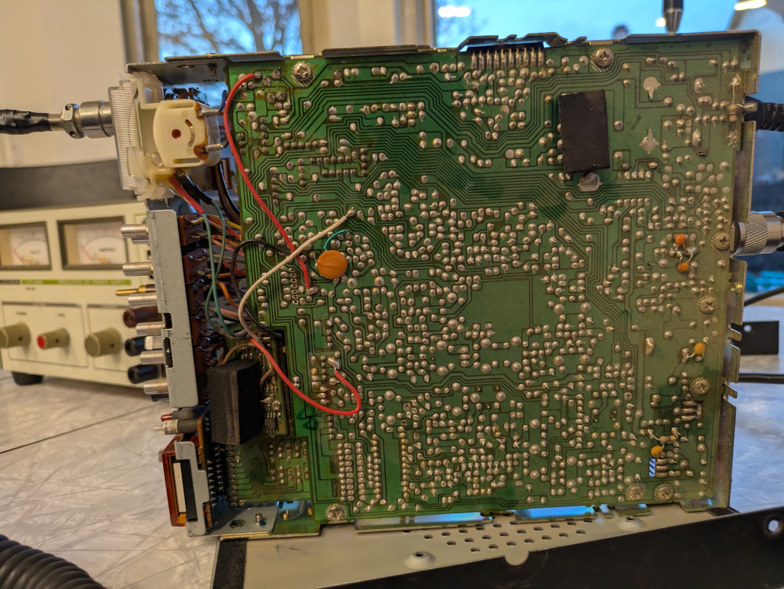

Hey all,
I recently picked up a Uniden pc78xl cb radio from a garage sale and it's not receiving, from what I can tell. It is confirmed to transmit. After opening it up, nothing immediately stands out to me or to my navy electrician friend (he straightened a capacitor, that's it). What should my trouble shooting steps be to get this thing to receive?
I've run through all the channels and I expect to get at least something while being in town is Colorado springs. I'll attach some photos of the guts and see if anyone more familiar with these spots anything.
Thanks!

Your unit is apparently a cobra 29 clone, excellent radio.
Here is a link to the manual: https://www.cbradio.nl/uniden/Manual_Uniden_PC78_XL_ENG.pdf

The cobra 29 had a known problem with the receive. I repaired one by going on the internet and googling cobra 29 receive problems. There was a complete section on it. Usually a short wire and a solder gun can have your receive back shortly. Unless it has already done then, no dice. Where the red wire on the board is soldered looks real close....footnote the cobras have used the same circiuit board since the early 80's. Cobra is aware of the problem but have no interest in the 29, repair issue. My understanding from reading earlier is its a 29 clone. Truck drivers buy them and have them peaked at maybe 6 watts, but their power supply will not hold out. The man that peaks your radio knows you have a short life radio, and will be back in for galaxy final transistors. I have no idea of how many clones the 29 has.
