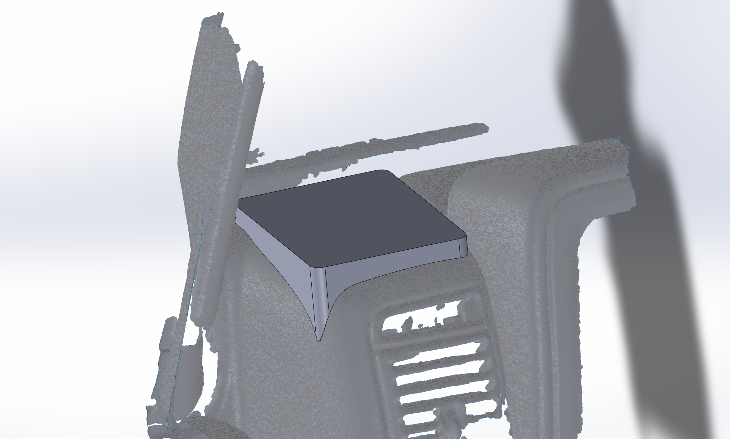

So I'm working on some stuff I want to 3d print. I am trying to decide if its worth trying to bond it to the dashboard with some sort of adhesive that can later be removed for a damage free installation, OR if I should say screw it and well, screw it.
What material is the dash made from and does anyone have any experience trying top glue stuff to it? I'm at a point where this is going to determine some key aspects of the design. Bonding is preferred id the adhesive can be later removed. Ideally this can be fully reversed without damage to the dashboard.
In the end, I anticipate designing a switch pod, gauge pod, and pair of speaker pods that will go on the corner(s) of the dash.

Which one? There are two in that screenshot. The actual part that I test printed and the 3d scan of the dashboard. A ram ball mount design is a good idea, I'll add that to the list.

You could stick it forever and then add some inserts onto it for an easy access to whatever you want to install and take off as many times as you want. Just make that the base.
uhhh the second photo? they both looked the same to me :ROFLMAO: perhaps make the top surface smooth enough for a suction mount if that's at all possible for a 3d printer.
I stuck a small instrument to the same spot in my Jeep using double-sided 3M / Scotch Extreme Mounting Tape. If you have a lot of flat surface under your 3D printed platform for the tape, it will probably do the trick (solid bottom, not grid or honeycomb).

Nano tape works. I've used it to stick all sorts of things, it stays put for as long as you need it to, then when you want you can remove it with no damage to the surface and no residue although it takes a lot to remove so the 3D printed items may break apart when pulling them off. It's also a bit on the thick side at maybe 3/32"

The suction cup mount is just not doable as the prints are porous and rough, but a ram ball is. I like this idea enough I ordered the parts to prototype it. I'll share the files when they're done.

Not a bad idea. I've got some M3 and M4 heat set inserts, I'll play with that. I Was thinking about a dovetail, but a universal mount that can just be printed and stuff bolted to is a pretty solid way to go.

Could try adding a flex seal type tape (super sticky) to the surface and then put the suction mount down on top.

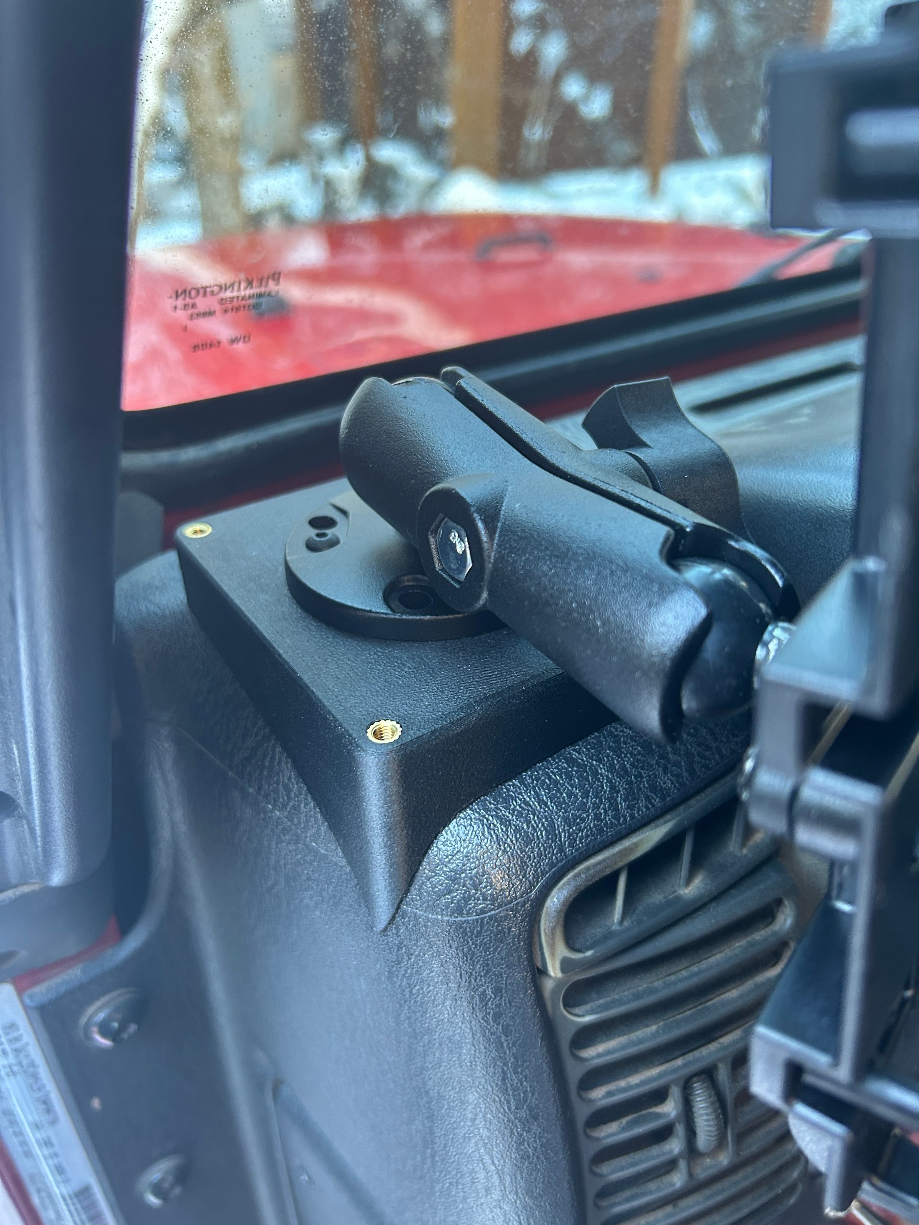

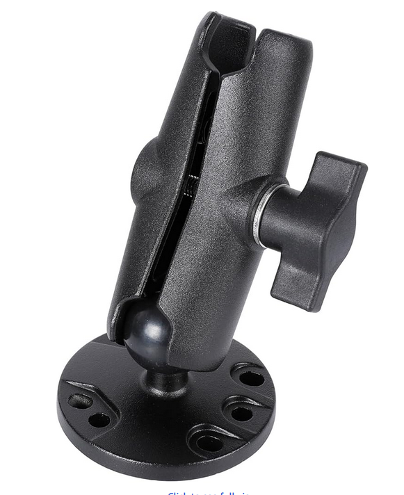

This is what I was thinking.
That way the mount is held to the 3d printed bracket with some M3 or M4 screws with some brass inserts in the 3d print. It would be super solid, depending on how the print is mounted. I think the weak link at that point would be the print-to-dash interface.
I would just stick the above to the dash using 3M tape. No need for the printed platform.

Alright, seems the consensus is to bond it down with some tape. I was talking to a buddy of mine and I guess they 3d print some stuff for the camper trailers he builds at work. They also just tape it on and the rumor is that its nearly impossible to remove the prints once they're tapped on. So I'll give tape a shot and if it fails, I'll see what else I can kick up.

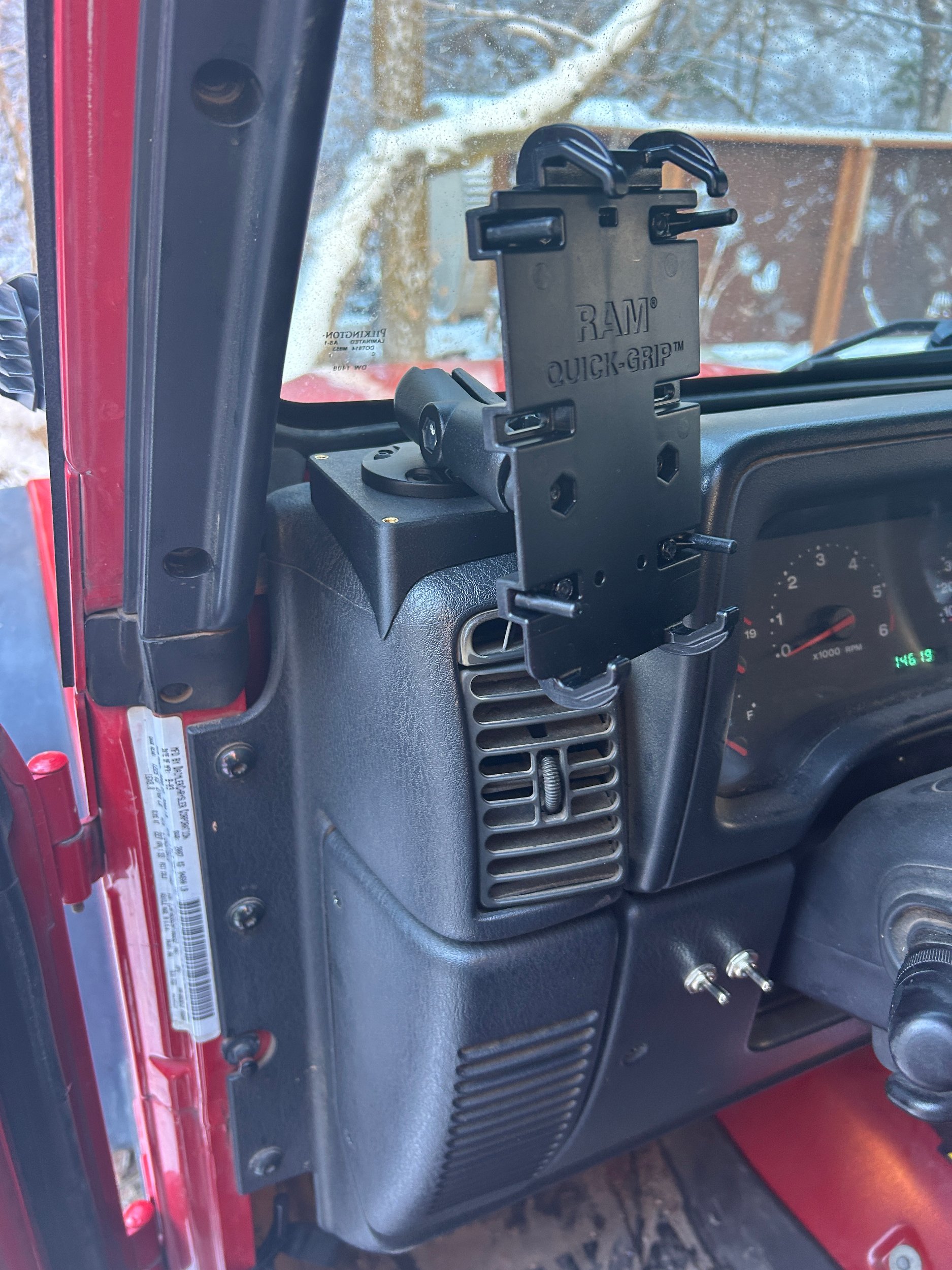

Well I got good news and I got bad news
Good news is the base is done and the files are here:
https://www.printables.com/model/1556162-jeep-tjlj-universal-corner-mount
buuuut...... I don't think you're gonna like the first use case I had for it @Zorba
