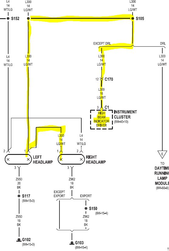

HB relay? As in high beam relay? If so there is no relay anywhere in the TJ's headlight circuit unless it was added by a previous owner. There is no need for a headlight relay for stock headlights or LED headlights.

The same switch inside the MFS controls both the high beams and also drives the high beam indicator inside the instrument cluster. All three lights are powered by a light green wire with a white tracer on it. If your high beams are not on when the high beam indicator is I'd assume a problem with the instrument cluster. The light green wire with white tracer shown below comes straight from the MFS.

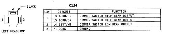

Are you talking about the headlight connectors? The #3 connector is at the bottom when it's connected onto the headlight which via the black wire connects the bulb's common to its ground connection.

Yes. I knew the bottom was ground or #3 but if you are looking at the back of the connector, is #2 the right pin and #1 is the left?
I was mistakenly giving you rear tail light wire colors and rear tail light schematic, this is for the front headlight connector. The one for the right has the same layout.
Jerry,
those wire colors are not at the headlights. The colors above must be for a different year then 2005. The yel/wh and Wh/yel are. The diagram above that you sent me is that looking at the rear of the connector where the wires enter? Is #3 on the plug ground/black because on mine the black is on #2?
