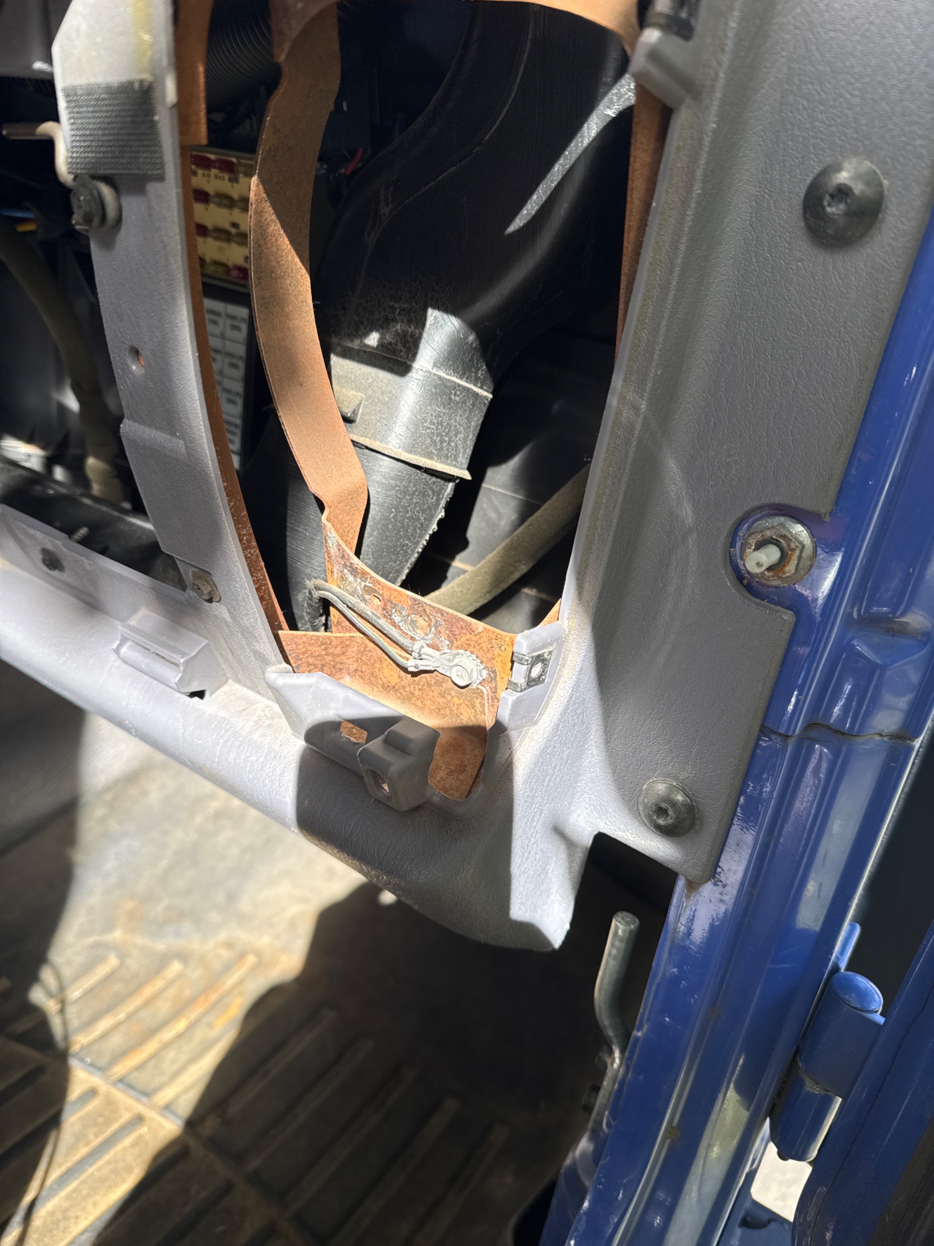

Ground for the motor is at G202. G202 location isn't shown in my 97 FSM, but in the 98 it shows as being grounded directly below the passenger side dash speaker.

Yes all fuses are in great shape and tested for continuity. If this is the ground, you’re speaking of I just tested it and it is grounded.

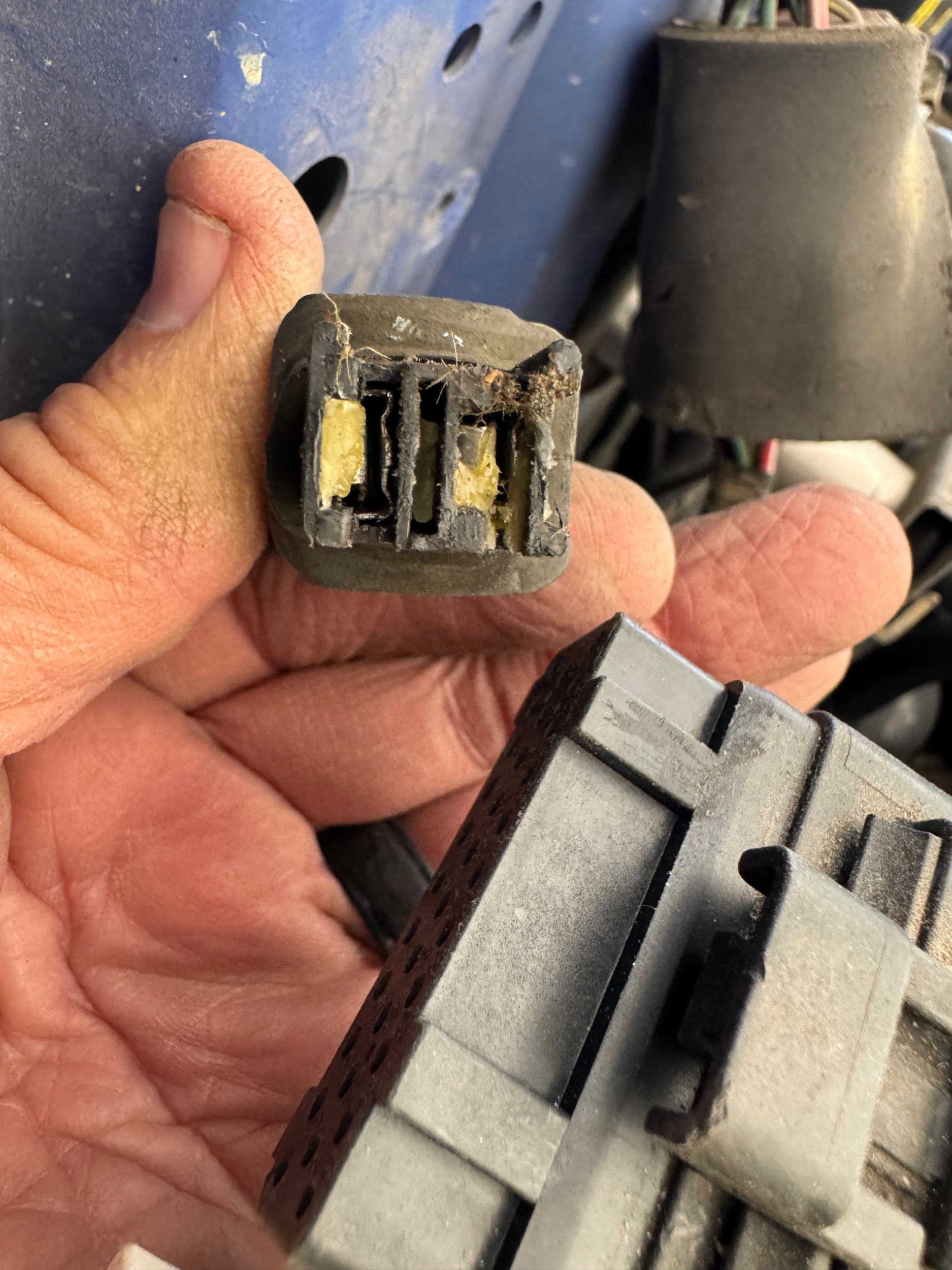

That's the one. Only other thing I can think of would be loose spade connectors inside the blower motor plug causing a bad connection.
That’s exactly what I was thinking. I know I tested it before I put it in but now I’m starting to second-guess myself. In the 97 it’s a little more pain in the rear because you have to take the battery out and you have to take the computer off the firewall just to be able to get to the screws to take the blower motor out, but I guess it’s time to do it again.

It should be pretty easy to test the fan plug at the motor,with a simple test light,

This does look a little sketchy. Going to see if I can move things around inside the plug and then try and test it.

This fan motor comes out under the hood, so I have to pull the battery in the computer to get to it. This plug is looking pretty sketchy though. I’m gonna try to move things around inside the plug so I can test it.

Just test the wires right before the plug,simple test light ,reverse the polarity of the light to test ground.if they both check out,wire in a new plug.

I cleaned the blower motor plug up and tested it for voltage with the Jeep running and the fan switch on. And there was no voltage. 🤦.

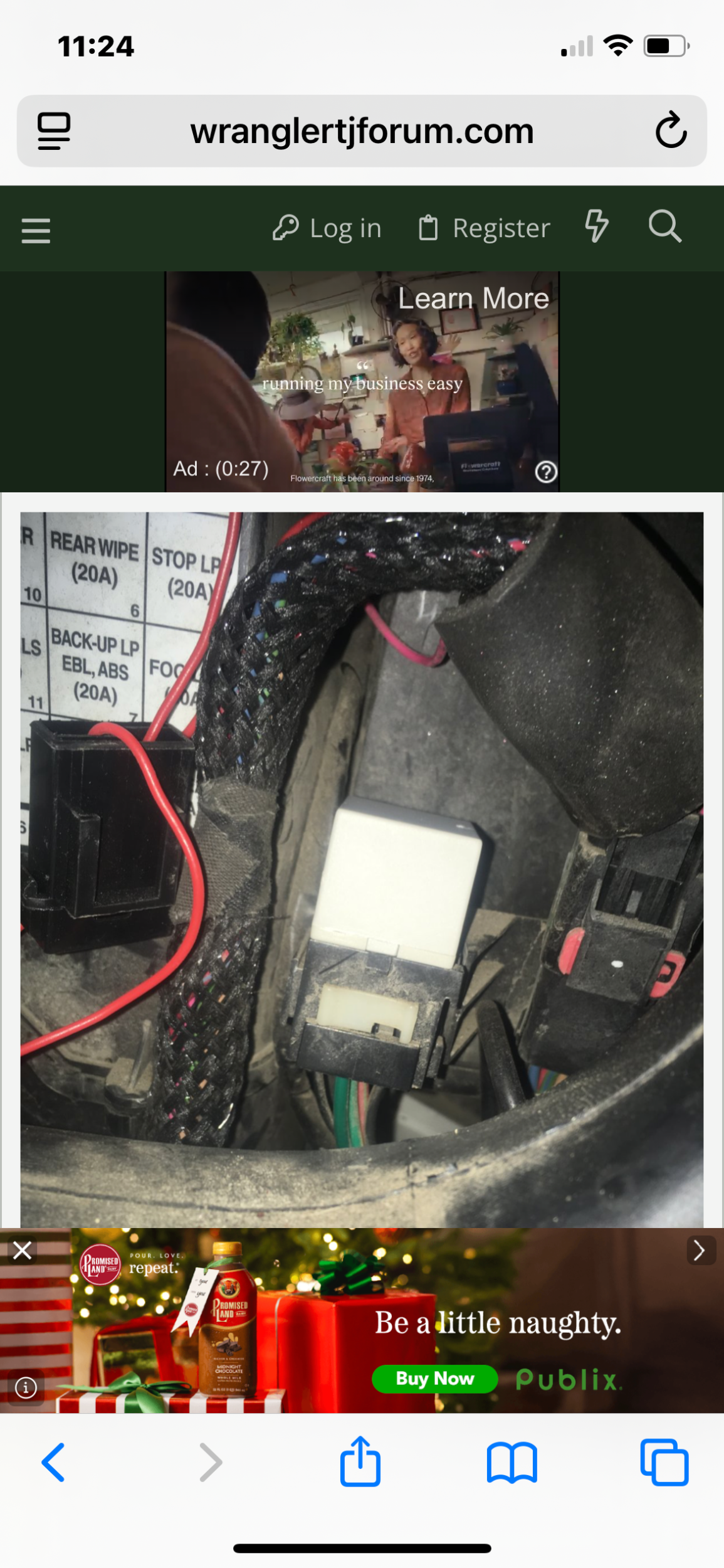

Now check it leaving the plug,you should be able to bypass the plug with a jumper.on a 1997 there shotbe a blower relay behind the glove box,test for power
