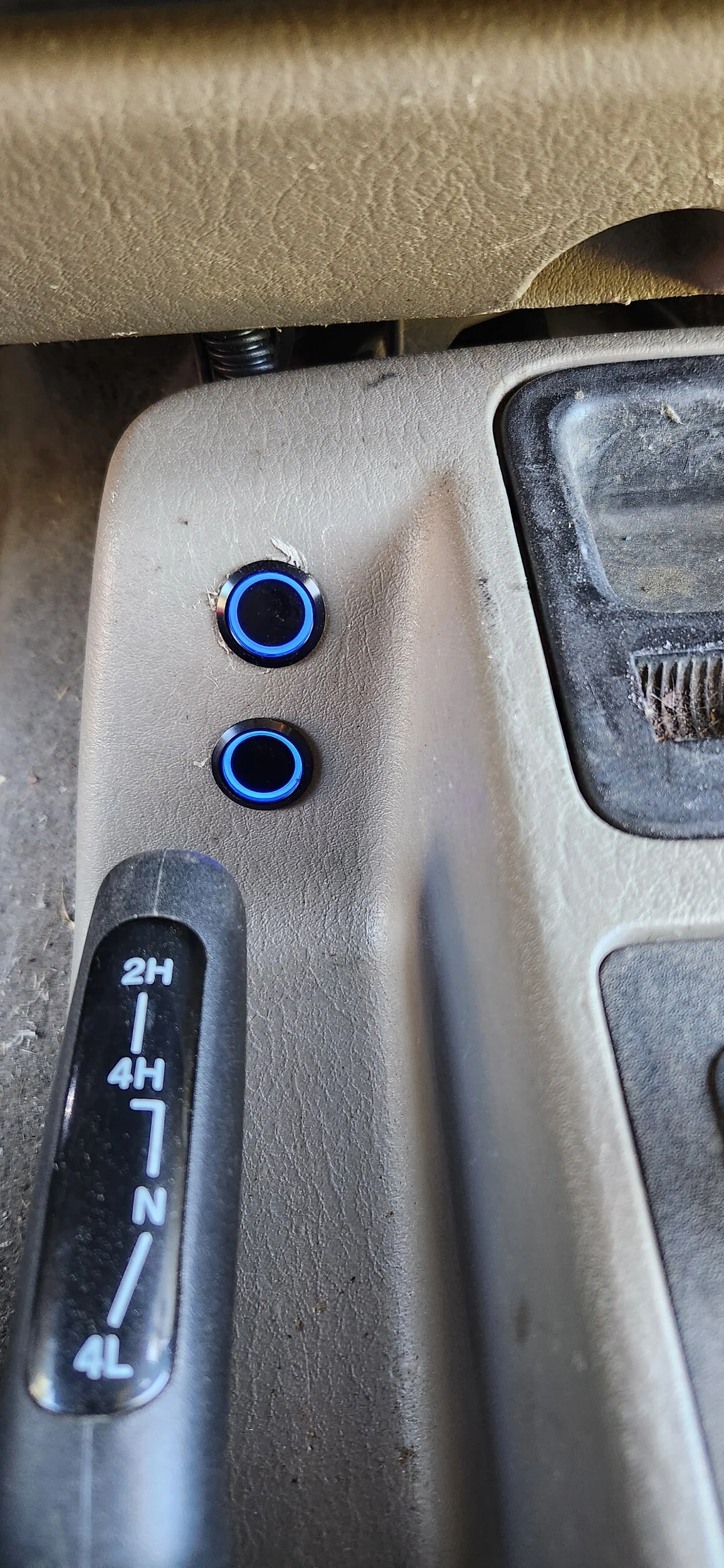

OK so I moved my locker pumps under the hood and wired them to switches to lock at the push of a button .. used the sensor in the diff to illuminate the switch when locked... however the front locker request is continuing to blink until you hit the rear lock switch then it stops but starts back when rear is unlocked .. not sure why but wanna fix it .. anybody have any idea .. gonna do some stuff this afternoon to try and solve it. Now here's what's weird .. when I cut off the jeep it continues to blink until I hit the rear lock button on and off then it quits .. didn't kill the battery last night so at least thats a plus lol
On a side note I fried the dash harness a couple months ago replaced it and all is good except the locker switch didn't work .. thats the reason for moving and wiring separately .. thanks in advance
OK so it won't let me upload a video so i guess picture it in your mind...
I figured it out.. I caught the rear sensor wires to early and one was actually the wire that allows front after rear .. put those back and ran farther back and caught em near the diff before a split and no more blinking light and rear switch now glows when locked ... yay me
