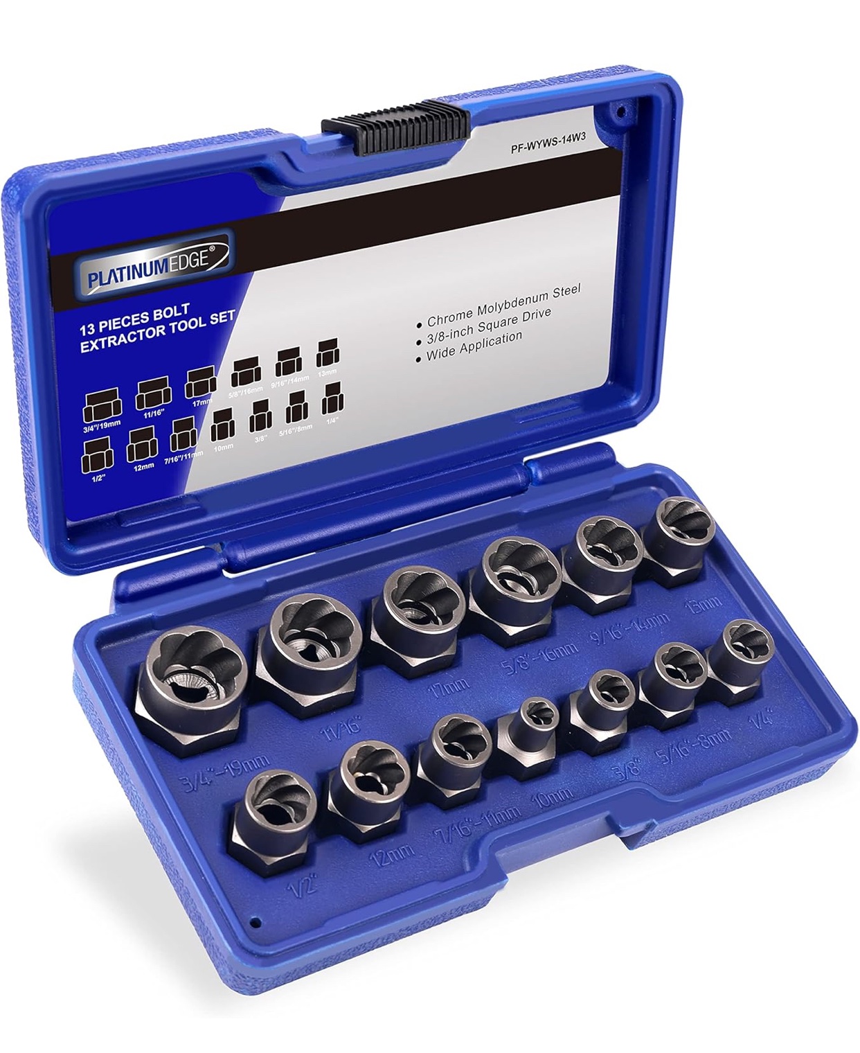

This is just an example, but I’ve always had good results with this type on a severely rounded off bolt/nut as long s you have to room to fit it on the hardware. I have and old Craftsman set.
https://www.amazon.com/dp/B087P5GKFK?tag=wranglerorg-20
Reactions: macleanflood
Sold by: Luckyway- perfectly named for this chinesium product.

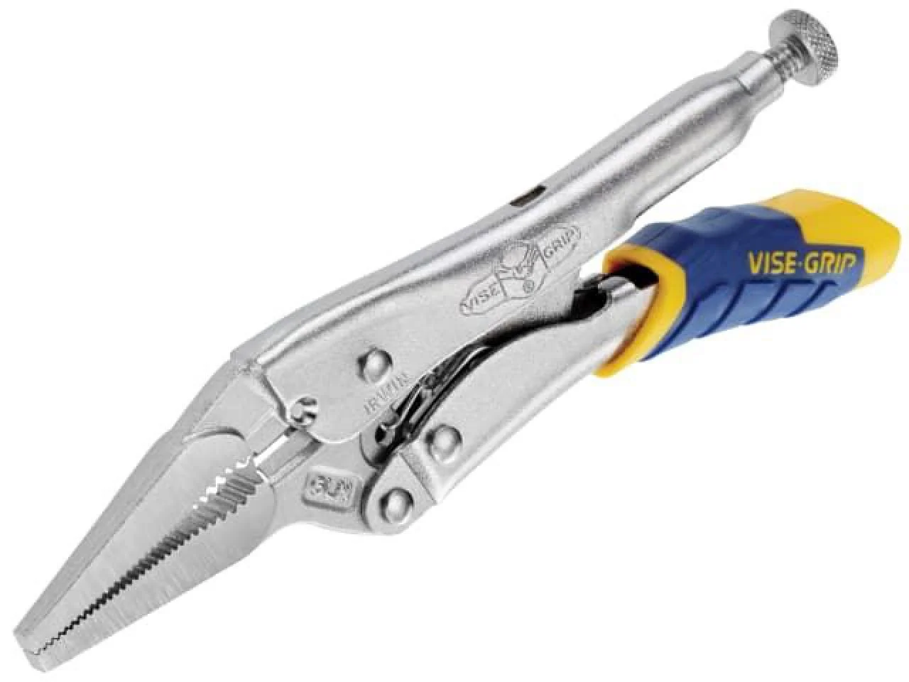

I found the long nose guys fit nicely in there.
That's the same tool I've used for that situation several times - always successfully. I'm actually in the habit of putting a six-point, deep socket on bleeders to break them free before bleeding - to avoid rounding the corners. It almost always works, even when I lived in the Rust Belt.
