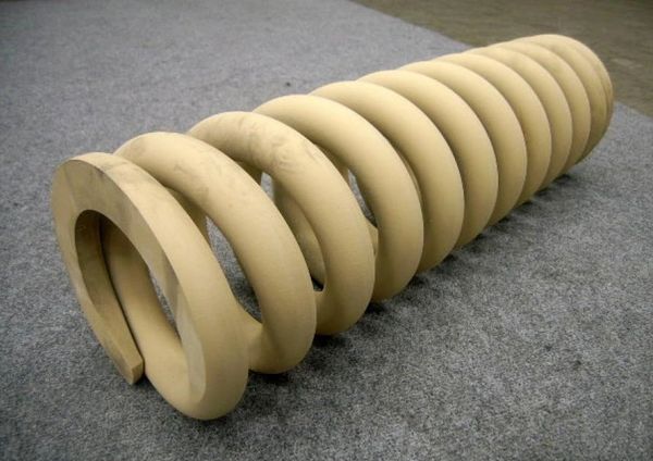

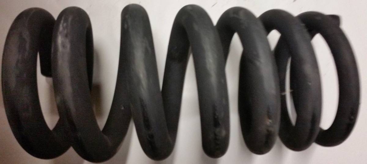

Springs set ride height.
If you rotate the rear perches to flat to easier measure the height of the spring, then it takes roughly a 12" spring to hold up the average TJ at a 4" lift height over stock. It is very easy to create a spring with a free height of 12 1/2" which only compresses 1/2" when the weight of the rig is set on it.
That spring would also affect ride quality in a very negative manner both on compression and extension. The extension would result in an accelerated and exacerbated jarring effect when it slams into the upper perch as the axle moves back up.
The reason we have continually pounded or tried to pound the "springs set ride height" and "springs don't matter" into the group think collective over the years is due to the rest of the basic criteria that it takes to design and build a spring.
It has to have a reasonable amount of free length so they don't drop out of the bucket too far.
It has to have a reasonably few number of coils so it stays out of coil bind at full compression.
It has to have a reasonable number of coils so it doesn't fatigue quickly and break.
It has to have a rate that provides the design ride height.
Once you get reasonably close to meeting the above criteria and create something that will do the job, last a reasonable amount of time without sagging or breaking due to fatigue, then the spring rates wind up within a fairly narrow range which is unable to affect ride quality in a discernible manner.
