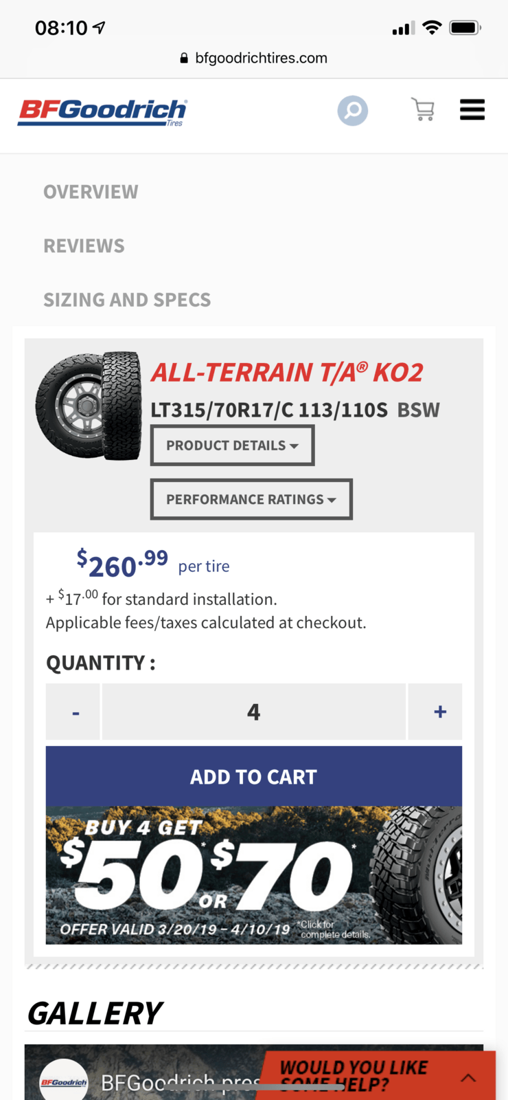

Wow!!! I didn’t even realize they made a load range c for a 17” wheel!! Well that changes the whole plan lol

Wow!!! I didn’t even realize they made a load range c for a 17” wheel!! Well that changes the whole plan lolView attachment 86381
They make tons of load range C tires for 17" wheels.
What you'll find however is that the load range C tires are all 315s, whereas the true 35s are load E range (with the exception of the Goodyear Wrangler Kevlar MT/R.
A 315 comes out to be 34.4" (depending on the manufacturer as well), whereas a true 35 in most cases comes out to be 34.8".
315 of course is considered the metric equivalent, and it's always what I recommend running, as the load range E is way too stiff of a ride.
The 315 BF Goodrich KO2 is 34.4". Of course it also depends on how much you inflate it, and how much tread there is on it.
Reactions: BuildBreakRepeat
According to discount tire direct and tiresize.com, the KO2 is the only load range C all terrain in 315/70R17.
