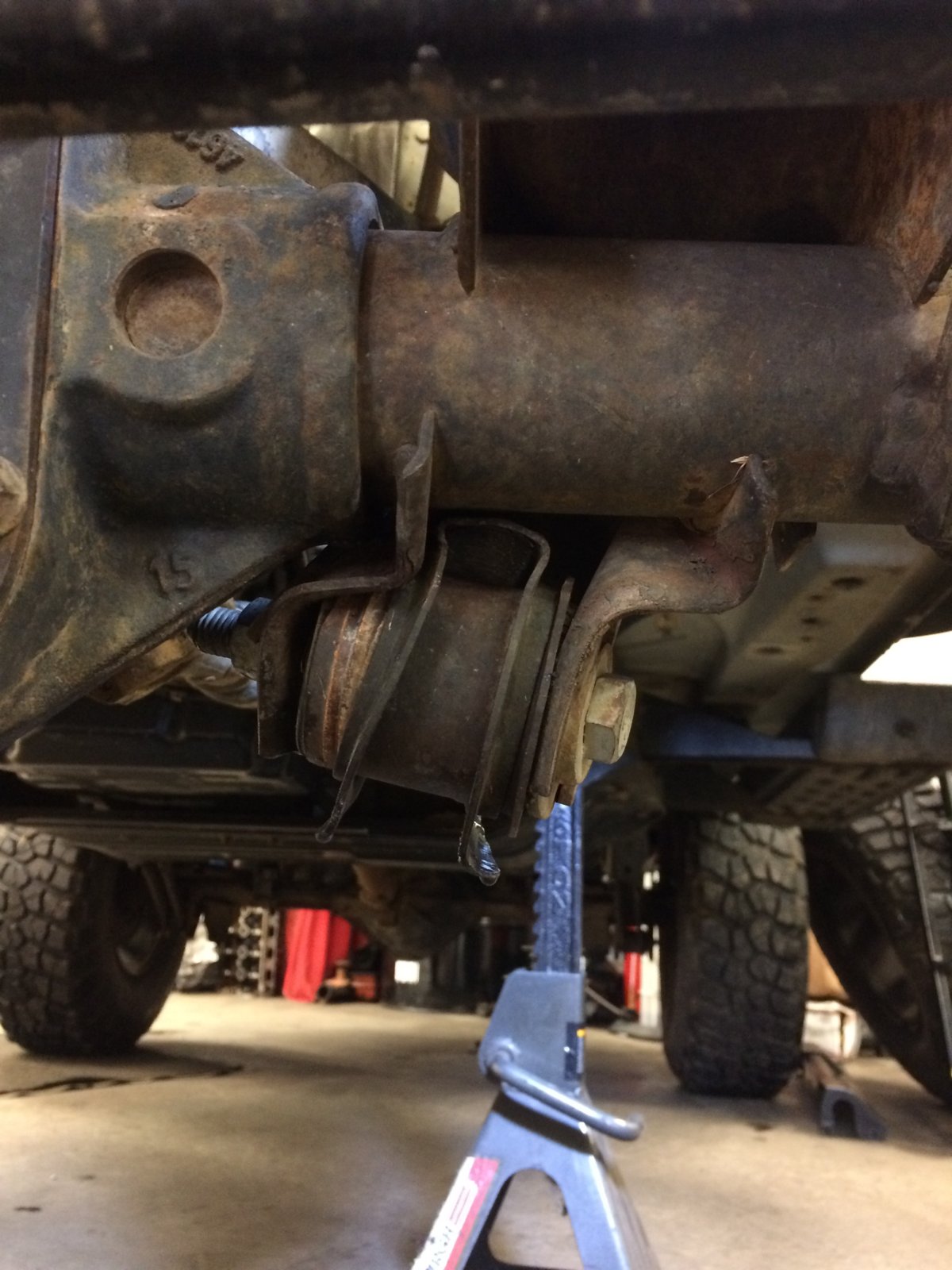

Driver side control arm is bent. If I replace both sides with a control arm for a 3" lift, will I need to upgrade any other parts? Or should I just replace with another stock control arm? My temporary lift is just 3" coil spacers.
I'd just replace the one arm with another stock one. You'll need to straighten out that mount too. Look closely at the mount where it's welded to the frame for any cracks.
