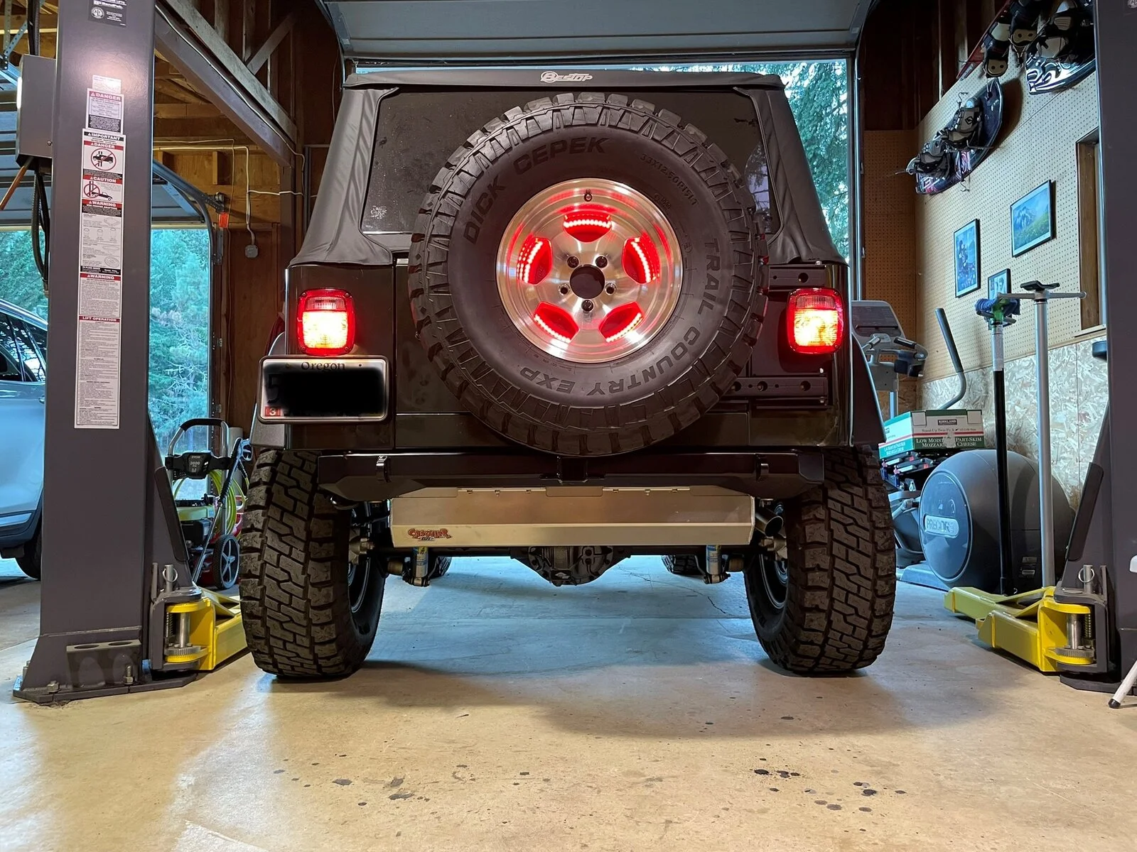

You build for what you want the Jeep to do. Mine needs a minimal bumper and it needs corners for reasons beyond the lack of bumper protection. And the spare will eventually go into the bed for reasons other than it's exposure hanging of the rear. Regardless, any bumper enormous enough to protect the spare tire is too enormous if a bumper.
The only reasonable way I am aware of to protect the tailgate with the spare on it is airing down the spare?

I thought I would chime in as I was there when you dragged your existing bumper over that ledge Saturday. The minimalist bumpers are light and have a great departure angle, however you are leaving that large 35" spare tire very exposed. Taking direct hits to the tire rather than the bumper deflecting some of the impacts is going to take a toll on your tailgate. There are lots of ways to skin that cat. Protection (tub corners, spare tire, gate) vs. weight vs. price vs. moving the spare to the interior. Most of the aluminum bumper I have looked at are over 40lbs. so there's that. If I was to go that route maybe something like this from RuffStuff https://www.ruffstuffspecialties.com/R2506-A . Just my 2 cents.

I have that bumper. Looks nice and is light but above concern about lack of corner protection is valid and I'll add that its not too beefy (3/16" steel). The receiver is not tow rated and I wouldn't use for that. The D-ring mounts are only welded on the outside. They do go through and I welded mine on the inside as well but the structure is light enough that I would still be corned about damage with a hard pull.
They also come with company logo laser cut into the driver side, so I had to weld that closed before powder coating.
Different bumper, but yes, I did extend the corners on the barnes bumper plate
