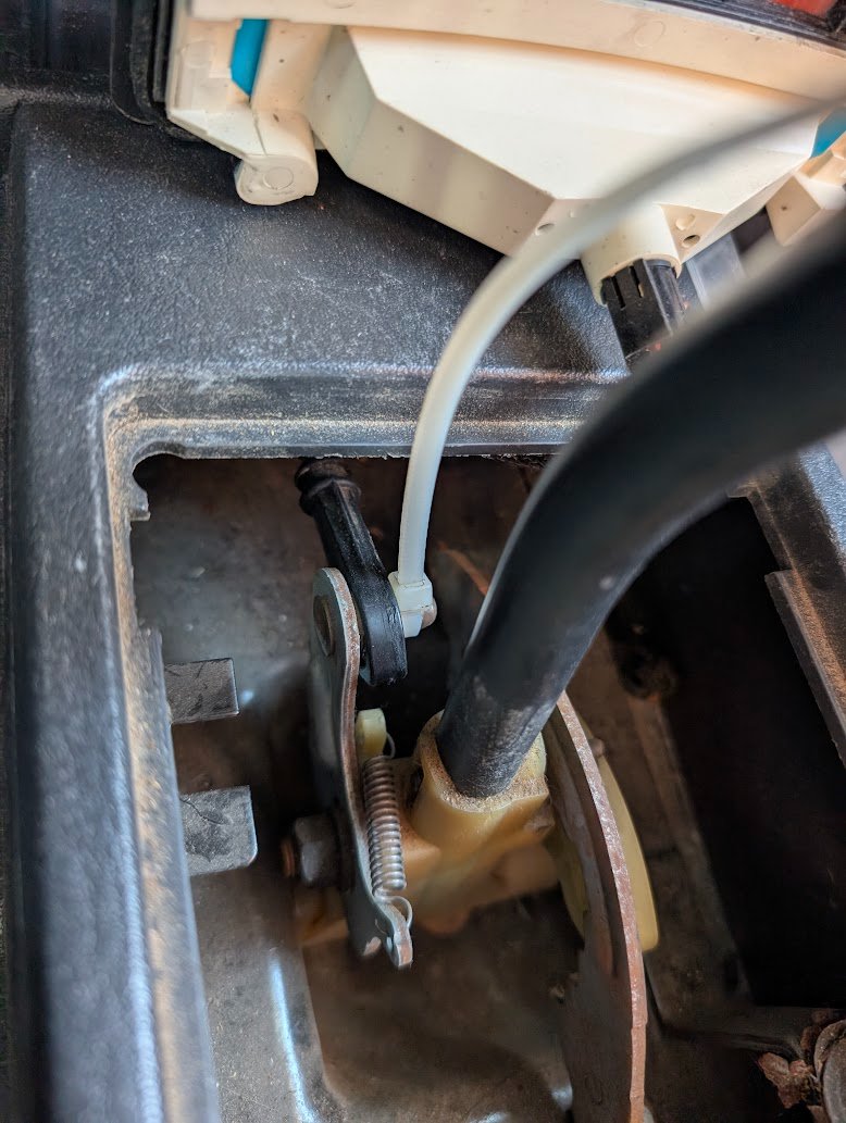

The bushing holding the shift cable onto the shifter broke. I can find a part number for the bushing underneath, but not one for inside the console. Does anyone have that part number?

I don’t but they have a dorman kit at O’Reillys that has a bushing that will work
You need to take a hard look at the one on the other end of the cable as well because they both deteriorate over time.

The one underneath was replaced about 1.5 years ago, it actually broke when it was with my mechanic, which was amazing timing. I actually already had the bushing as I was planning to swap it.
This one wasn't so convenient. I had just driven the LJ about 25 hours over 2.5 days from South Louisiana to the Elephant Hill trail in Utah. About an hour into that trail, in 4low and 1st, I lost the shifter. Found an uphill spot, wedged rocks under the tires and figured out the console issue. I'd be lying if I said I wasn't anxious at that time.

I used Mopar Part Number 68064273AB, looks like it's for the JK, and it worked.
