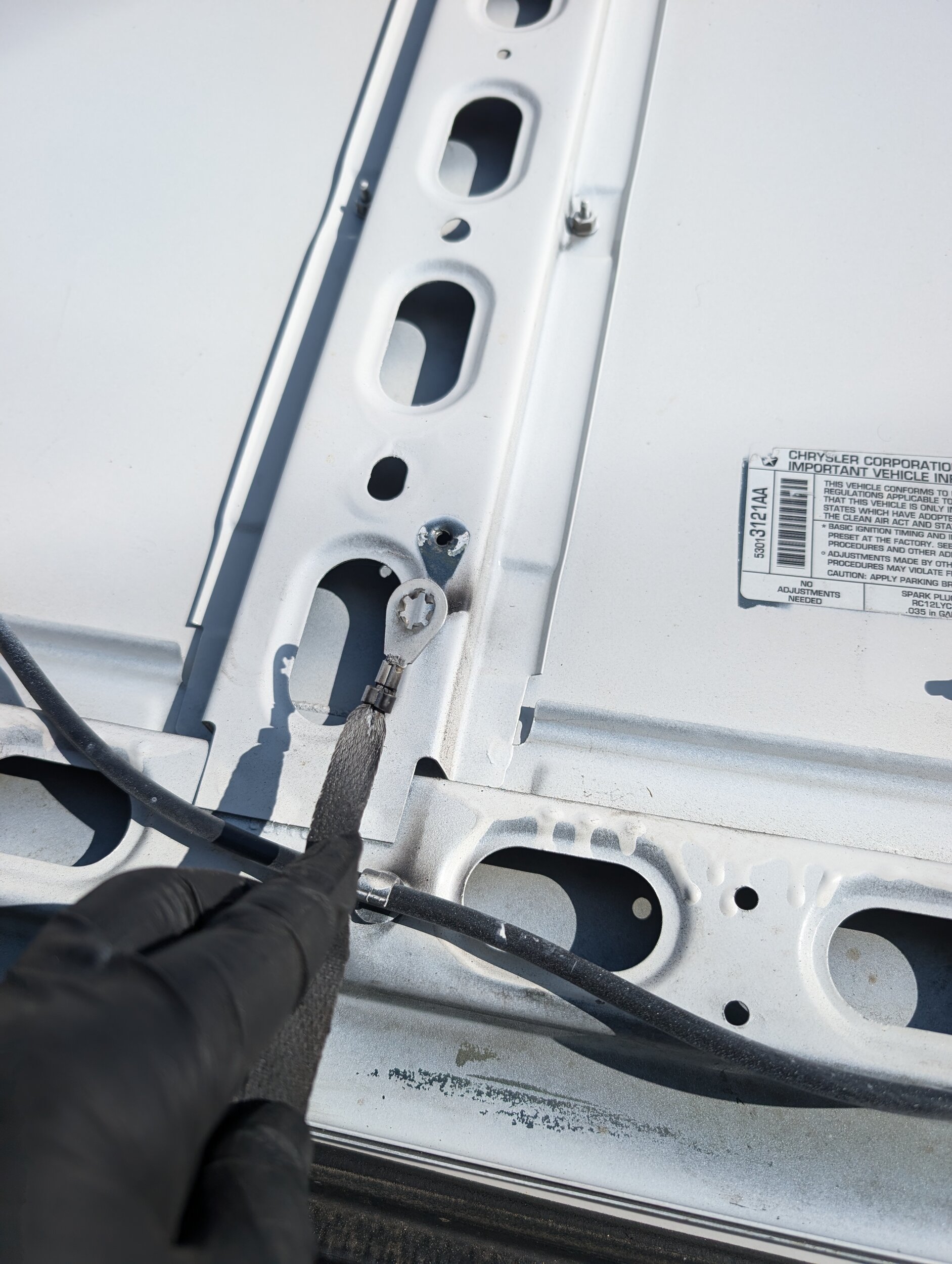

See picture for ground I'm referring to. Was checking my grounds yesterday and this one was loose (likely from the paint job I had a while back.
Just looking for the bolt size/thread pitch.
Pretty sure that was a sheet metal screw from the factory. Removed my hood a few weeks ago.
I just remembered I have a tap and die set, so I ran a tap through it. Seems to be M6x1.0. Which I think is the same as the "thread cutting screws" that hold the rear taillights to the tub. Which aren't quite sheet metal screws.
