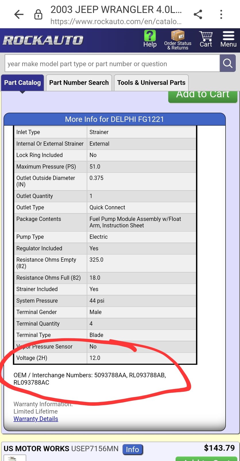

Only a few of the ones listed even show OEM part number compatibility, and none of them match this 😕
Is that based on knowledge of it being compatible/interchangeable with mine? Or just an opinion, based on the brand names?
The OEM cross reference part numbers shown on the Delphi info, doesn't list the original part number shown on mine though...
I'm hoping for a definitive answer whether or not it will work in my Jeep
Did a search on a Mopar website and your PN has been superseded by 5093788AA.
You can purchase a Crown unit on a number of sites.'
https://www.quadratec.com/products/55107_0008.htm
https://www.4wheelparts.com/p/crown-automotive-fuel-tank-module-5093788aa/_/R-BKMN-5093788AA
Awesome! I'll have a look and see what their shipping to Australia is like...but I will probably go with rock auto, now that I have the new part number...already have an account with them, and their shipping and delivery times are really good
Thanks a lot!
It is compatible and given the brand names listed Delphi would almost certainly be most trust worthy…
