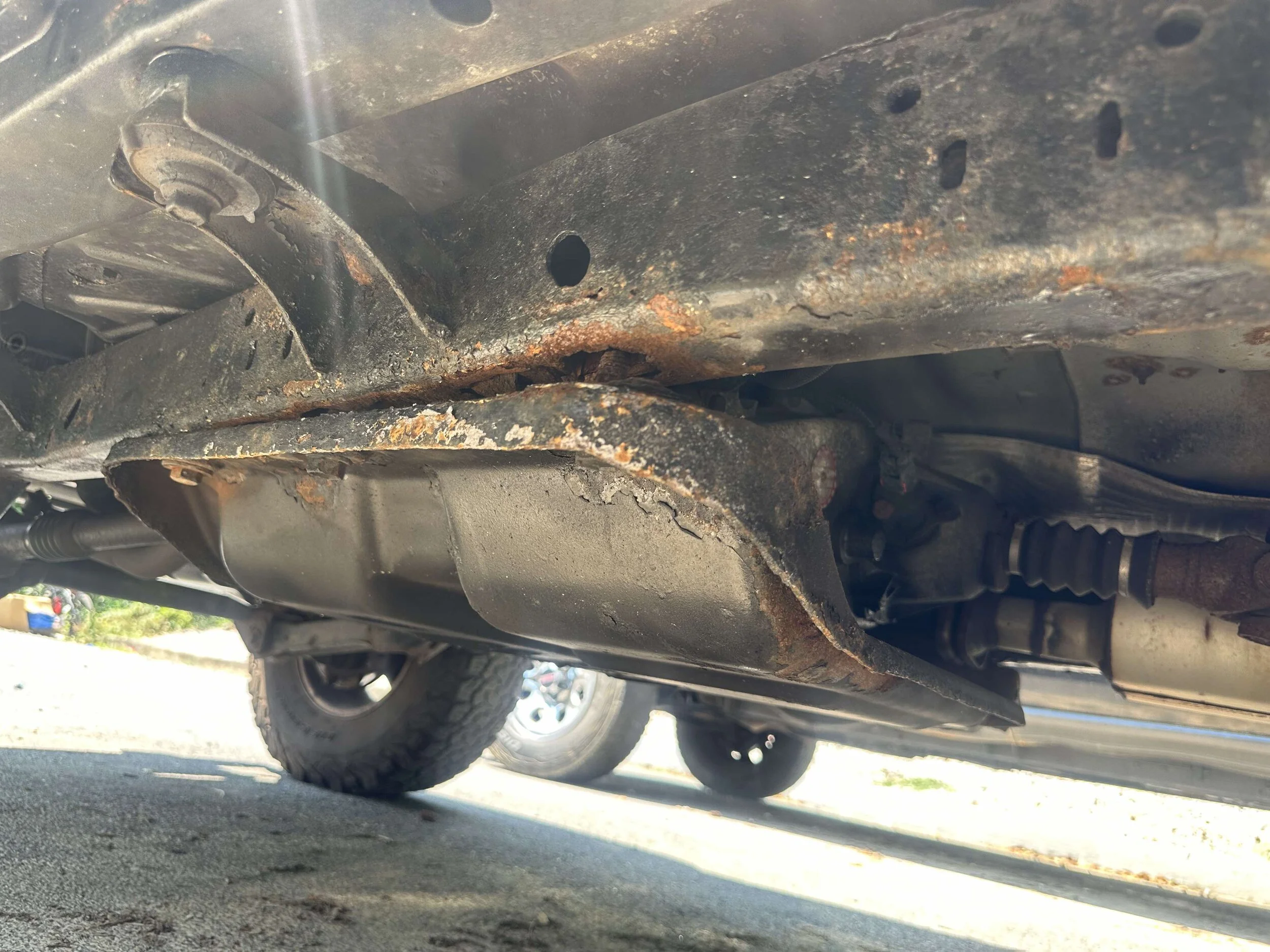

I'm slowly acquiring the needed tools and parts to do some frame work on my TJ this fall, a la safe-t-cap/Pocono etc. I'm going to start with the center sections above the skid plate on both sides, but I know those won't be the last sections that I'll end up replacing over the next year...
If you had to do a ton of frame cutting, would you spend the $$ on a cheap-o plasma cutter? I'll be doing everything on the ground since I don't have a lift, and I have to imagine a plasma cutter would be faster and far less physically demanding than holding an angle grinder up over my head while I'm laying on my back. I'll obviously need to grind to prep the frame for welding, but i figured plasma would be faster for the actual cutting portion of the prep. I'll happily spend ~$200 to not wake up sore the next day, even if the cutter only lasts me a year and then craps out. I have a big air compressor and 220v access, so I'd only be out the $$ for the machine and some extra tips and whatnot.
What are your thoughts? Besides buy once cry once, is there any reason you absolutely should NOT use a plasma cutter on your frame before welding in patches?
