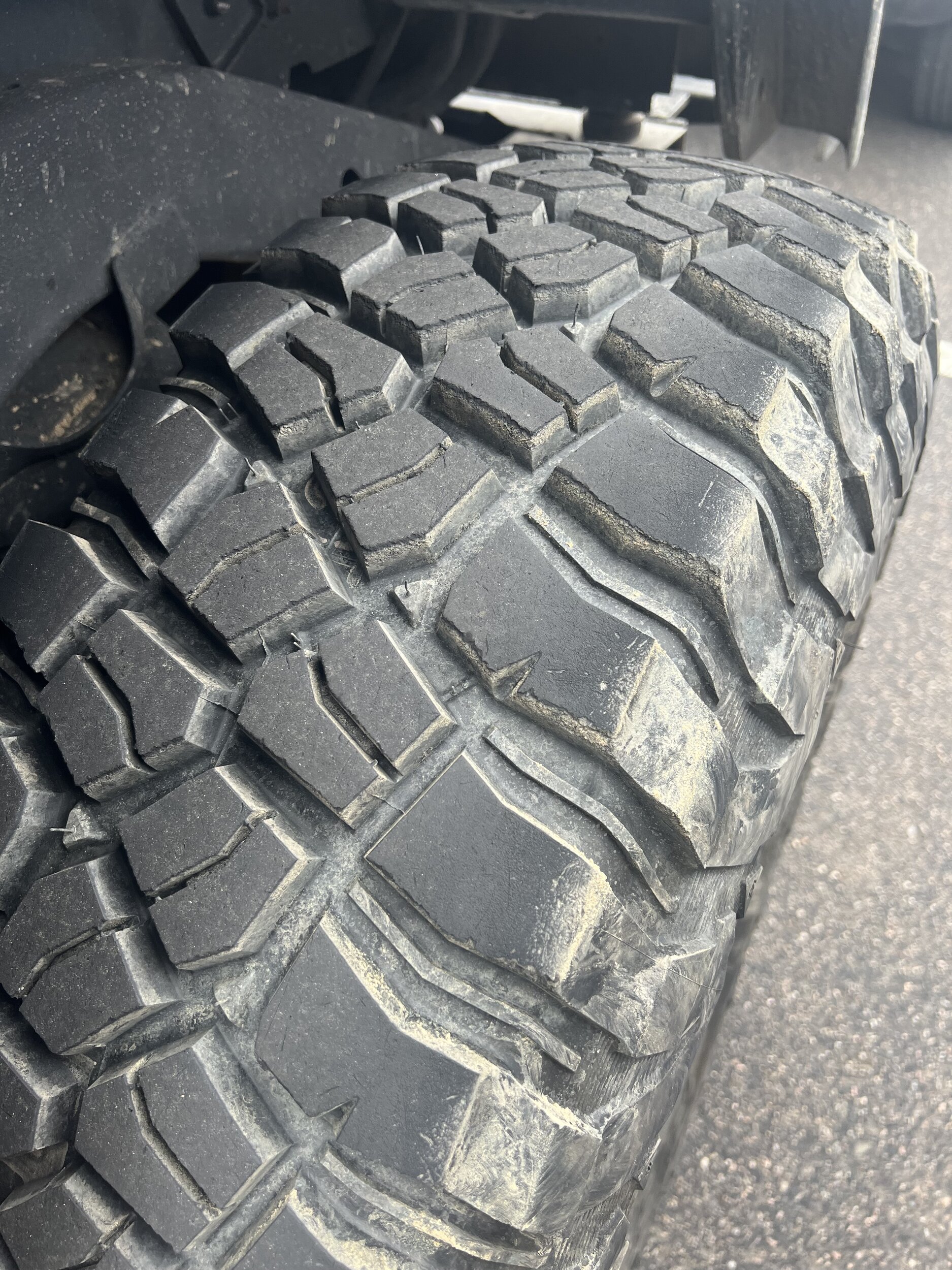

This winter I axle swapped to ditch the dana 35 rear (lunchbox lockers front and rear) and with that added 35" KM3's, adjustable links and adjustable trackbars. After 4 day trips this season to Rainbow Falls, Longwater/Hackett, and more recently Yankee Hill I have noticed the tire wear on the rear is insane compared to the front. The tread just looks VERY chewed up compared to the front. On those trails I struggled to grab traction on 2 obstacles of those 4 trips but eventually made it up. Wasn't squealing tires trying to get up them, just slightly chirped them then readjusted to get a different approach.
These tires have about 500 miles on them, if that. This is just a weekend trail toy. 30psi highway 15psi off-road.
Could this be due to the rear lunchbox locker not working correctly on-road? Maybe it's not unlocking properly through turns?
First things first, I will be taking it for a professional alignment here shortly and then seeing if they have any ideas as to what is happening. Just thought I would ask here first to see what people have encountered. I find it so strange that it's just the rear and not front, where I think would wear faster.
I will add some photos shortly.

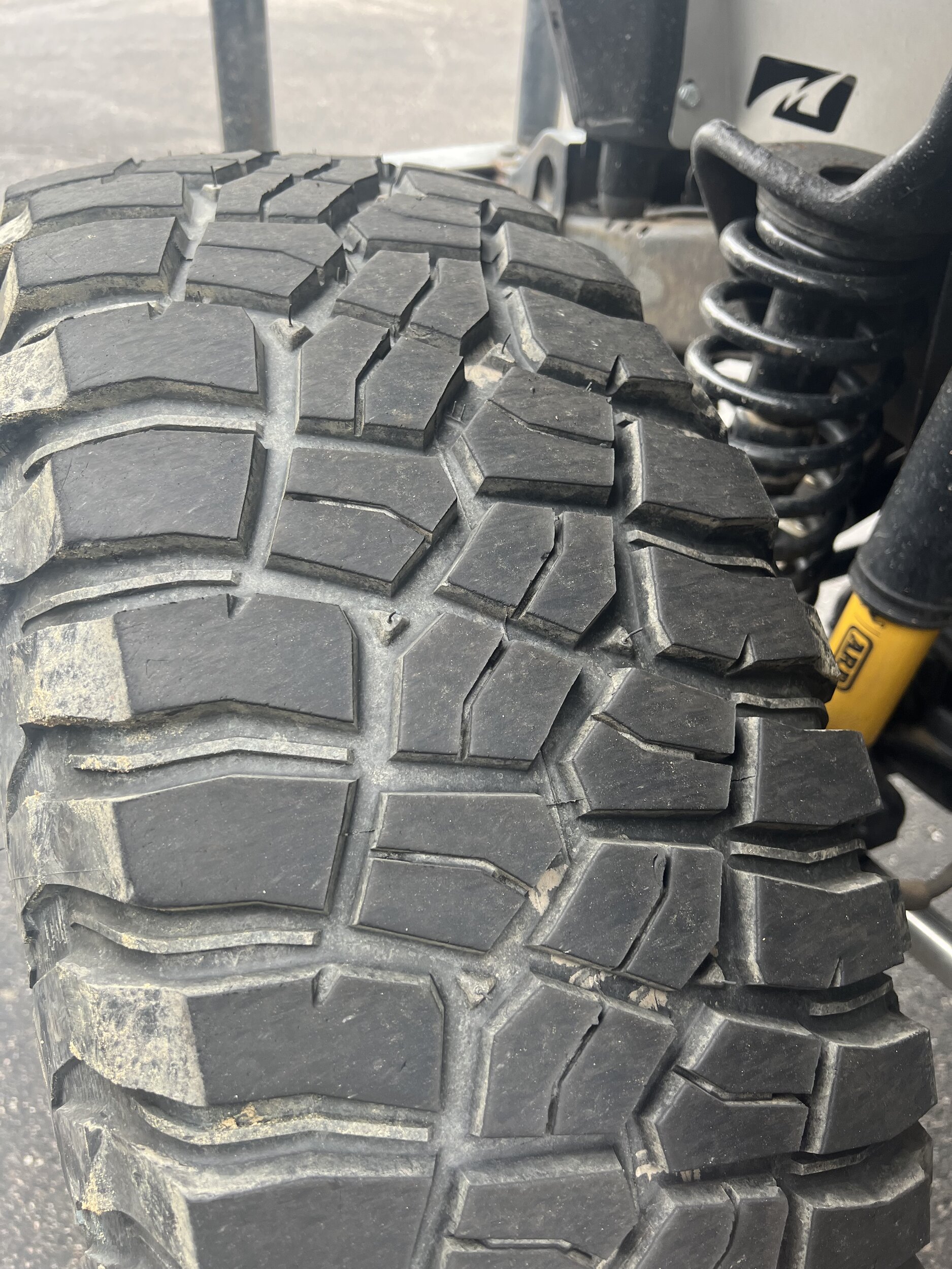

Front:

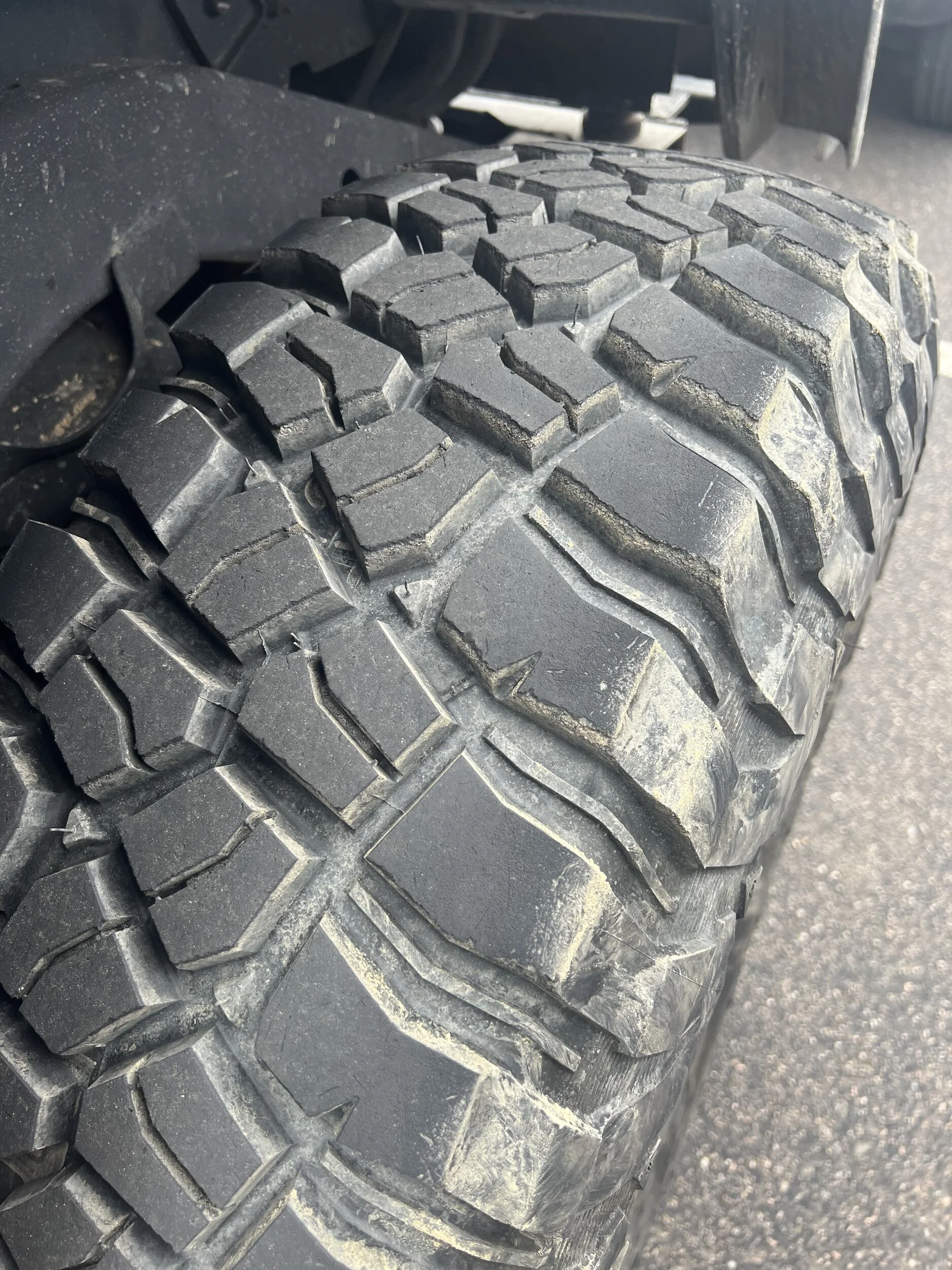

You can see the jagged edge of the outer tread blocks on the second photo but they are also that way on the inner and center tread blocks.
Front looks like lots of wear for 500 miles ??
Okay I am not losing my mind then.
Yeah 500 miles and that is probably over estimating a bit. 4 day trips and 1 camping trip and it looks like only the rear tires have the jagged edge.
I want to make sure it's not edge wear so I want to get it to an alignment shop if anyone has recommendations in the Denver area. I like to do work myself, but I want a solid baseline to start with.
