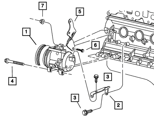

Does anyone have any idea what size bolt connects the AC compressor bracket to the block on a 2000 4.0? Mine is missing. Usually I can find bolt sizes in the parts catalogs. I don't see this one at all in the 2000 catalog. I see it in the 2006 catalog, and the drawing looks like what is on my 2000, but it just gives me a part number (00154889AA) not a size. It's number 3:

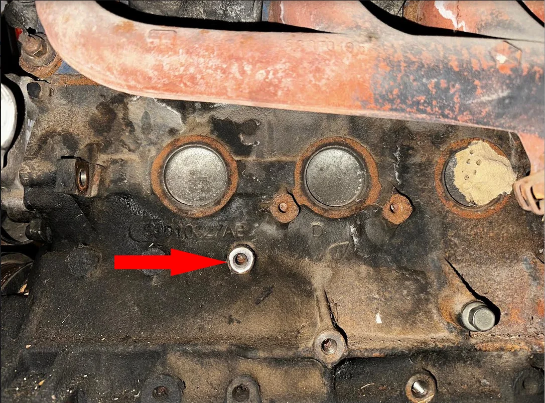

Just for fun here is a pic of my spare block, and yes that's an abandoned wasps nest:
For future reference 3/8 16.
I ordered a thread checker kit from Amazon, just got here this morning. Not sure on the length, I will just grab a few different lengths at ace.
