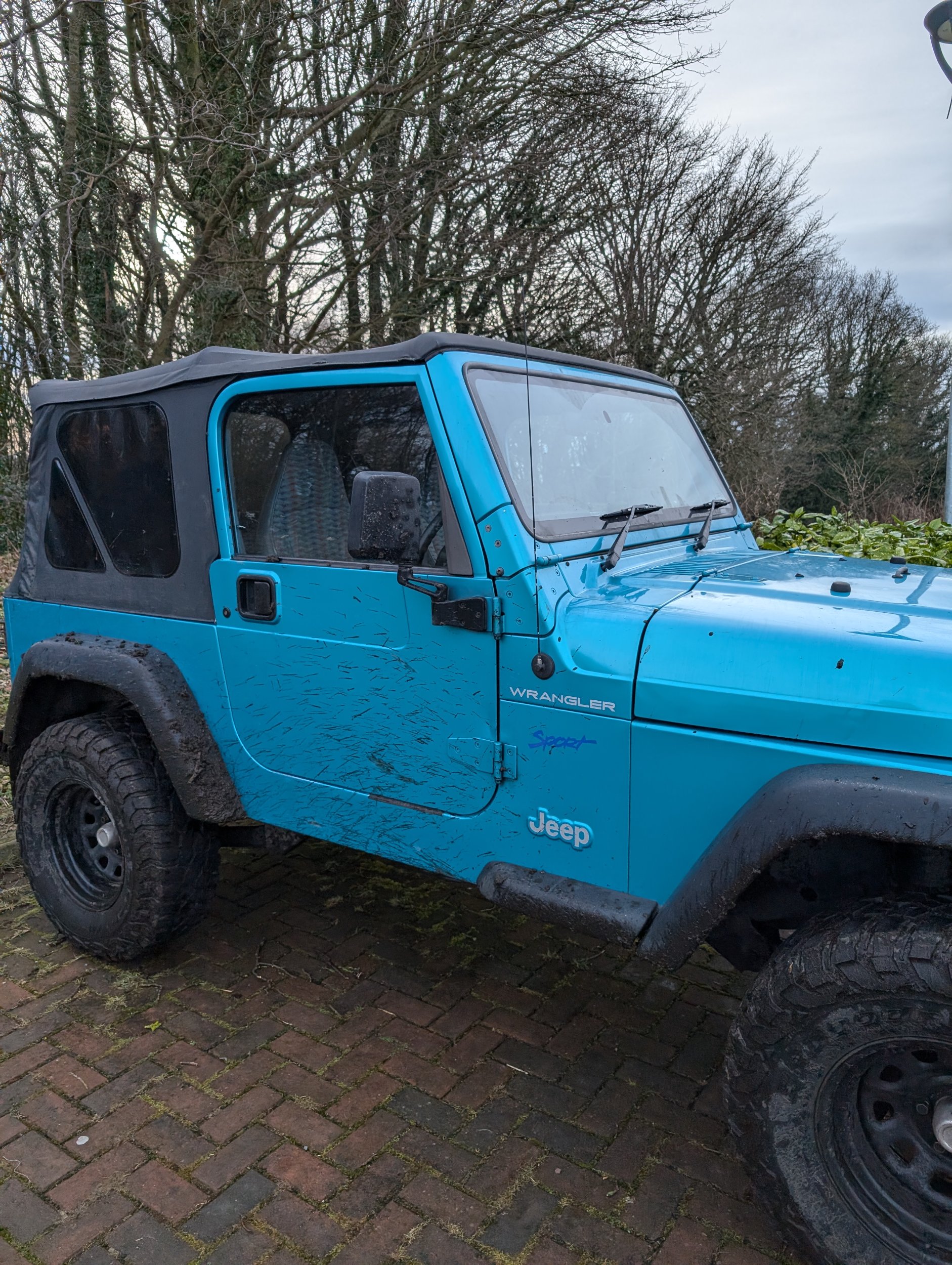

Hello people, I need help, mostly aimed at UK people. I have absolutely no experience in the whole ECU part of Jeeps. Don't understand it in the slightest. I currently have a little issue with my jeep. The key fob to my imbozalizer (may and Schofield ) likes to be hit and miss. Just the other day it left me stranded dead for about 12 hours. When I go to press the unlock button on the fob, nothing happens. The imbozalizer doesn't disengage. It's not a big deal but I really don't vibe with being stuck untill 3am again. It's not the battery inside the fob, the wiring is fine inside the dash. Would anyone happen to know what is causing the fob not being able to 'speak' to the imbozalizer itself. I want to say that is a signal issue but I really don't know. I've looked at other issues on here regarding it and It seems that the best way to go about this is to just send off my ECU and get the imbozalizer fully deleted. I'm wanting to do this and just install my own kill switch for the engine itself. Would anyone know how to resolve the issue, or even know what is causing it with the imbozalizer or know of any good UK based companies that specialise in ECU imbozalizer deletes. Sadly auto electricians near me won't even look at it as it's too much of a ball ache.
