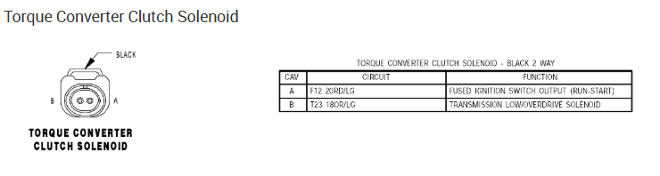

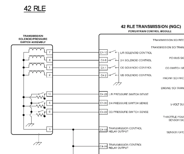

Circuit dump for now:
TCCS is a bad diagram per hear, removed.
TCC Solenoid seems to be missing from the trans diagram, although it seems it may be a function of the Low/Reverse solenoid circuit:
TORQUE CONVERTER CLUTCH (TCC)
Fig. 248 Torque Converter Clutch (TCC)
Open In New Tab Zoom/Printimage
The TCC (Fig. 248) was installed to improve the efficiency of the torque converter that is lost to the slippage of the fluid coupling. Although the fluid coupling provides smooth, shock-free power transfer, it is natural for all fluid couplings to slip. If the impeller (3) and turbine (5) were mechanically locked together, a zero slippage condition could be obtained. A hydraulic piston (6) with friction material (7) was added to the turbine assembly (5) to provide this mechanical lock-up.
In order to reduce heat build-up in the transmission and buffer the powertrain against torsional vibrations, the TCM can duty cycle the L/R-CC Solenoid to achieve a smooth application of the torque converter clutch. This function, referred to as Electronically Modulated Converter Clutch (EMCC) can occur at various times depending on the following variables:
- Shift lever position
- Current gear range
- Transmission fluid temperature
- Engine coolant temperature
- Input speed
- Throttle angle
- Engine speed
For clarity, you pulled this connector image off an FSM for a 32RH-equipped TJ, not a 42RLE-equipped one?
That's from Alldata, good to know it's a red herring. Makes sense since the circuit numbering doesn't match up.
