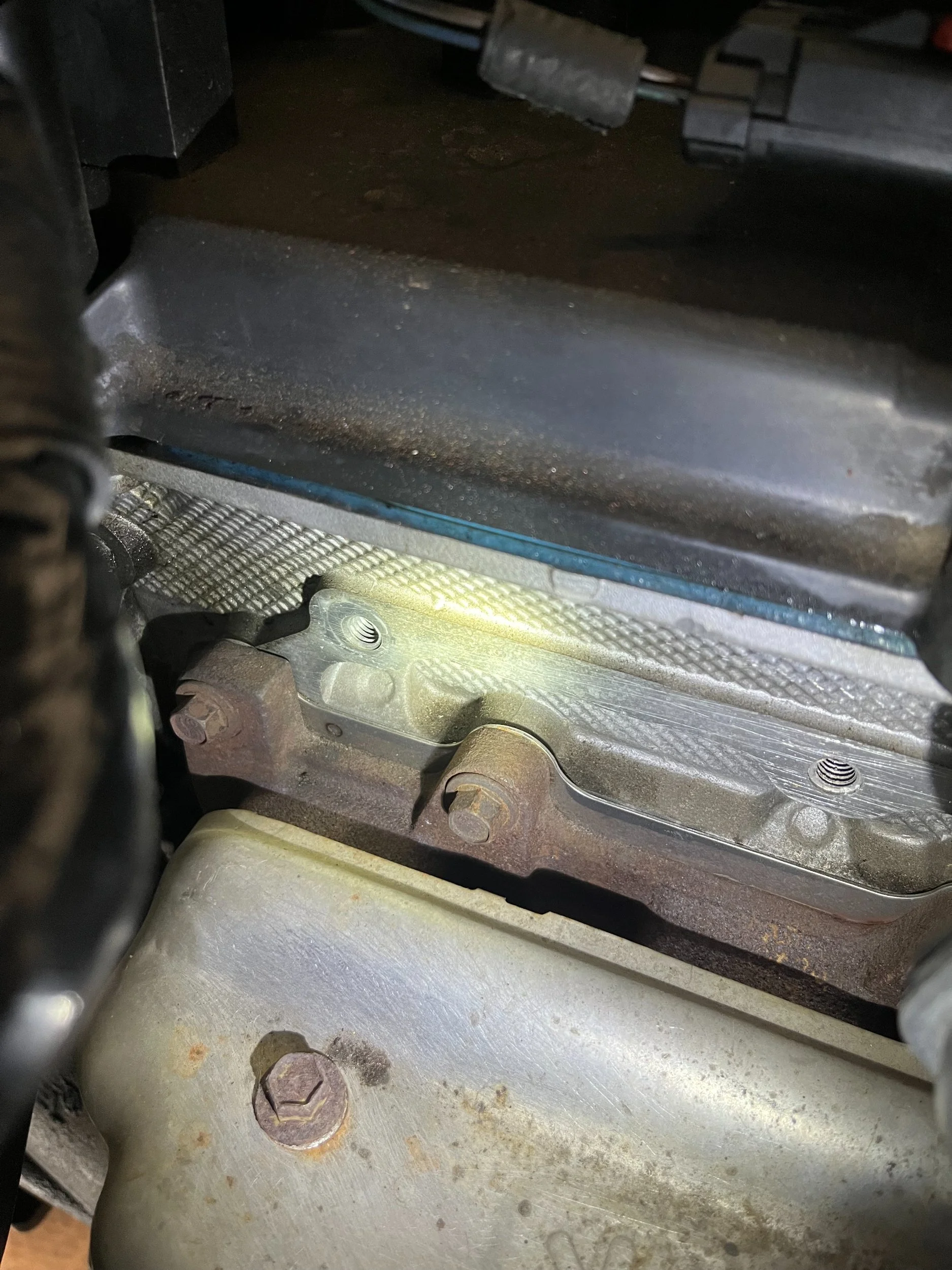

Hi, wondering if anyone with the 2.4l could let me know if a ground is supposed to be in the rear right side of the engine block?
The hole on the left has a mark around it like if something was there before.
Thanks a lot
