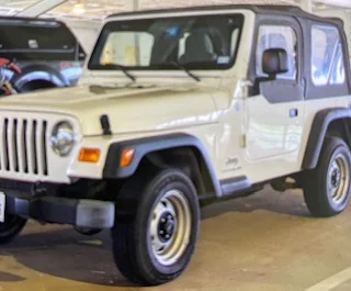

Lets see a pic of your Jeep - I like basic Jeeps and especially with the steel wheels and little tires. You hardly see any of them like that anymore.

As requested, please see below. Pic was taken by the prior/original owner and may have been before they added the 2" Rock Krawler lift.
