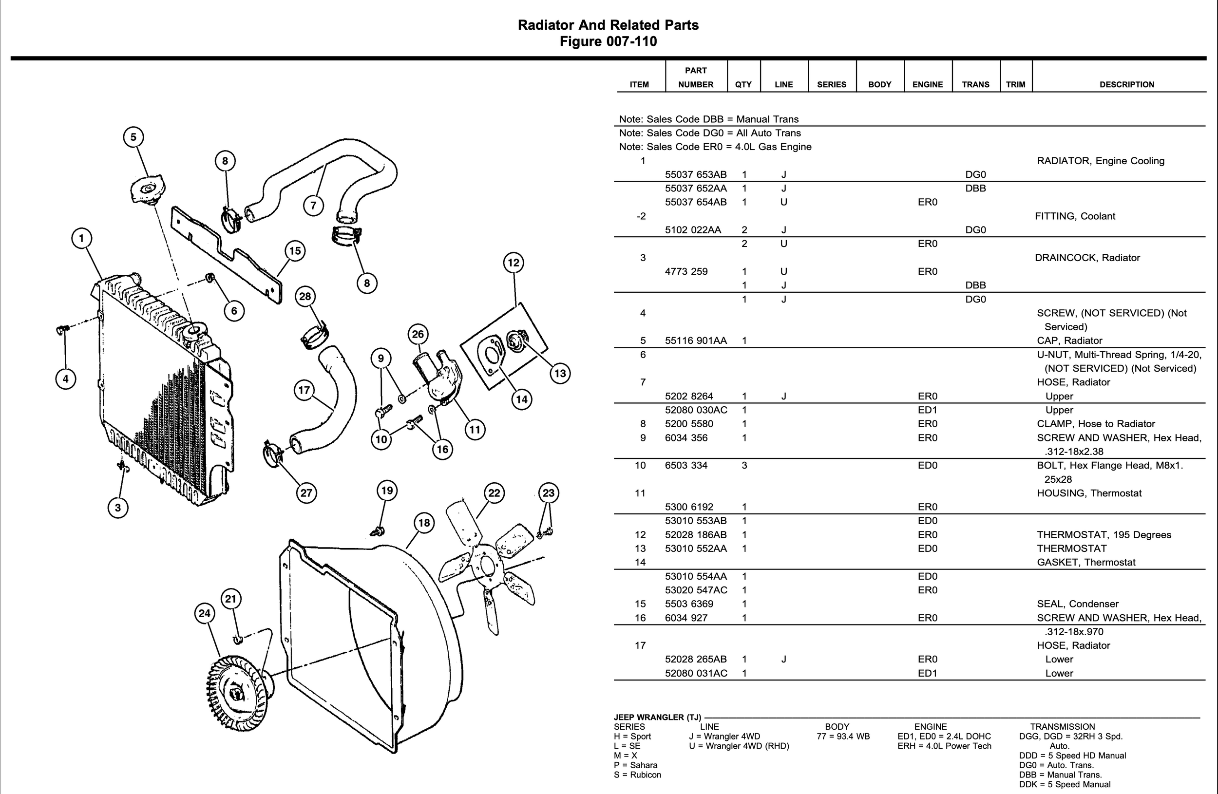

My 2004 TJ 4.0 straight 6 engine's radiator is blown open at the top (Plastic) What is the correct part number for this radiator? Just get it at AutoZone? Also, Will a 4 row fit or should I even use a 4 row? Is an aluminum radiator better? Live in Redlands Ca
You didn't mention whether you have an AT or MT, but here are the OEM PNs (55037 652AA, 653AB or 654AB) for your year TJ 4.0L.
